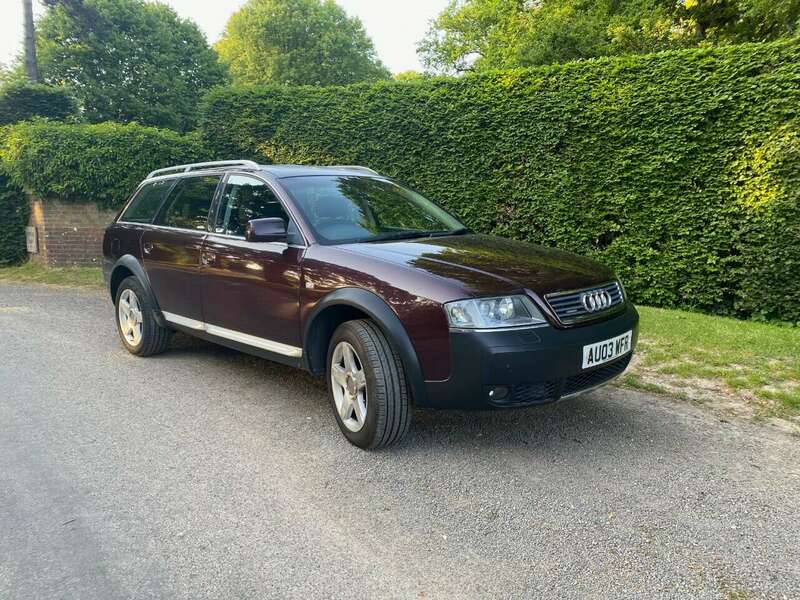

Audi Allroad - the Dad Wagon.

Looking handsome today.

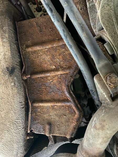

Bit of an update, the suspension pump rebuild kit turned up so I had a go at fitting it.
Where we're going we don't need a jack
(there are a couple of axle stands under it too before anyone asks)
The MOT person wasn't joking about a rusty subframe, it is like the Bismarck under here, changing these bushes is going to be fun* if i ever want to.
Here is the valve block looking a bit exposed and worse for wear. Not sure why it doesn't get a cover but there you go, should be easy to change.
The pump lives under this cover.
Someone has been here before as it is a bit butchered and the fittings are rounded off. A bit of minor abuse and here is the pump.
From the cable ties and look of the pump I suspect it has been replaced at some point but not for a while. Just 3 10mm bolts and a few connectors and it is off.
On the bench/kitchen table
Here it is all opened up. The repair kit includes a new piston ring, gasket, new bolts and a tap to chase the threads. It comes apart easily and I gave it a good old clean.
And here with the new piston ring fitted.
By this point it was dark so no more pictures but installation is the reverse of removal etc.
Took me about 2.5 hours but would have been much faster with a lift and some actual skills.
Once fitted it did make a difference, the pump was able to lift the car much faster and it doesn't run as often, presumably as it can fill the tank to a higher pressure. I was hoping that it would make the system run at a higher pressure thus somehow fixing the intermittent overnight drop but the next morning it was business as usual and dropping at the front.
Total cost was £25 for the kit and it was an easy job so I'm glad it got done. Next up, soapy water on the front bags and valve block and go from there.
