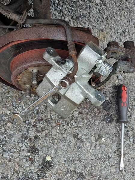

Figured it was about time I got round to fitting the new rear calipers to the ungrateful silver lump.
Disassembly of the old was easy, well apart from liberating the old caliper of its counterweight thingy - that took some swearing and percussive persuasion. Eventually it yielded to the application of lump hammer and we got it swapped across.
Putting the new one on was a piece of piss, apart from all the difficult bits... Namely getting the new pads into the carrier whatsit. More swearing, more doubting my life choices but they eventually went in.
Yes, that flexi isn't looking too clever but it looks only slightly better in person. Shiny new disc was put on too before bleeding the system (not my knuckles for a change) and putting the spinny rubber part back on.
Well all in its gone alright seeing as the work has been done by this idiot, successfully removed one source of squeaking when driving and she seems to roll a bit more freely.

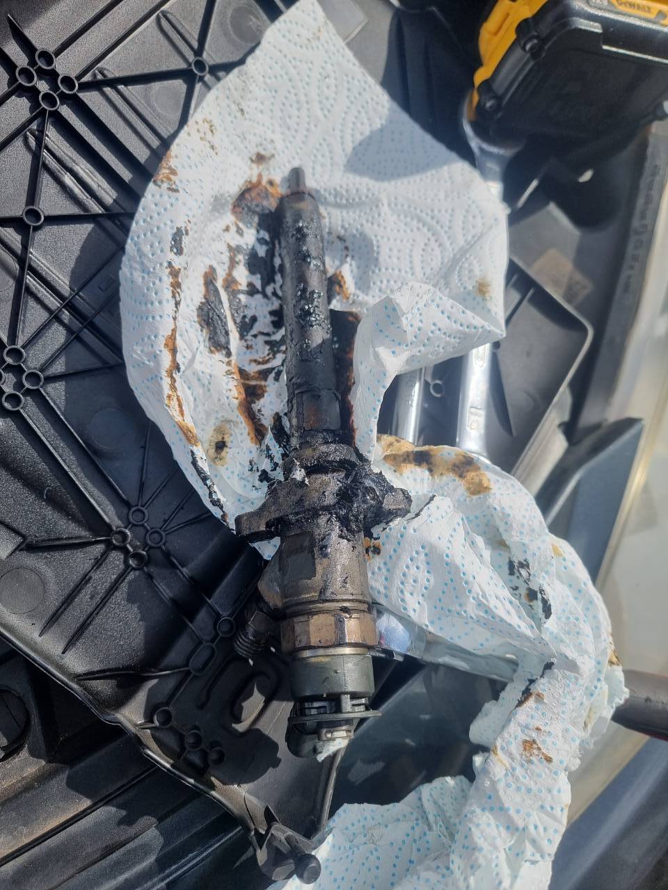

Well, dad's bargain C3 has issues...
30,000 miles and my foot was practically floating over the pedal before the clutch bit. Engine doesn't seem too bad, just feels gutless although the shagged clutch may not be helping matters there. Brakes are squeeeeeeeaky, I sincerely hope it's just the fronts as the rears are drums.
  • 5 months later...
The C3 died without ceremony whilst hauling my fat arse along the M65, a judder from the engine shortly followed by a total loss of power had me gently coasting onto the hard shoulder.

Oil being dumped into the coolant and a loss of compression sounds like a pretty serious head gasket failure to me.
The TU engines are great when they work, but they're extremely fragile, and sensitive to overheating.
Realistically it would want another engine. I've never had much luck trying to do a head gasket on a PSA engine that has badly overheated. They always tend to fail again a few months/years down the line
7 hours ago, bigfella2 said:
What happened to the c3 in the end? Didn't you fancy fixing the head gasket.
It got scrapped unfortunately. I'm quite limited in what jobs I can do as my 'workshop' is the car park behind my flat, that combined with work commitments really narrowed down my options.

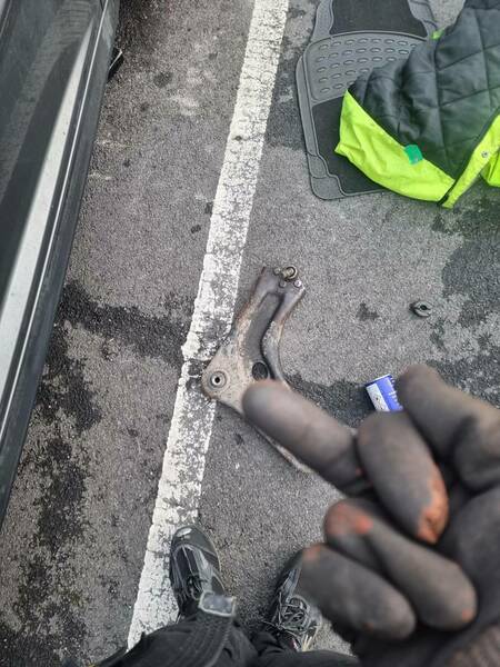

As it turns out, the merdemobile wasn't just suffering from shaggered droplinks. Wheel off again and poking and prying revealed the most likely* culprit of my latest auditory discomfort. A ball joint that wasn't jointing very well any more.
Of course Peugeot, in their infinite wisdom, had decided to rivet the ball joint to the control arm. Googlage revealed that the best course of action was to simply replace the entire assembly, I was inclined to prefer this anyway as less hassle...
Fast forward to Saturday, tools out and it's not raining so time to get cracking.
Sensibly I'd penetrating oil'd all the bolts and the pinch bolt holding the ball joint to the hub came out no issues.
The fun began in earnest. Would the joint come away from the hub? Hah. Yea nah. A solid hour of fun and games trying to dislodge 14 years of grime and rust and eventually the bastid thing popped out.
Subframe bolts were surprisingly un-French and popped out with minimal protest, apart from having to wrestle the driveshaft as far forward and up a bit to get one of the bolts out.
Good riddance and that ball joint was properly cooked, so was I to be honest!
New arm in, subframe bolts point blank refused to go home. Sod this, I was cooked so went inside to warm up and get meowed at for the rest of the evening.
This morning I go back out, spent three miserable hours getting drizzled on and only getting one of the two bolts back in. At this point, the car also decided to steal my torx bit and adapter. I'm not getting that back, am I?
In an act of sheer desperation, monkey brain engaged and I hit the top of the bolt with a lump hammer. Fuck me it started moving! Few more thwacks and it was home.
All that stress sorted with a few taps of a sodding hammer. A short test drive later and I can happily report the clonk is banished.

Against the better advice of my feline assistant, I decided to crack on with more tinkering on the ever-ungreatful Peugeot. Namely refreshing the washer and seals on number 3/number 2 (depending on however Peugeot decided to number them this week) injector.
Getting to the injectors was straightforward enough, unbolt the plastic loom holder, disconnect connectors and carefully* wedge it out of the way. Likewise, removing the leak-off pipe watsits only required removing the clip holding each in place and levering off its injector, again stuffing it aside. High pressure lines came off easy too. Am I getting my hopes up? Yes.
Slight battle getting the rocker cover out, as one of the 8mm bolts was helpfully hidden behind the pipe going from the intercooler to the turbo. Though loosening it's retaining clip gave me enough space to get at the aforementioned bolt. Twist, wriggle, curse the bastard who designed this engine and the rocker cover came out.
Oh. Swear words.
Moving swiftly on (to preserve my sanity if anything...)
Removing the injector involved liberal application of carb cleaner and scraping around the clamp, the escaping combustion gases had solidified back into a hellish combination of tar and very solid carbon. Unsurprisingly effective at holding the injector in place but it yielded.
Lovely.
That took a significant amount of time to clean all whilst paranoidly avoiding the tip of the damn thing.
Cleaned up the bore with an amazon spesh cleaning kit and replaced the seal that sits at the top, with only a slight faff getting the blighted little rubber bastard to seat properly.
Not perfect by any stretch but it do.
Put new spacer thing and copper washer on the comprehensively refurbished* injector before chucking it back in its home, reattaching everything and putting off turning the damn thing back on.
A smidgen of hesitation and puckering of the sphincter, then I turned the key.
Chuff successfully banished and I don't have to keep the air con in recirc anymore!
