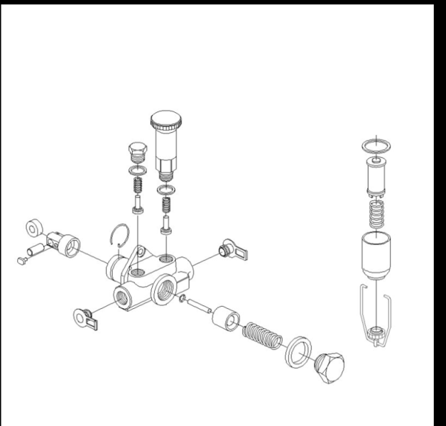

And I can't find a direct new replacement, the ones I find are all slightly different. But I can find overhaul kits, but I'm struggling to understand how this pump works as the ones I'm used to have a diaphragm, which this one doesn't. The picture below is of a similar pump but with water seperator.
1534978701_Screenshot2022-08-1420_17_25.thumb.png.e26fdad8d6ccaf446f0e25c64b809358.png
And the overhaul kits I can easily get hold of are this below. Which I struggle to believe is enough to completely overhaul this pump?
1568047874_Screenshot2022-08-1420_22_27.thumb.png.5985483c26eab6e6a5108c9e973250a6.png
Does anyone have any ideas? I would prefer to keep the original pump or replace it with an identical new one.

https://www.ebay.co.uk/itm/Lift-pump-repair-kit-for-Bosch-FP-K22-pumps/324478216496
This has loads more parts than the one you showed...
Thanks. It is a possibility, the only thing is that it is for a slightly different pump, so I wonder if the parts will fit. Something like the gasket against the engine is clearly different, my pump has 2 bolts, this is for 3 bolts.

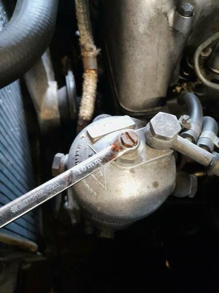

Started by loosening what I think is the bleed screw on the diesel filter. And when I did, I had my ear close and could clearly hear a lot of air coming out.
Then I took off the hose from the fuel pipe to the lift pump and then the return hose from the filter to the pipe and both were completely empty without diesel so things are not as they should be. And the hose to the lift pump is very bad.

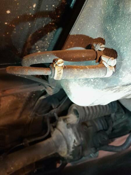

The next thing was to check the hoses at the fuel tank and they don't look too bad, but I change them anyway to be sure.
But to change those involved emptying the tank.
When the tank was empty and I had to change the hoses, I blew through the fuel pipes which I'm glad I did as this came out of the main pipe, the return wasn't that bad.

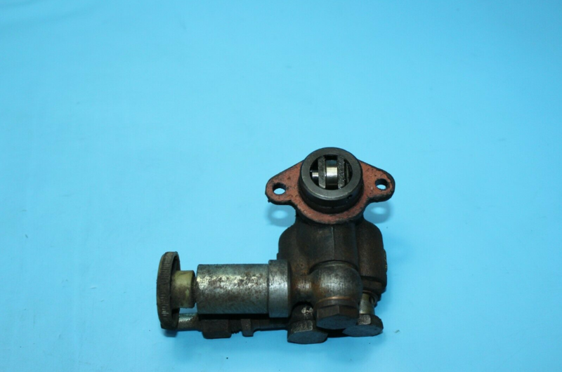

After a lot of research, I found out that Unimog used a version of this engine until the 80s. And the lift pump they used had 2 bolt holes like mine has.
This pump is  Bosch Fp / K 22 M3/8  and it has some differences but I think it can be used as I can just change the fittings, I hope.
658483552_Screenshot2022-08-1521_01_59.thumb.png.c8176134fd031480ff4e5d15812bff77.png
So after a bit of searching I found a diesel specialist in Germany who sells these new at a not too bad price so I bought one.
383409292_Screenshot2022-08-1521_05_25.thumb.png.7c9af15c37d0d124ad8aba30e64e513a.png
So now I just have to hope that this is the right pump as there are few pictures and that I can get it working on my car.
