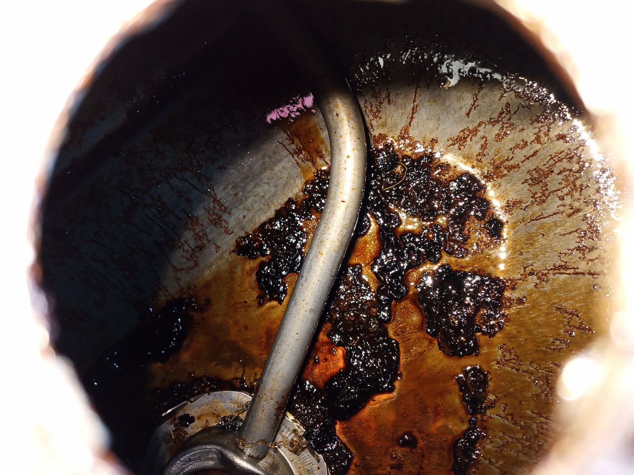

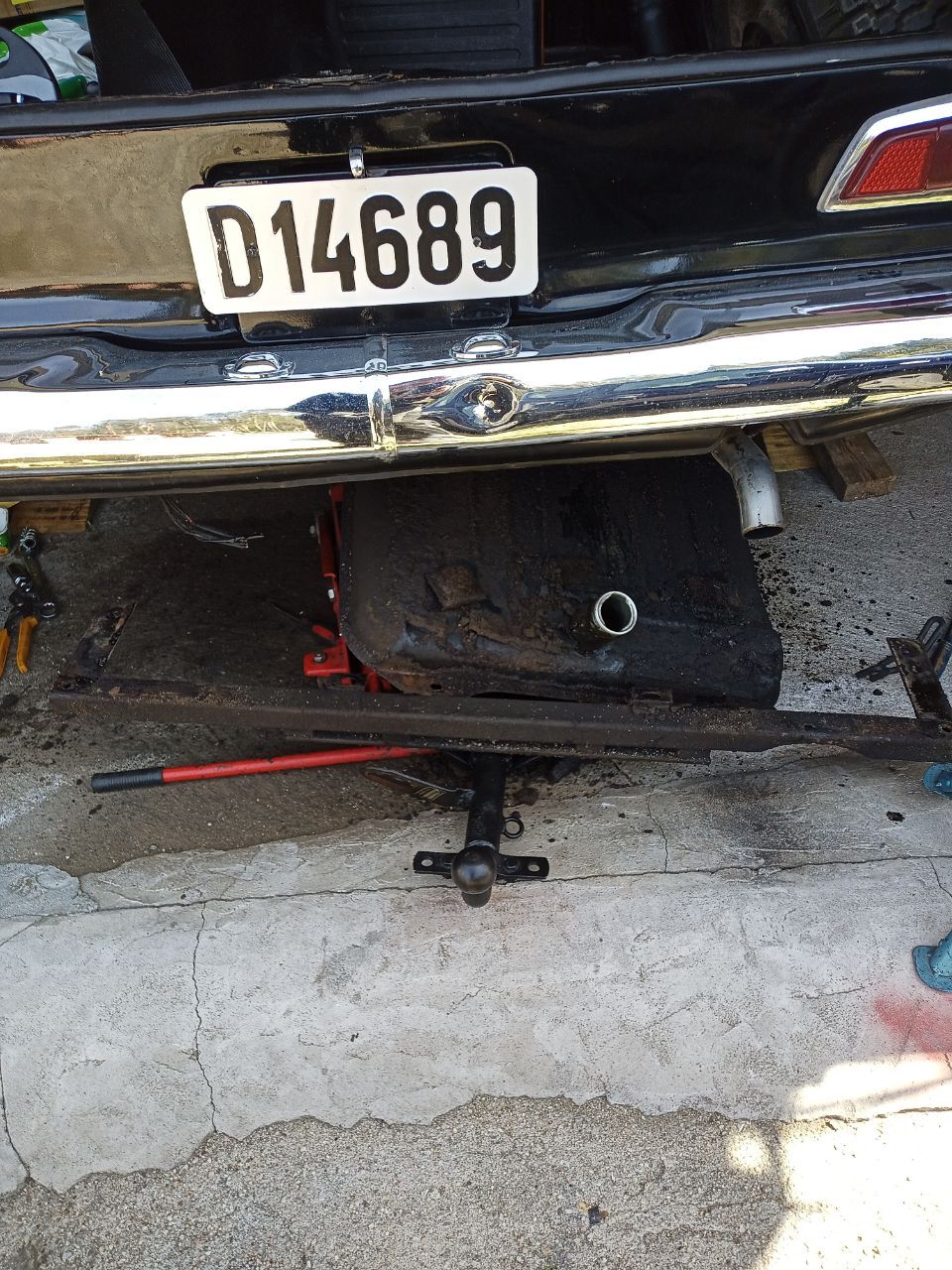

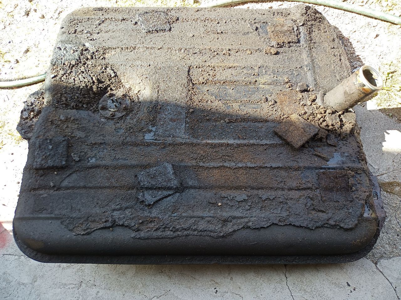

Grinding down the weld on the trailer hitch that caused it not to be taken down went faster than expected, so the fuel tank is now out. And for a car that spent its first 20 years on unpaved roads, there was as much mud and crap on top of the fuel tank as expected.
Inside of the fuel tank.

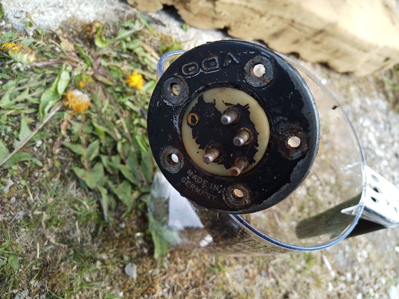

And the fuel level sender is completely different from the one everyone sells to these cars. And have checked the numbers on it and can't find anything. but it is stamped 3 63 wich i guess is march 1963 and this car was registered in May 1963 so this could be the original to the car?

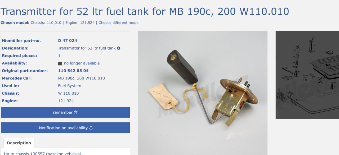

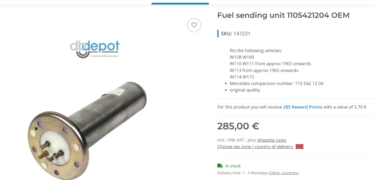

After some research, the fuel tank sender I have is only for the 52 liter tank and all the other larger tanks have the other fuel tank sender.

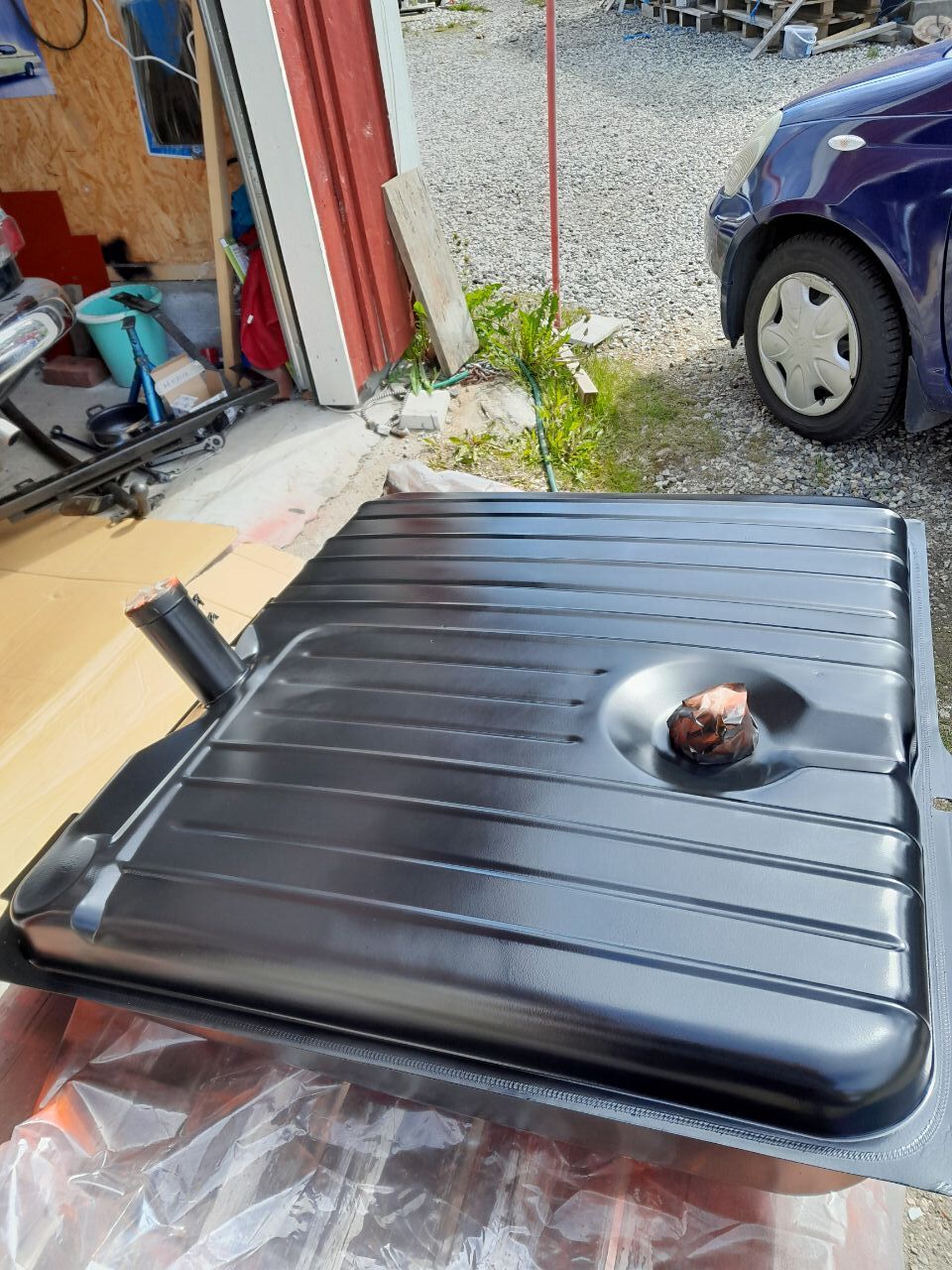

New fuel tank arrived today and I am very happy, It's the fuel tank from Danish JP Group that I was hoping for and it seems well made. It also came with a new tank filter and seems to fit.
But it is massive, 82 liters, 30 liters larger than what the car had.
The only thing is, as expected, that the paint is not the best, so I managed to prime and paint one side today and will do the other side tomorrow.
And I need to have something to cushion between the fuel tank and the car and have been thinking about using Gorilla tape in thick strips. It does not attract moisture and is durable.
Are there any reasons why I shouldn't use it? And in that case, what else?

No reason you should not use it or some strips of closed cell foam. The important bit there is closed cell as that will not retain moisture

would sound deadening work - the ones with the foil on the outside???
or some offcuts of rubber floor matting (inside or outside) kitchen floor or similar?
I have taped the high points on the top of the fueltank and realized I had a sheet of rubber cut it up into some strips and will use that too.
