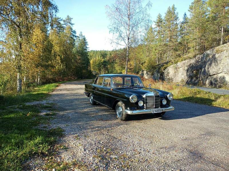

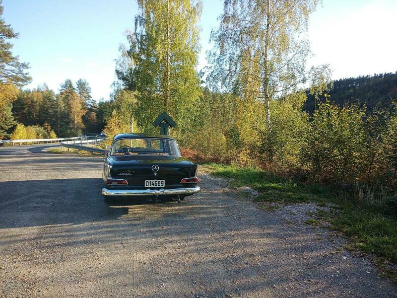

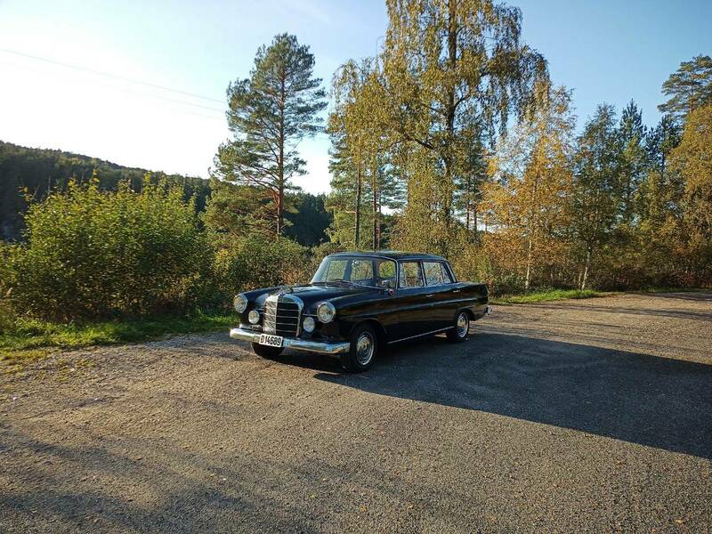

1963 Mercedes Benz 190DC Fintail. In winter storage.
Today was the last drive of 2023 and this has now gone into winter storage. 1278 kilometers have been covered this season, which is not a lot, but the car has also been off the road for over 2 months in total due to work on it and MOT so not too bad with that in mind.
So now I just have to wait 6 months until I can drive it again.
IMG_20231005_165334_089.thumb.jpg.95d72ffbc8ad43d5fc712389e85068e4.jpgIMG_20231005_165354_539.thumb.jpg.c98b23a97f70257dafeba51b343284ca.jpg

He's a handsome bugger isn't he.
Excellent stuff. That mileage is pretty good for an elderly hobby car.
Dunno. We still haven't seen a picture of him yet 😄
(I'm here all week)
Picture of me is the last thing you want to see

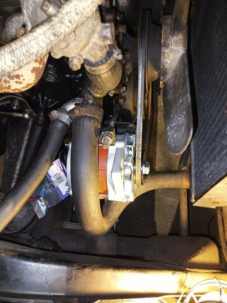

Had a look at the alternator situation now.
And for several reasons, I want to use a new universal alternator, the alternator that was on the car was also not original and was badly fitted.
The new one fits except for the tensioner, which is also not original.
The biggest problem with the new alternator is that it came without a wiring diagram but fortunately it only needs 3 wires, plus, charging lamp and ground.  And the picture below is of the back with the contacts. B+ is pretty certain is plus, but I'm not sure what the contact above and w are.
But fortunately these are very common alternators here in Scandinavia, so the Zetor 4712 also has one installed and it is connected as in the picture below. But it is missing ground?
So here B+ is connected to plus as expected, but the other contact must then be the charging lamp? This one charges so this works.
So what do some of you who know electricity think, B+ I feel is pretty safe but then there is the charging lamp and earth. Should I connect this up like on the tractor and just connect the ground to the alternator housing?

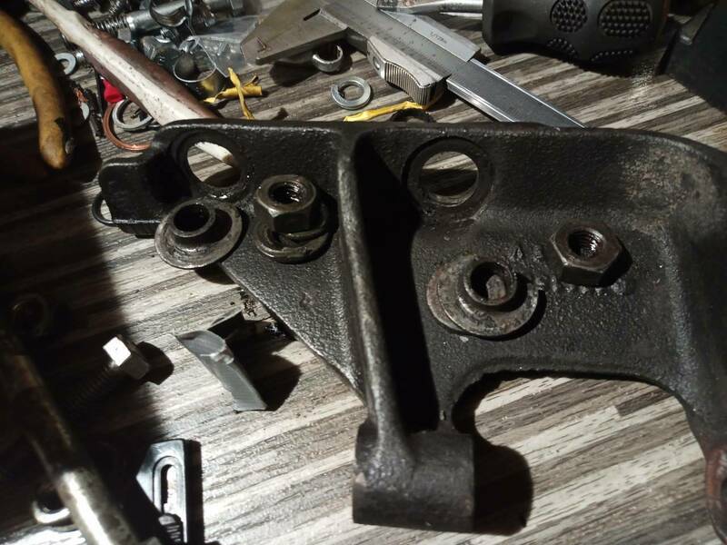

I have also removed the alternator mount and need to find new bushings for this.

Yes, I think you will find that the other large contact is the charging lamp, so  connect it the same as the tractor, and ground to the alternator housing.
Thanks. At the start of working on cars, I connected an alternator incorrectly and would prefer not do that again.

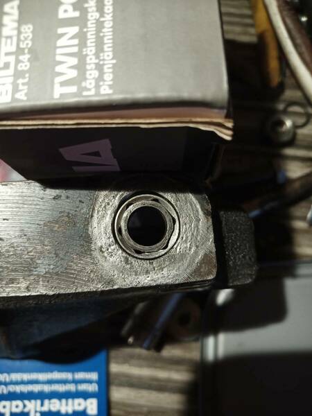

I'm having some trouble finding  new bushings for the alternator mount. The many lists for these do not fit and I am struggling to find something that has the right size. The liner/bushing must be between the disc marked in blue and the hole marked in red. And I measured that I need something with 17mm on the outside and 13mm hole on the inside, I didn't get the thickness measured but it is about 5mm. And this is hard to find I also want to find something that will last a long time.
So the hunt is on to find something and if anyone has any tips it would be appreciated as this is the biggest problem I have now.

If you can weld then tacking several different diameter washers together my help you get out of a spot until you can find something more suitable.
This is an idea and I have thought of something similar.
And I wonder if that bushing for the alternator mount is really necessary or if I could just use a metal bushing?
I did not realise they were made of rubber. I would cut up an old inner tube and wrap this around the welded washers. That may help if  you have some doubts on supports made only from metal.
I have also been wondering if I can make new bushings out of one of the old implement tires that I have somewhere. As I am guessing the rubber they are made of can withstand a bit.

I have had several attempts to make new bushings for the alternator mount  and failed so the plan is that at the end of January or in February to find someone with a lathe to make me some in metal, that will solve this problem forever.

I've missed a few updates, but to answer your query about the W terminal on the alternator - this is an output to drive a rev counter when fitted to a diesel engine.

I had one of those rare cases today where my brain bothered to function properly so I came up with a plan for to make the bushings for the alternator mount.
I took a 13mm socket and made 2 new bushings out of it. And it worked! Now the alternator mout is fixed properly. Next challenge is the alternator the new one I have bought is not working as well as I thought so have another one I want to try instead and hoping it will fit better.
I'm struggling a bit to find an alternator that will fit but have found one that I think works but there are some challenges. The mounting point on this is 58mm, the alternator mount I have is 56mm, but I should easily be able to cut off 2mm of the alternator to make it fit.
The second and major problem is wiring. This has 3 wires, not sure if they all have to be connected, but IG must be ignition, but then there are L and S, I'm going to guess, L is light and S is signal? One is for a charging lamp, but I'm not sure which one but i guess L?.
I'm pretty sure that B+ is the outlet for the charging. And power when ignition is on I should be able to find in all the cut wires nearby I hope.
And converting this back to original is no longer easy as all the wires to it have been cut and I think this originally had a generator, which I don't want.
So does anyone have any advice or could help with this?
Found this on a quick Google of "alternator wiring diagrams".  It looks like you may need a relay for the charge warning light but I think it's safe to assume that the markings on the terminals are the same as yours.
