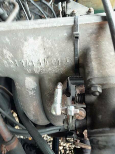

Got a bit done on this today too. Got oil topped up on the main fuel pump and as I suspected, it lacked oil. Then I looked at the large oil leak at the front of the engine. And this one is weird, oil runs out of this hole while the engine is running.
And after cleaning it looks like this. The round part does not appear to be part of the timing cover but the hole in it has m6 threads. So could it be that there has been a bolt here that may have fallen out?
I've tried to screw in a bolt here but only get it in about 5mm and I'm afraid to screw in something that might be too long as the timing chain lives there so I'm afraid a bolt will hit something. But I have cut a bolt to a short length that I can screw all the way in so should just fit it and see what happens?
Was it for some sort of sensor, oil temperature possibly or even a pressure relief valve?
I'd fit a short bolt with an O ring in it for the time being, then start gooogggleee ing.
I do not know. I am struggling to find information on this. But I have bought a downloadable manual for this engine from ebay but the seller is slow to send it.
And I've put in a short bolt now, didn't think of an oring so used a copper washer instead along with Loctite on the threads. And is strange as I could never fully tighten the bolt. So this scares me a bit so I would have liked to have some information about what should be in that hole.

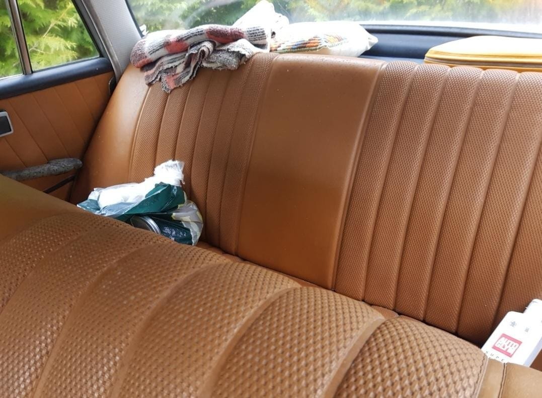

I cleaned the seats and interior parts that are in the garage and inside the car today and it was time for a cleaning. These washcloths were clean before I started.
And the seats got a little cleaner.

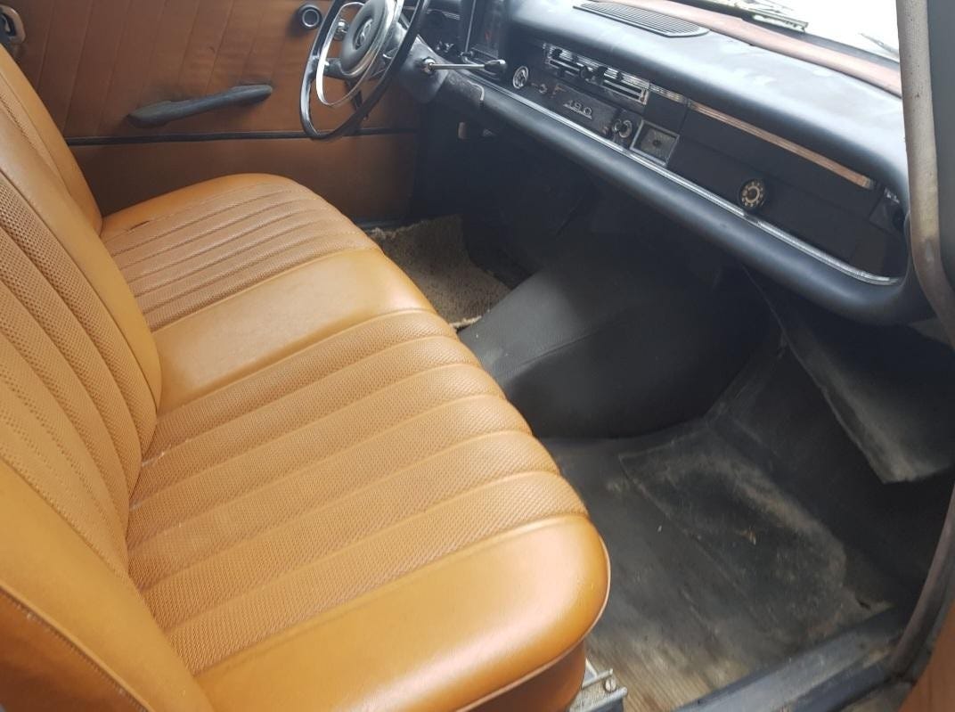

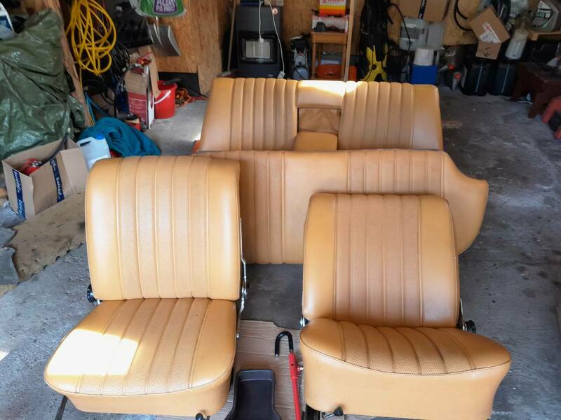

This car is registered for 6 people and since it has a column gear change, I am convinced that it had a bench seat in the front when it was new. And it would be logical since this started life as a taxi, you would want to have space to as many passengers as possible.
But where do the seats come from? I think they come from a W111 the more expensive and 6 cyl petrol version of these. And there is one of these for sale here in Norway now and it has exactly the same seats. Pictures of this below.

Below are my seats.
I also think that the rims and hubcaps on mine come from a W111 as mine was originally supposed to have 13 inch wheels but now has 14 inch. Below are the wheels of the W111 for sale.
Galleribilde
And these are mine which are identical except that they are not painted in the middle.
But my spare wheel is the original wheel for this, which is 13 inches and has an attachment ring for a small hubcap in the middle.
So what I think has happened is that after years as a taxi the original seats for this were worn out and they were replaced with seats and wheels from a scrapped W111.
But what did the original seats for this one look like? I am so lucky that a other W110 with most likely the same interior as mine had is for sale in Norway now and here are pictures of it.

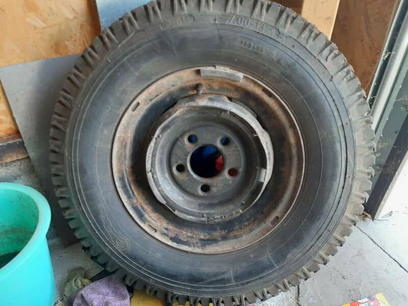

And I think I should mention the spare wheel as this has the oldest tire I have ever had on a car.
And I don't know age but would guess at least 50 years old? And it is a studded Sahlins meteor.
I wouldn't dare to drive on it or put it on the car so will have to buy a new tire for the spare wheel but will keep this tyre.
Generally means the thread is "fucked", on either the bolt or the bit you're screwing it into.
Yes I suspected that. I've got the manual for this engine now so I'll see if I can figure something out about that hole but it's 720 pages so it might take a while.
