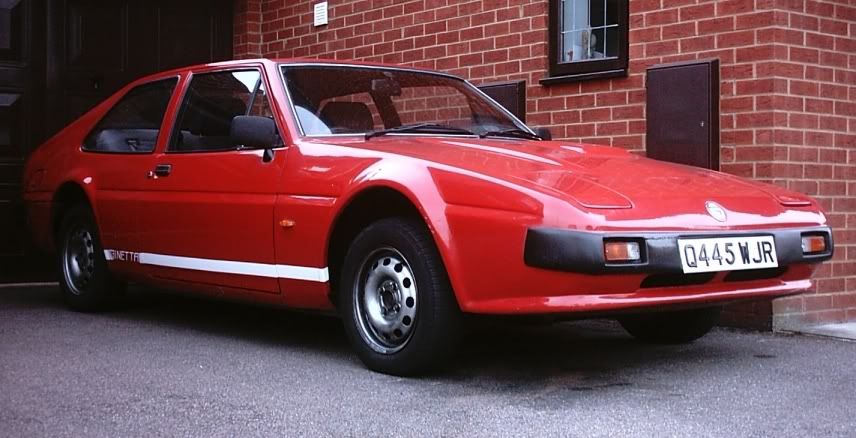

Part of this is because of the ride height, which was this morning's job. I got some rear springs which drop the Mk5 Cortina by 2 inches, and I believe the Mk5 is lower than the Mk3 and 4 anyway. The result is quite good
Posted Image
Posted Image
Still needs spacers though :oops:

I dunno, now the Wheel Silver has been broken out and the ride height is a bit more sensible, it doesn't look half bad on the steelies. I'd like to see it with some spacers on, reckon it'd look great then. Saying that though, I think it would really suit some Celica alloys like the ones Aled is trying to get for his one.
I think it would need huuuuge spacers to push those wheels out enough. I think an inch or two bigger diameter and more width are definitely neededLooking good though!
I think it would suit 7-spoke Capri wheels and 205/60HR13s - and the offset shouldn't be too bad either.

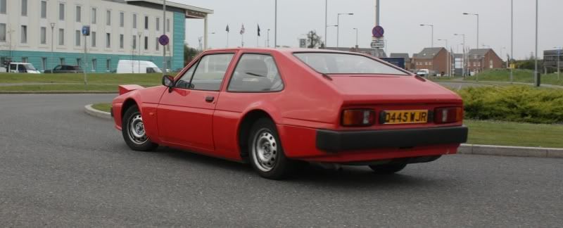

I'm getting the hang of it with the lowered suspension, and the narrow tyres make it pleasantly easy to punt around without going fast
Lesson 1: The aggressive corner entry. Note the understeer.
Posted Image
Lesson 2: Then apply some power and wind off some lock, you can see the rear tyre being peeled off the rim, thank goodness they don't give any grip
Posted Image
Lesson 3: Easy does it, steady now, steady.... oh, it's gone too far
Posted Image
Lesson 4: That's a bit better
Posted Image
Lesson 5: And pick your exit
Posted Image
