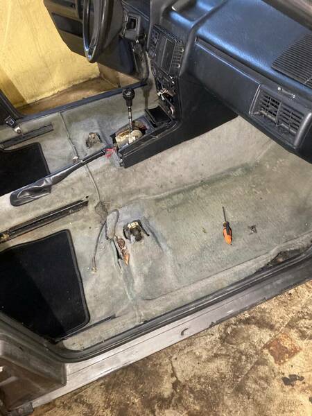

Changed floor mats on the Audi 100 Diesel today. A bit fiddly around the pedals but otherwise quite straight forward. A big improvement, the original mats were really filthy and disgusting. The new one is from a slightly higher spec car, but it’s such an improvement that I have no problem with loosing some originality.
Also started to prepare for a proper stereo. The 25 mm power cable you can see in the last picture is a bit overkill for the vintage amplification from MTX and Coustic I plan to use, but it leaves some headroom if I want to upgrade or downgrade later on. I have yet to decide on a head unit. It stands between a late 80s Panasonic cassette player or an early 90s Sony CD-player.

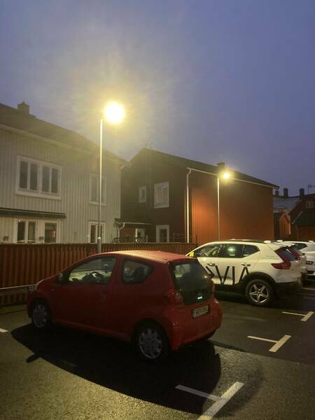

Oh crap! Freezing cold morning, late for work, red Toyota Aygo full with kids. What could possibly go wrong…  well…
After many years with Japanese cars and not having one single breakdown my luck finally went out. Car starts fine but stops after just a few seconds and smells of petrol.
Grey Toyota Aygo is not perfect either. It sets fault codes that lights up the check engine light. After a few more seconds the stability control, ABS light and traction control lights up. I’ve bought an OBD II reader, will put it to use tomorrow.

Red Toyota Aygo is back online. First garage didn’t solve the problem, they said that the subwoofer had made both keys loose its ability to speak to the car…
Okay
So we towed the car to Toyota instead. They had a good laugh about the subwoofer theory. Instead they found a broken cable under the dashboard. Might be rodent related.

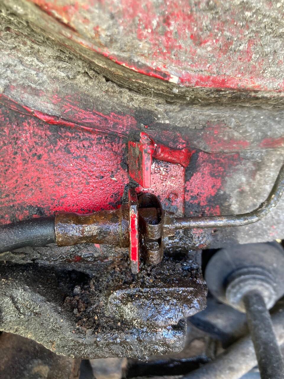

The Swedish equivalent to your MOT told me to change the brake hoses. They are not a fail yet, but change them before next inspection was what they said. Brake discs looked really thin and suddenly I had decided to change everything including callipers and that was easier said than done. The build sheet specified Girling brakes and they proved hard to find. It took a couple of weeks to source a pair. Saturday morning saw the start of operation “make the brakes great again”.IMG_3701.jpeg.fbe5eb93a982169b6aa558f8c77890ac.jpeg
Agony! 4 hours was spent on this brake pipe. 4 hours! That included a trip to the neighbouring town of Oskarshamn to buy tools. IMG_3705.jpeg.38d62fa5836534cad6f17e0dd9a597f4.jpeg
That should do it!

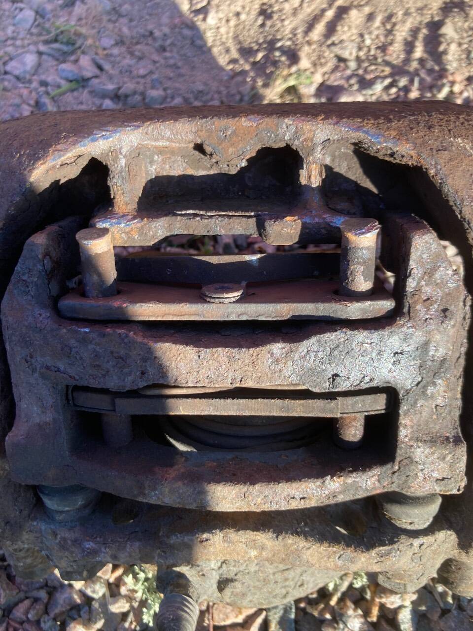

Everything else came apart just fine except for the pins holding the brake pads. I got one out, then I got angry… see picture. New pins are ordered from Autodoc.

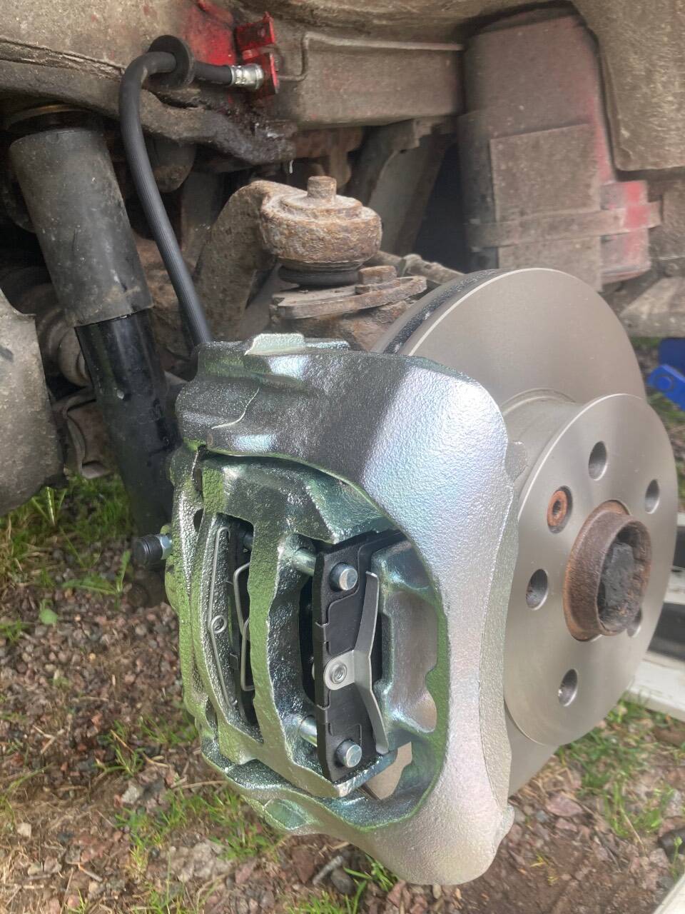

VW T4:  Got my parts from Autodoc and managed to get the brakes fitted on the T4. One brake line leaked, but after I nipped it up a bit it stayed dry. Mrs Nibbler helped me with bleeding the brakes and all was good. Nearly, I still had long pedal travel and the handbrake was bad on the left side. Turned out that the self adjuster wasn’t working on the left rear wheel. So I adjusted the brakes manually and all is now good. Self adjuster will be a project for the future.IMG_3749.jpeg.1933930a96f18beee93ece41bf8694d2.jpeg

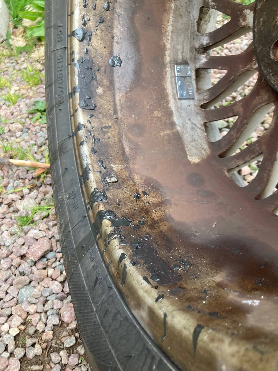

I also cleaned the inside of the aluminium wheels. There was quite a lot of rust flakes embedded in the mating surface. It’s there from the hilariously rusty Audi A4 that donated the wheels. Maybe this will cure the vibrations over 110 km/h, I don’t know.

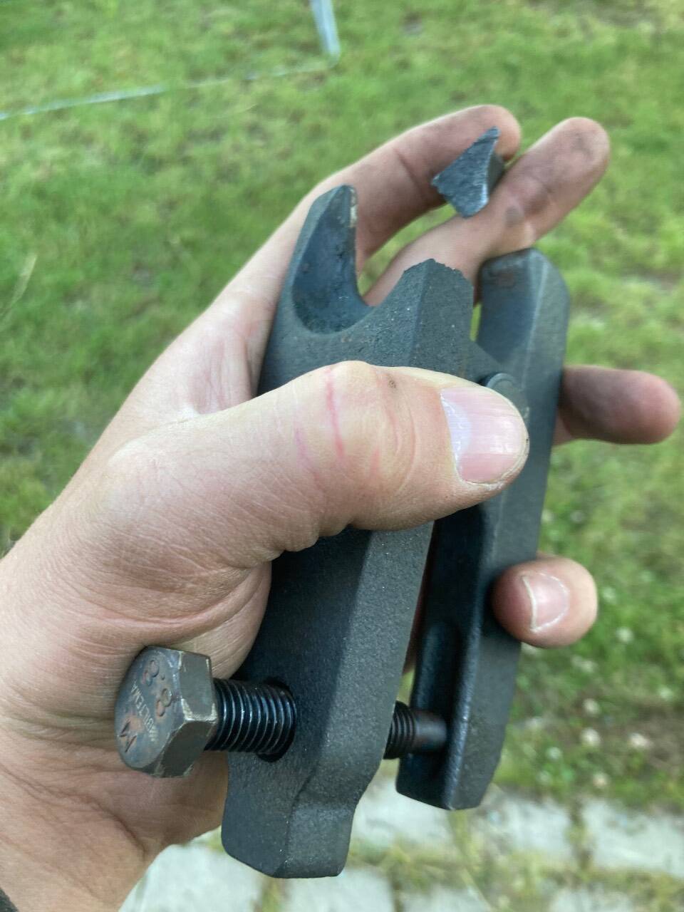

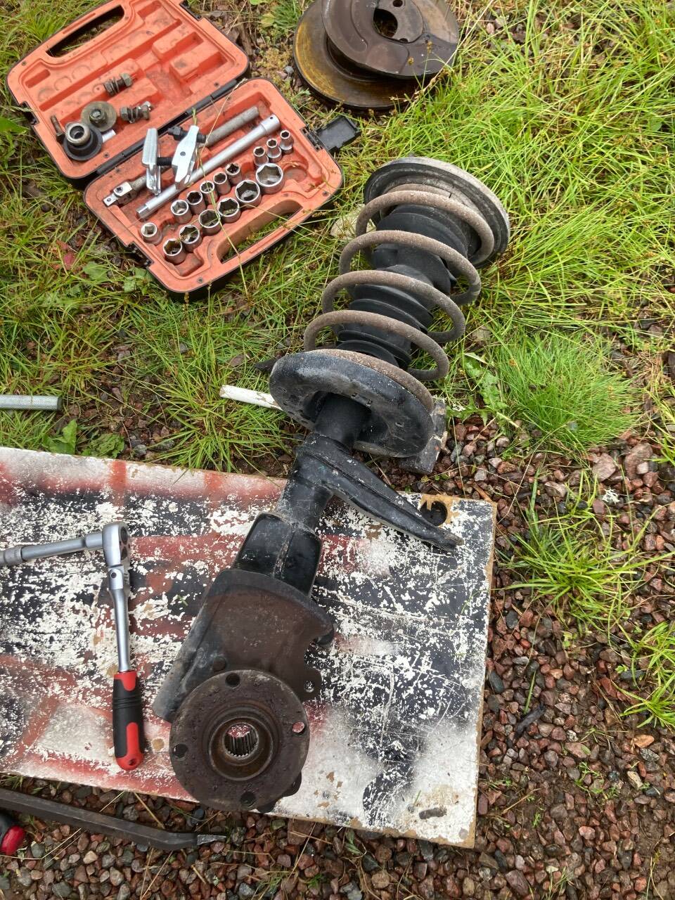

Audi 100 2,3E: Mounted a new control arm. Quite straight forward as this control arm strangely was much easier to fit than the other side. The roll bar still put up a fight, but I managed to beat it into submission at the end.

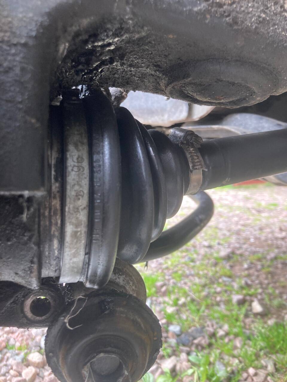

But the first thing I noticed when I got the wheel off was a quite a lot of grease on the inside of the rim. The cv-joint boot had come undone. My guess is that it was put to far in and when the perma-Quick ring, bracket, fastener (don’t know exact name) was tightened it had nothing to grip on and therefore actually was to loose. But I don’t know, I’m guessing here.  Anyhow, I put in more grease, changed the perma-quick thing and now it’s just a matter of wait and see.IMG_3751.jpeg.0a176eae85fe74bf1cfc55de5296c2d7.jpegIMG_3752.jpeg.8d9323b6eeb5970d5efc0706e106604e.jpeg

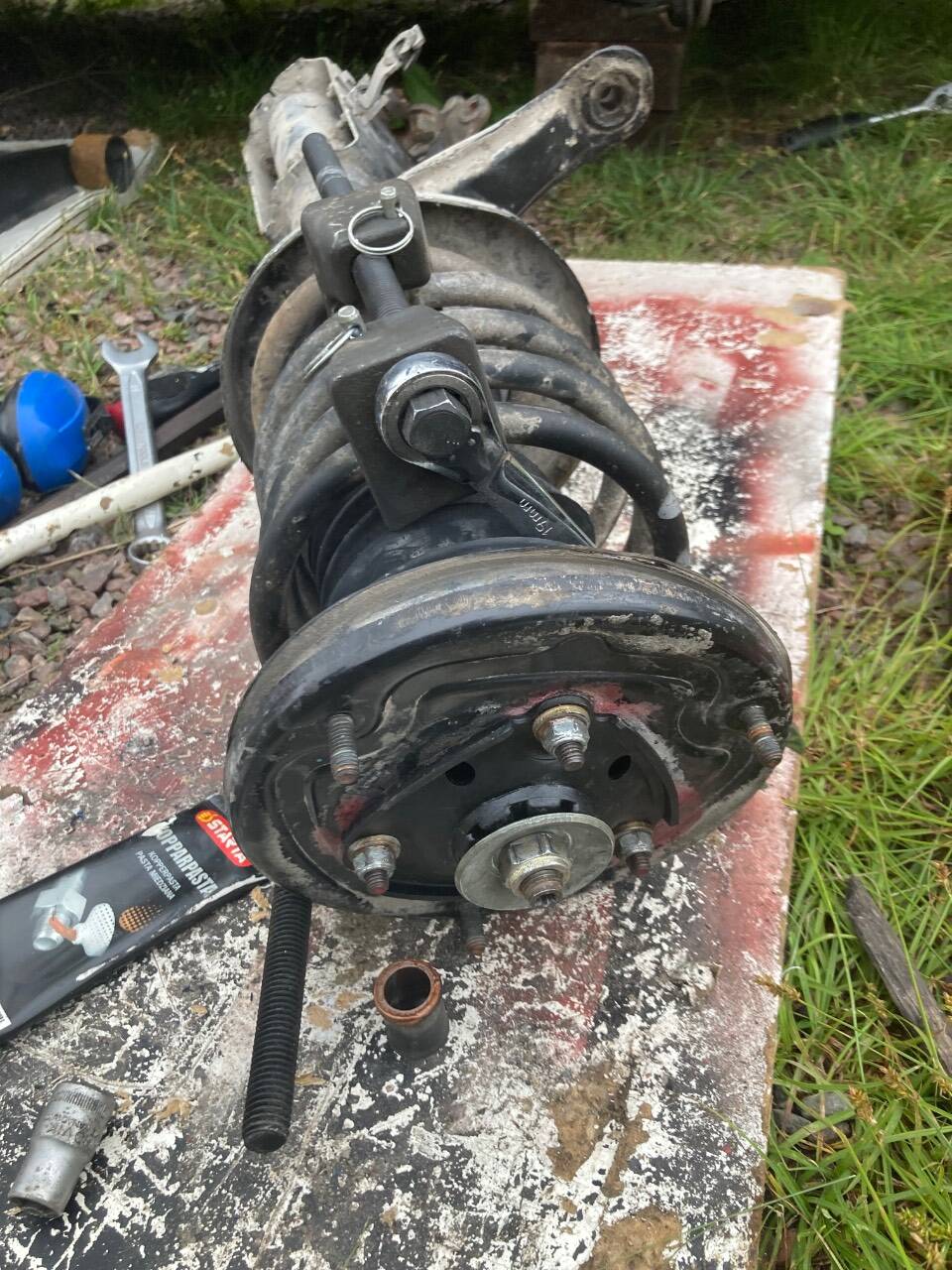

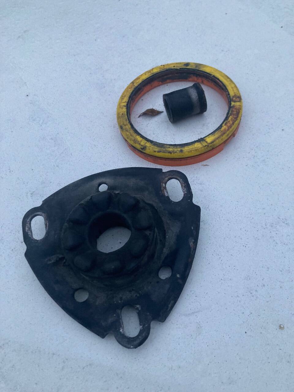

Audi 100 2,3E: I changed the worn balljoint in the steering linkage and I was totally convinced that the handling problems would be solved. I came back gutted after the test drive. It was a little better but the car still turned hard left under acceleration. And I broke my balljoint separator.IMG_4224.jpeg.f443b937d551c383f11a2c8e1ebf1279.jpeg
So when I got back I had Mrs Nibbler sit in the front seat and jerk the steering wheel back and forth and finally I found out the reason behind the cars strange behaviour. The suspension strut was moving back and forth quite badly. So I ordered parts and one week later I changed the top bearing and bushing and the car is now fine. IMG_4276.jpeg.cdab52cf7cbe84939381639f30cce21d.jpegIMG_4278.jpeg.1f972842a6b712b7b875e48759c01254.jpeg
Had problem with removing the shock absorber bolt. The torx was corroded and I had to force a larger torx socket in with a sledgehammer.
The old bearing was fine but the bushing was a mess!

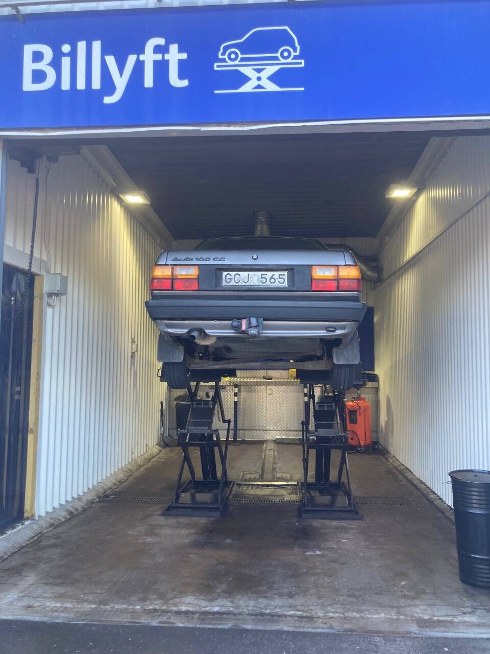

But all is not doom and gloom. Last picture for today is taken outside of Jannes Mekaniska Verkstad where the Audi was treated with a new cambelt and pulley, new belt for the diesel pump, water pump and maybe a new CV joint or maybe he just re-greased the old one and changed the boot. Edit: CV joint got changed.
So let’s hope the main bearings are still good 😀 This is not a car with extreme mileage so i keep my fingers crossed.IMG_4312.jpeg.44d6d8a5e84f9691acf38262d69ff3a1.jpeg
