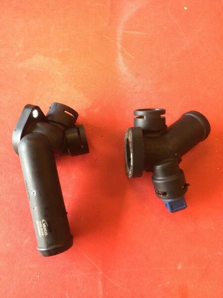

I love the smell of coolant in the morning. But there is something wrong here...
I give you guys a clue: new part to the left. Old part to the right. I ordered 3 different flanges just so this wouldn’t happen. And the boom box has stopped working as well 😕
I got it together in the end. With scavenged parts from a Golf III parked outside. So now it’s no longer leaking coolant, has new gearbox oil, engine oil and some other stuff. It was leaking coolant at two different flanges. Both quite hard to reach. One was cracked and the other one was close to disintegrating . Of course I got the wrong part and had to be creative to make it work.

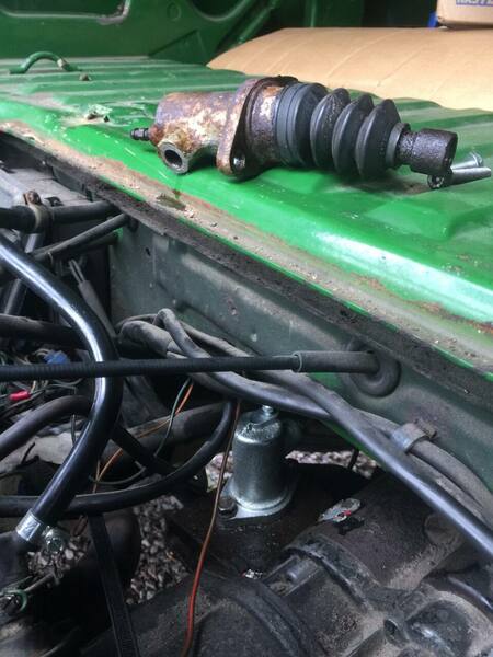

Changed the clutch slave cylinder today on the VW Transporter. A little bit fiddly but it went okay. Except the part when I got stuck under the car and had a bit of a panic attack...
Confident I had a working clutch I tried to drive to the recycling station. I got as far as the picture shows, then I lost reverse gear and it started to rain...
  • Sad 2
After a  bit of tinkering with the gear linkage I found reverse again. My theory is that when parked on uneven ground and the car flexing a bit the gear linkage was unable to move into reverse. After I adjusted the linkage today the gearbox is bloody perfect. I was so happy, so I started cleaning (see before picture) the garage were the Capri is parked and took the T3 to the shite capital of Sweden: Fågelfors! Worthy of a photo thread!
