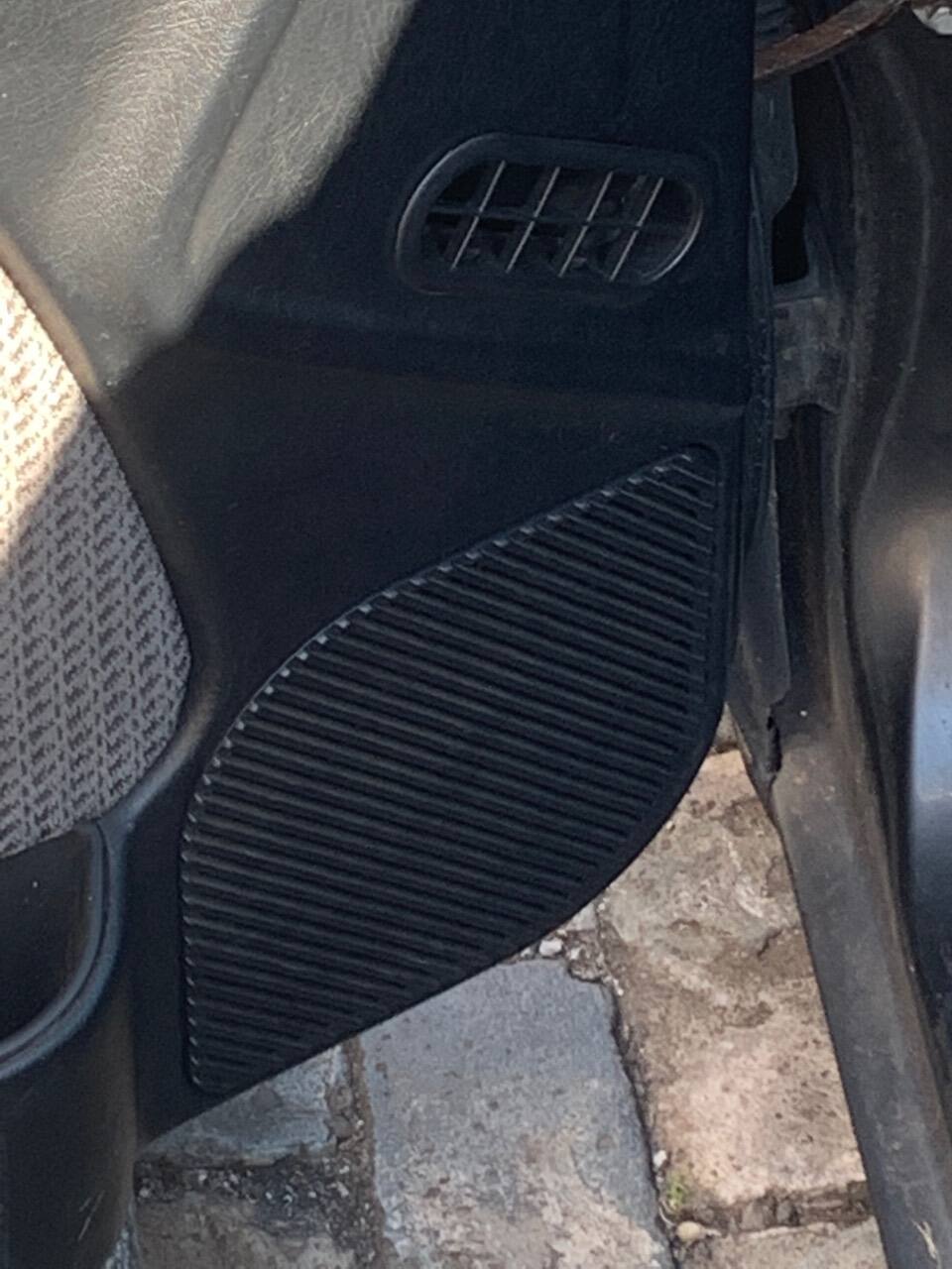

and the stereo in this sounded awful, I decided to fit the speakers from the C5 to it as they’re only a few months old
fits like a glove!
speaker grille fits perfectly now and looks so much better

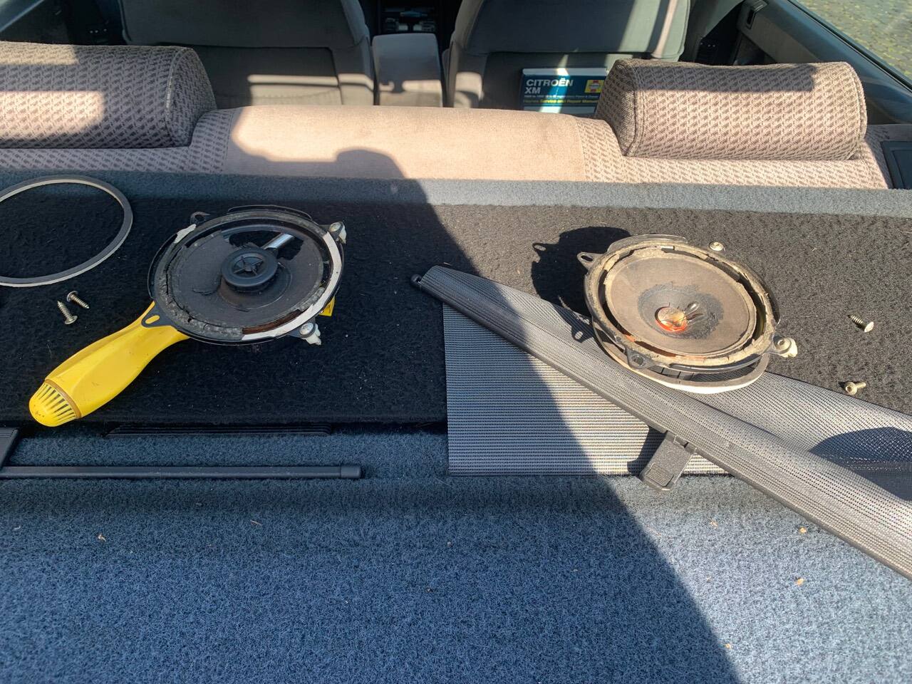

so then I decided it was time to replace the rear speakers
now those of you who’ve fitted new rear speakers to an XM will know how fun it is
that only worked to get 2 screws out, in the end I made the executive decision to break them and just force them out
yes, yes I do believe they require replacement!
now all I’ll say is just how staggering the difference in sound quality is now
it actually sounds good!AC0DFCB2-6956-4097-AA19-9FAED44866C9.thumb.jpeg.ab252d030f1399b29ab6e7374be953f7.jpeg

Interesting one tonight
driving home from work
suddenly a very strong smell of burning toast……
lasted for around 5 minutes then went away
let me guess, I’m going to have another fire tomorrow?
Bread on the stereo?
