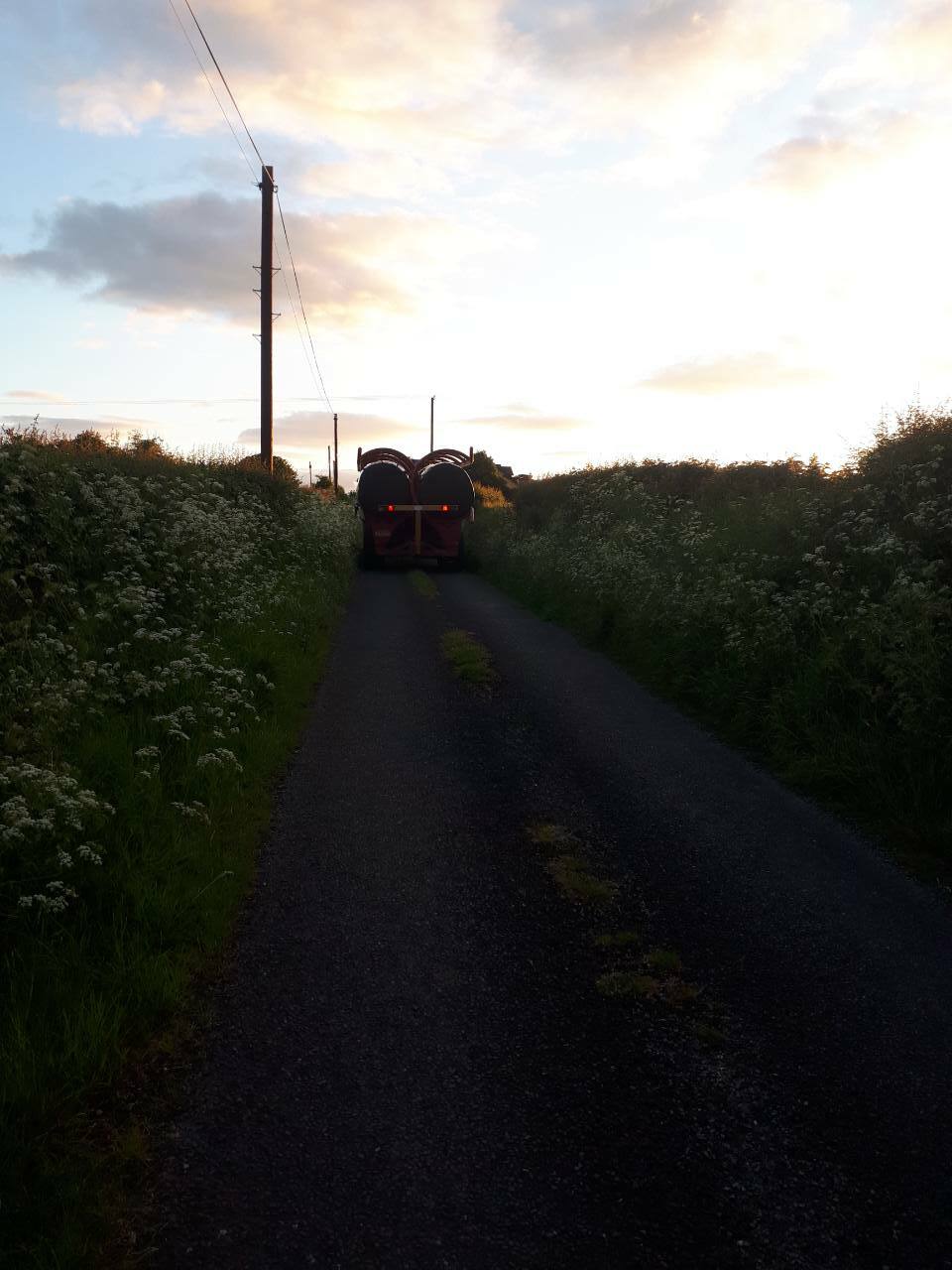

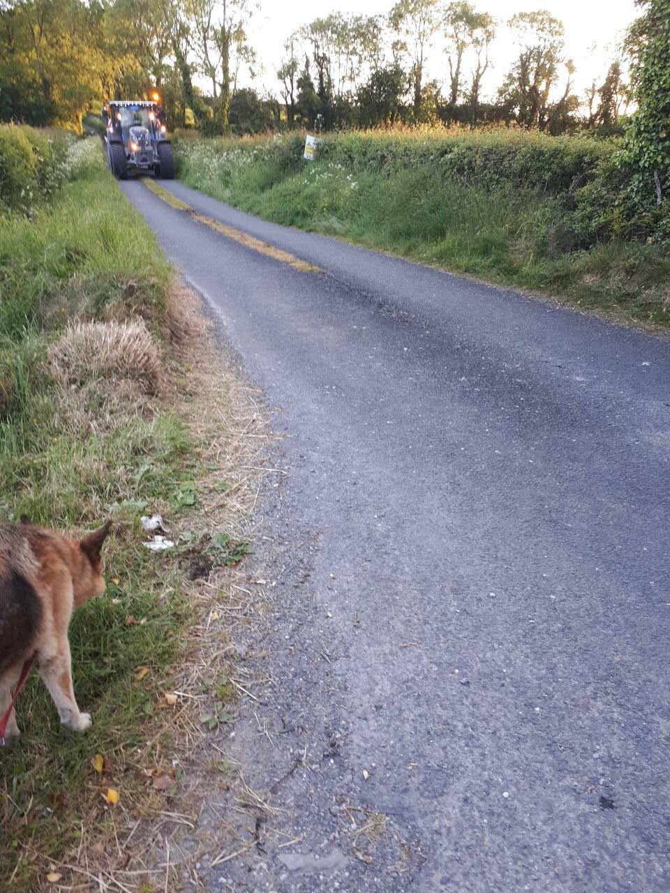

Just taken a few mins ago, these things are huge and fast,towing a massive trailer for hauling round bales of wrapped silage.
Too big for this narrow road.

Yes this looks too big for the roads. But it makes me wonder if the fields have really become so big that such tractors are needed? I understand that a larger tractor can be more efficient but there is a limit and it gets too big.
There isn't any really big farms around here,but with unpredictable weather and a short season,it's get as much done as you can in the shortest time possible.

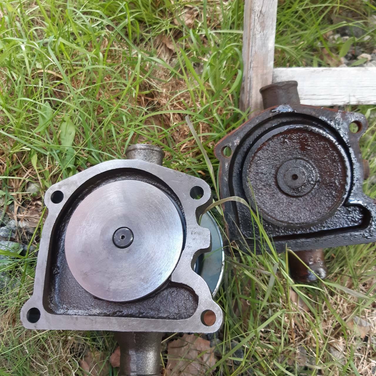

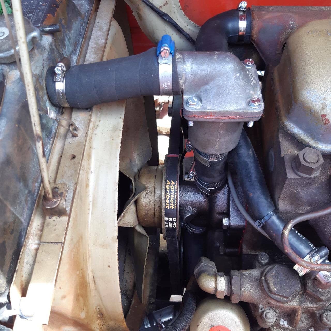

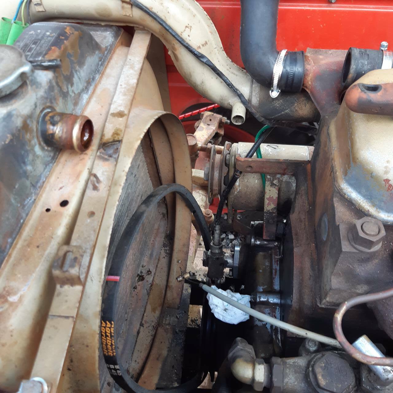

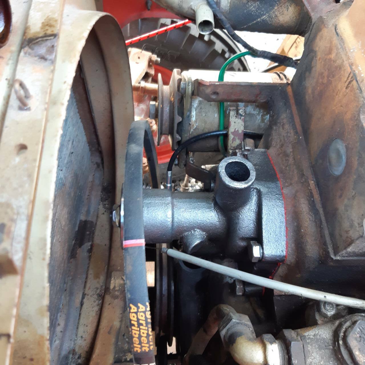

Today there was water pump change on the Zetor after the old one started leaking.
Started with moving the radiator a bit and then disassemble everything in the way and then removing the old water pump.
The old water pump looked better on the inside than I thought. There are also some small differences between new and old water pump but nothing that matters. The biggest difference is that the new water pump does not have refillable grease lubrication like the old one.
The new water pump is from the brand called Long Life which I have never heard of and can not find anything about so do not have much faith in this but hope it can last a few years. The pulley that came with it was so cheaply made that I chose to use the old one. And then the assembly of the water pump.
And then the assembly of the rest.
Will fill the cooling system with coolant tomorrow and I hope I do not get any leaks. I also going to hold on to the old water pump and overhaul it once I have time and then have it as a spare.

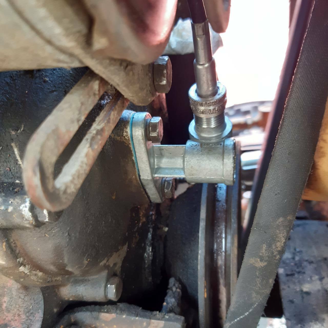

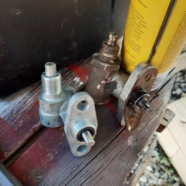

The second thing I got done today was to change the angle drive to the wire that drives the tachometer and hour meter. Also replaced the wire.
Since I work slowly and want to do the job properly all this took 6 hours. Tomorrow the plan is to hopefully complete the diesel system.

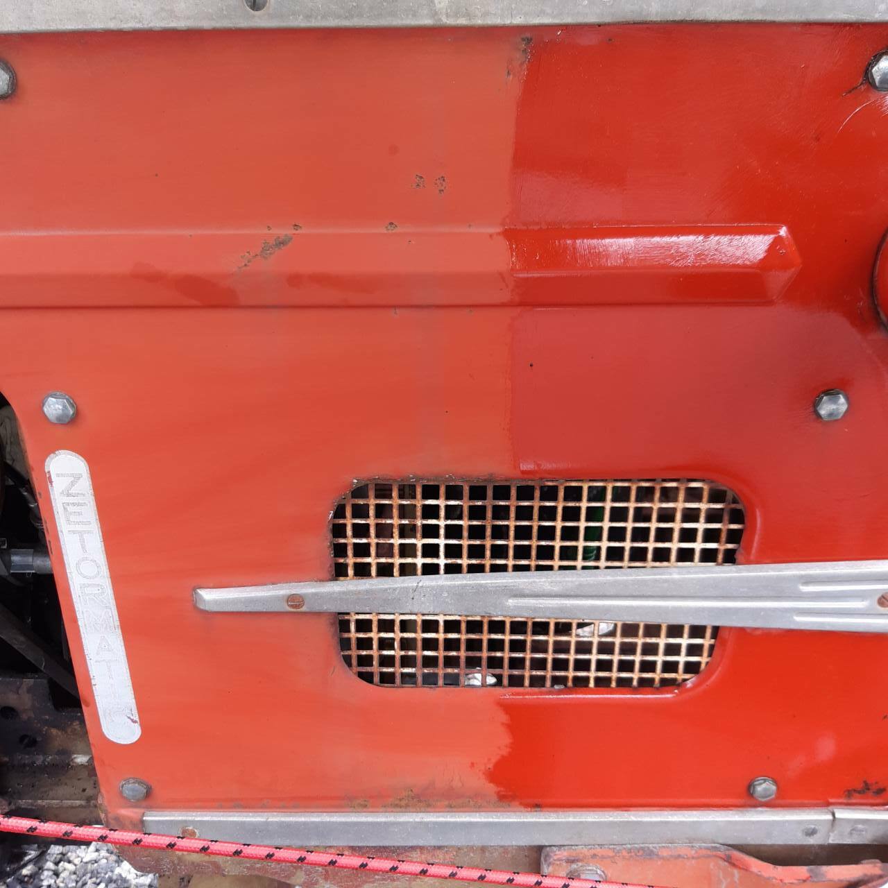

The next thing I did was to protect the body and slow down the rust. There are several ways I could do this but chose to apply Fluid Film. I applied this as one would with a car wax, applied it left it on for a while (longer than wax) and then wiped away the residue. It also brought out the color better which is visible in the picture below.
And the result was very good and after I had wiped away the remnants of Fluid Film it was completely dry and clean to touch. But unfortunately someone has applied spray can primer on the bonnet that does not look good and rust is coming through so it must be painted before winter.
So now this is almost done. If I do not get any leaks on the cooling system or the diesel system the big things are done. Then there are only small things left like greasing, figuring out the charging lamp and other things.

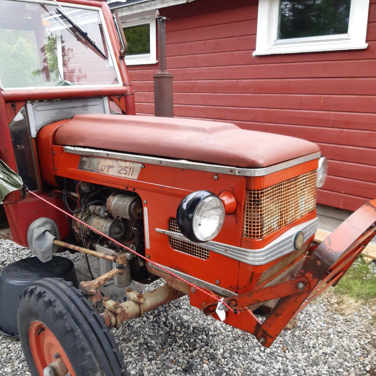

A little Zetor update. Today it was put to work with pallet forks to move pallets with firewood. Have a small diesel leak that I am struggling with, changed the bulb for the charging lamp from 2w to 4w it did not help anything and is still lit so changed back to 2w I do not understand any of this. The cooling system has no leaks and the new water pump works. But we got a new problem we forgot to test the 3 point and there is something wrong with it. Is a bit complicated to explain but after talking to specialists there is probably an internal hydraulic leak. This is a lot of work to fix and is complicated so this needs to be done by professionals. This will most likely be fixed and by the local tractor  mechanic is not sure when but will most likely be after the summer holidays.
