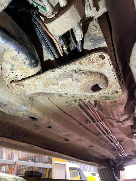

Whilst underneath I noticed this connection on one of the two pipes running to the rear (that's the front sub frame shown in the right of the picture).
Looking at the other pipe I found it had a similar connection but it was obscured by the front subframe. If I could get both of these to release I could avoid the hassle of trying to route the new pipes alone the firewall. The one you can see above was easy enough to access but the other one was behind the subframe. I disconnected this pipe from the ABS pump and unclipped it from the firewall clips, I then cut the pipe heading towards the rear right at the connection. I was able to just and no more then ease the connection up and get access to it from the inner wheel arch. Luckily both of these connections released ok.

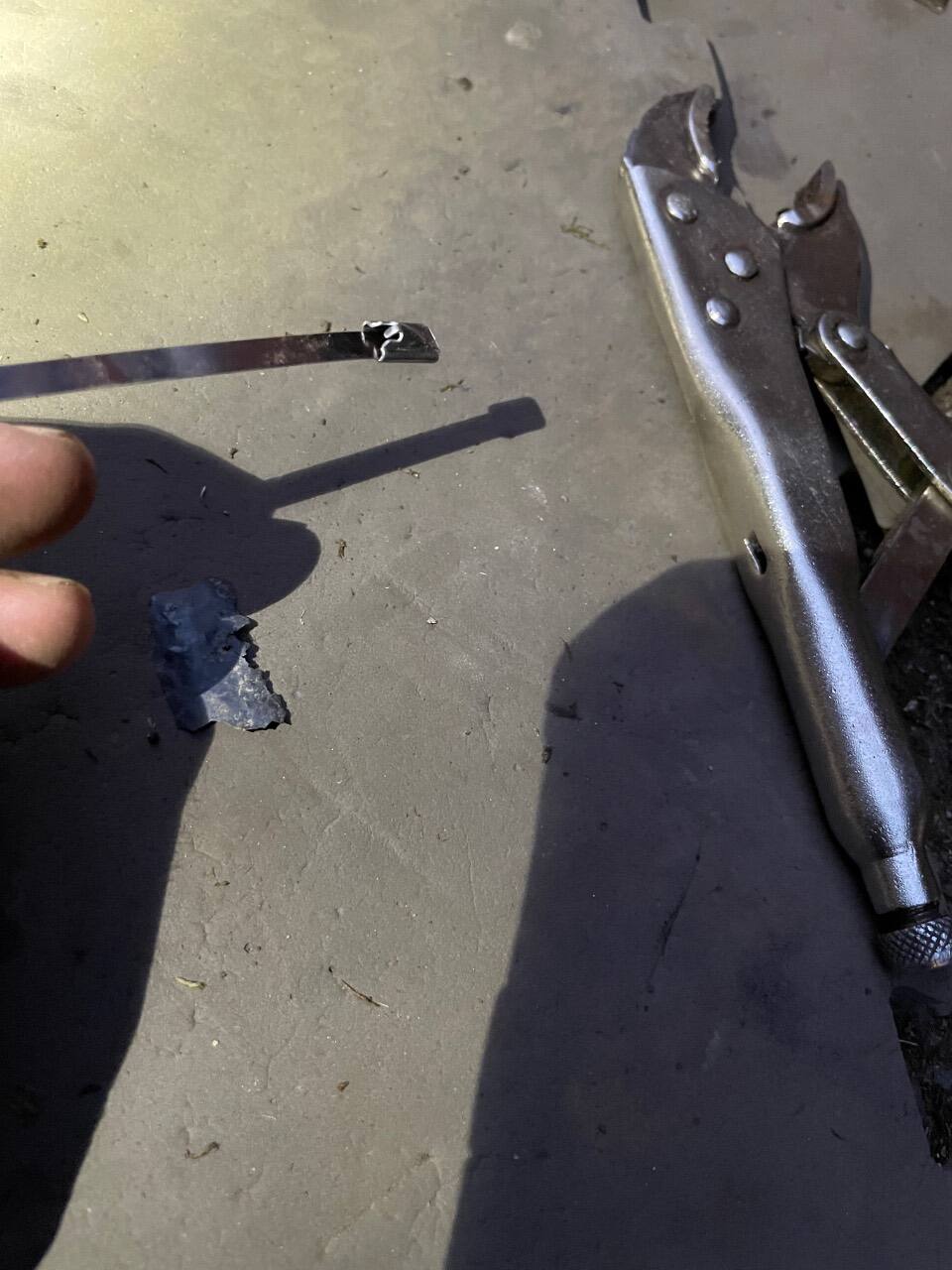

I flipped the car upside down to make it easier to install. Speaking of which I got the metal clips, I thought they worked like tie wraps but I couldn’t get the little pawl to grip. I ended up bending the end over and sort of half hammering it closed.
anyone know what you’re supposed to do with them?
I bought the same, if I remember right some worked fine and others wouldn't grip at all without a little bit of persuasion.
If you slide them through the 'wrong' side of the head they just slip. If you slide them through the right side they grip and grip and cannot be released no matter how much you slash your skin on the sharp edges.

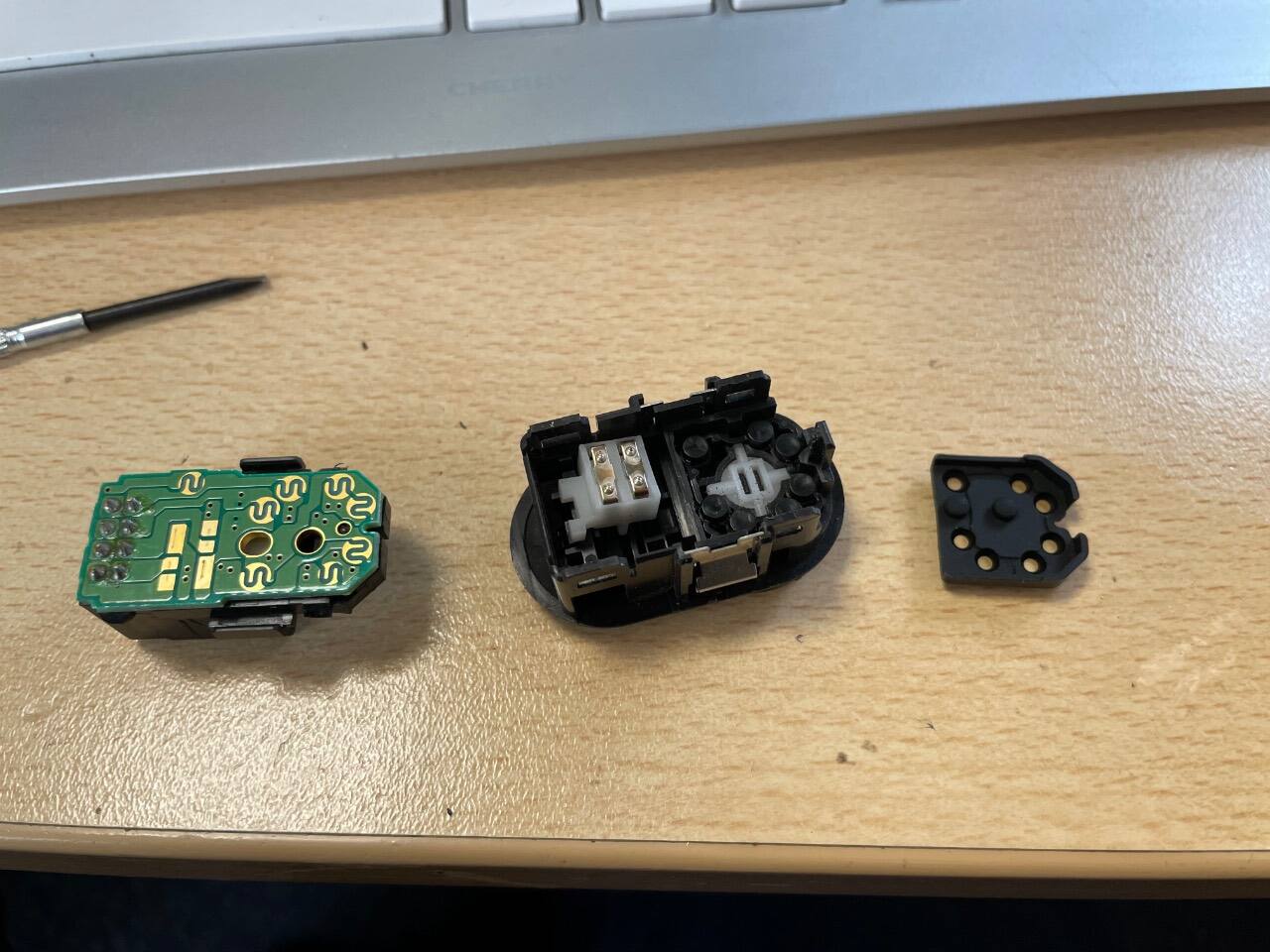

Had a game of two halves, I took the mirror switch apart and cleaned all the contacts.
When I refitted it, it worked perfectly and I could now adjust both mirrors from the comfort of the driver’s seat.
Following from this success I thought I’d have another look at the key. I’d cleaned it previously and it was sort of working to unlock if you kept repeatedly pressing the buttons. I took it apart and cleaned everything again. However this time after reassembling it, it was completely dead. Nothing I could do would make the car respond to it. I took it apart again and found I was getting almost battery voltage across the contacts for the buttons so it looks like some of it is working. I’m assuming whatever part of it was intermittent is now dead :(

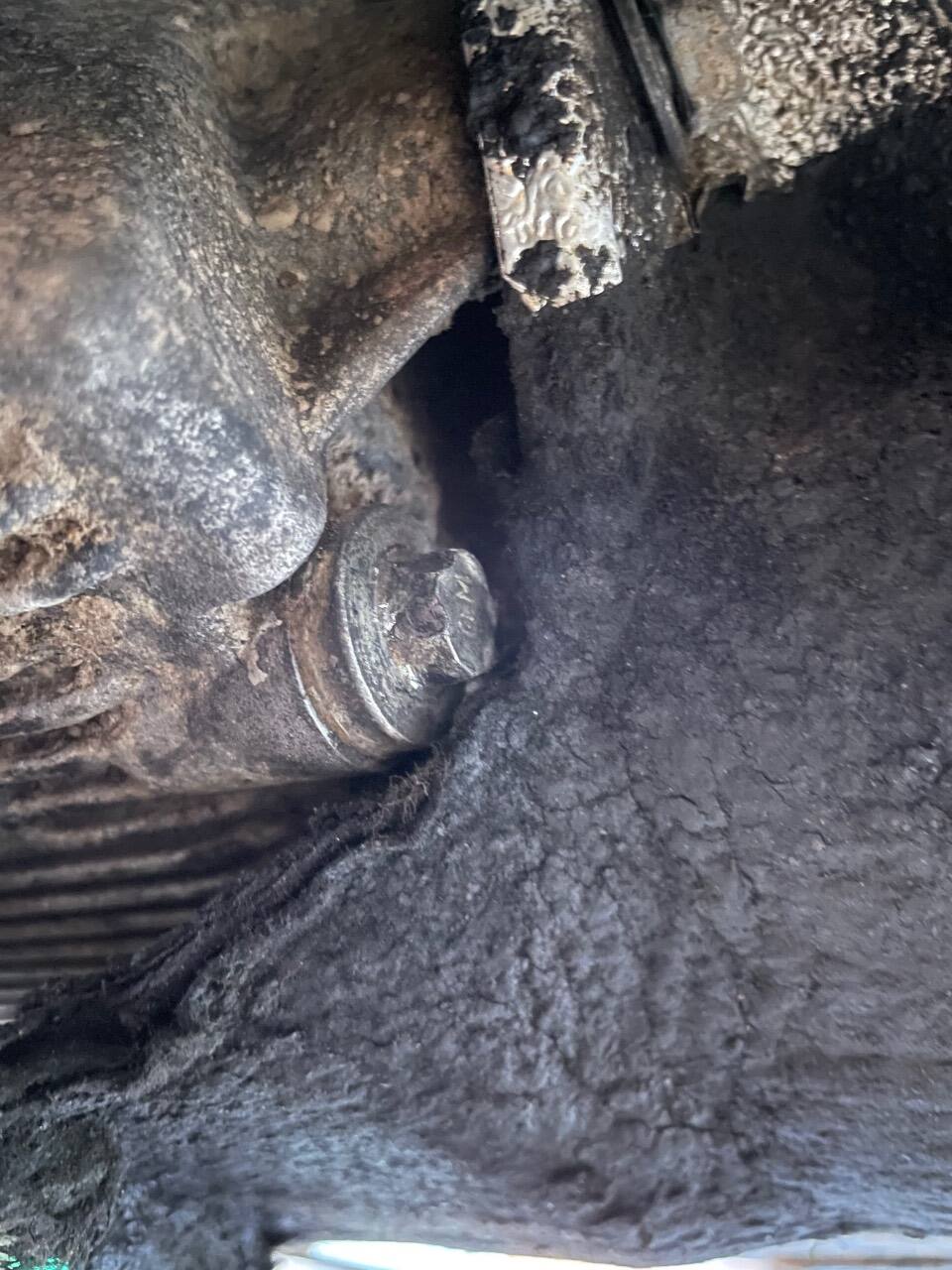

Things weren’t down hill when I tried to remove the sump plug. My Lidl impact gun, and T bar smacked with a mallet would touch it. I even tried my trick of sticking a jack under the T bar, all this did was deform the head even though I was using a six sided socket. You can see the problem in the picture as the plug has ‘GM’ stamped on it and as the saying goes all Vauxhalls are shite.
I gave up and used a hand pump through the dipstick tube. Annoyingly enough this was really thin so I had to use a piece of fish tank air tubing. As you can imagine it took a lot of pumping and time but I managed to get the old oil out and fresh oil in.

That's exactly what I'll be doing to mine tomorrow,. Is it just a case of popping it out the trim, splitting it and wazzing some contact cleaner in there?
Yep, contact cleaner and a wee cloth. Be careful though as the silver side clips are very fiddly.

If you don't get any joy, I bought a cheapo replacement from the bay for about £15 and I've got full mirror capability again.
It's a really nasty bit of GM design, that switch.
I think a lot of drivers only use the mirror switch for small adjustments thus not giving the switch and mirror enough work to do,i give my switch and mirrors a full workout every couple of months to keep everything moving.
Managed to pull it out and clean it but still isn't 100%. All the new switches I see on eBay don't have the button for the nearside dip-on-reverse but I'd never use that so I'll just get the standard one. Far easier to remove from the housing than I imagined though, might be a shit switch but it's an easy swap.
