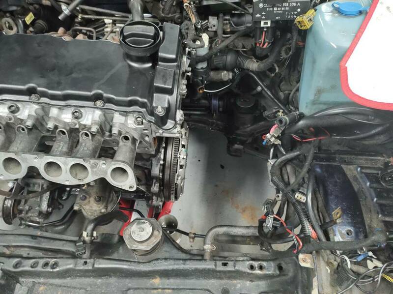

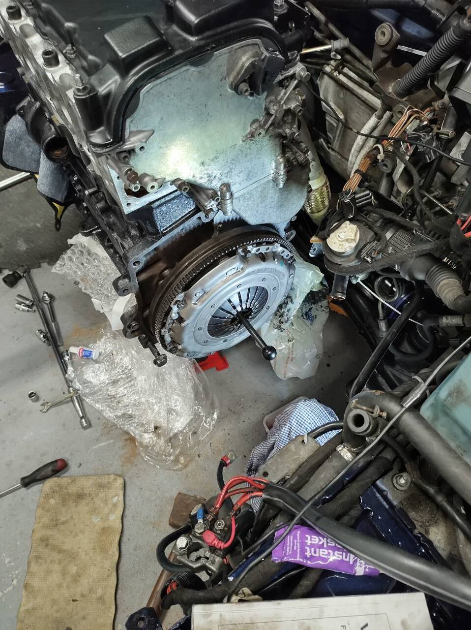

Earlier this week I got the flywheel on...
Then the clutch went on with a little fiddling:
IMG_20240428_124745267_HDR.jpg.3e0f250a9c5b570c159995f8a71a7354.jpgIMG_20240428_125536773.jpg.7fadd67a1c72c02de1693bd0000e7e3f.jpg

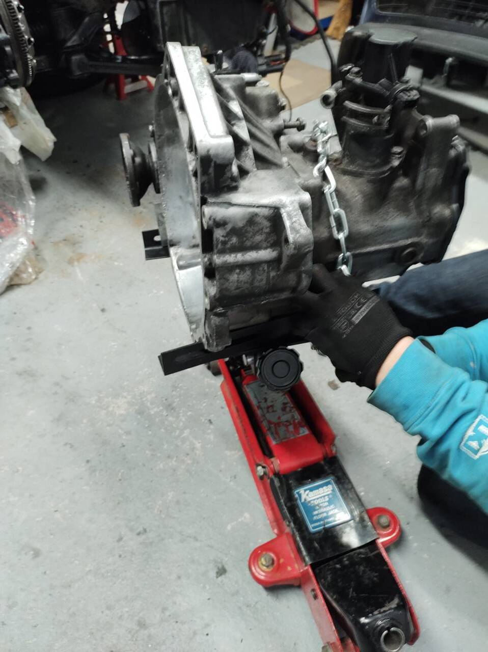

Then it was time to get the gearbox in. IMG_20240503_095035343.jpg.5a77219ac362694c4259182a4930ad3f.jpg
@grogeehas this Wonder device that takes the wobble out of lifting it on a jack, but no matter what I / we do, this thing just will not go back in.
The offside driveshaft flange interferes with the clutch pressure plate when it's rotated and I don't have space against the near side chassis leg/subframe to get the box further back.
The really piss ass annoying thing is that I've done this twice before and managed to do it without too much drama. I think the engine must just be in a position that makes it too tricky this time. We've looked at removing the driveshaft flange but it requires diff deconstruction to do on this box. It's also unnecessary as I say - this has been done TWICE before...
Next plan is to get another jack and have both the box and the engine on trolley jacks and hope to align them... Any other suggestions very very welcome!

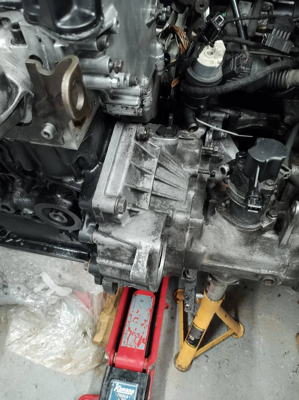

Little update- I went back to what I remembered doing last time to get the gearbox in and managed to get the bloody thing in!
I fitted some lower mount bits and now need a second pair of hands to help with driveshafts.

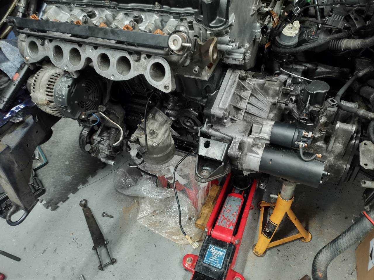

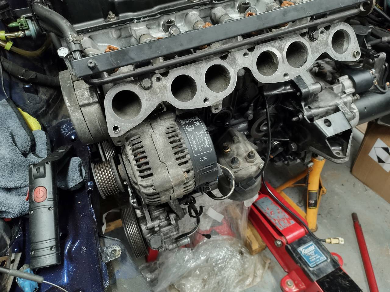

I didn't want to jinx my run of progress so just focused on one or two easyish bolt on things to finish the evening. Alternator on:
Power steering pump and oil filter housing:
Starter motor and support bracket:
Fuel rail and spark plugs back in:IMG_20240507_202759433_HDR.jpg.a5abf4356b9ac7654a1aef9e5496b0c8.jpg
I'll be calling on @grogee to get a bit further along and then hope to chip away and the one-man aspects for an hour or so each evening. I'd like to give it a twirl in June if at all possible!!!

More progress this weekend!
First off @grogee popped by and helped me line up the lump to get the gearbox mount set in place. Job jobbed - must torque it up at some point!IMG_20240512_180057555_HDR.jpg.78e980027ce56a17d594459d43f8ef6b.jpg
Other bits on the engine side. Water pump went in and I fitted the stat housing/crack pipe and the oil cooler along with a new oil filter that the postie had helpfully left in a bush 🖕

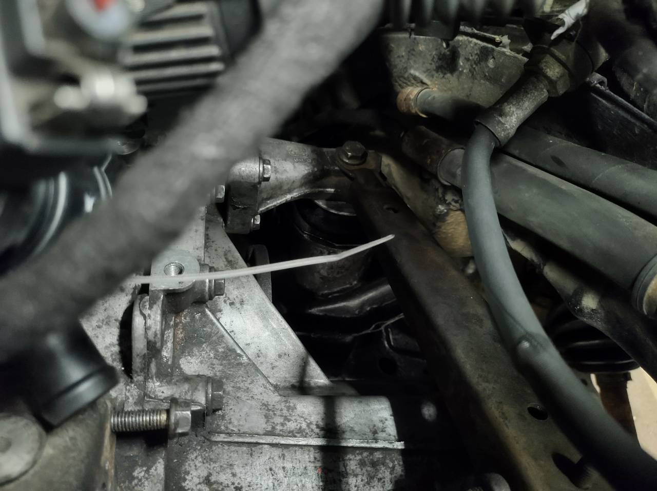

Step by step... Offside driveshaft fitted up. Needs torquing. Hate this job - alignment and about three pairs of hands needed, but patience prevailed:

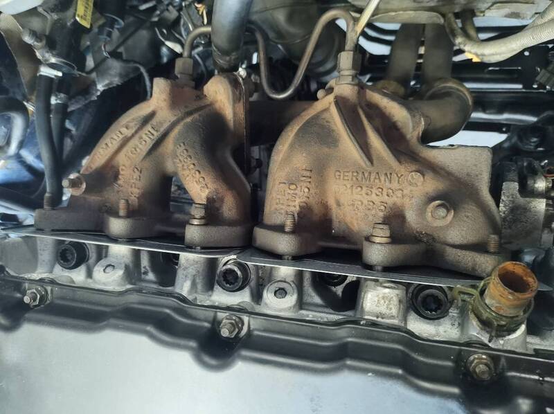

Then exhaust manifold fitted up:
Torqued up and cover fitted on:
Finally, I got all three mounts aligned with the correct bolts ( @grogee knows how tricky this has been) and torqued down to 60Nm.
