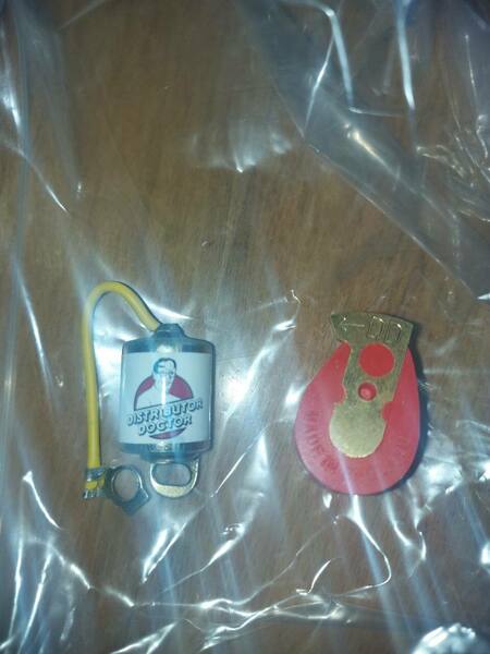

So on drive it day, this didn't. Started fine and ran up to temp in the garage then, just as I was about to go out, started missing popping banging and no throttle response. Shut the door in a sulk and left it.
Started again when I'd calmed down. Checked points gap, cleaned them checked for spark. Started up first crack as per and ran fine. So I'm thinking coil or condenser. So I bought some nice things
20220506_174955.thumb.jpg.4bc7f65d8cf047839163ae1ca49fce15.jpg20220506_153428.thumb.jpg.84d32b0183cd56f2b13f052baa7a886e.jpg
Seems right as rain now but tomorow will tell I guess. Thanks to @SiC and @Mally for getting me to buy good products not cheap shit.

I'm sure* it will be fine...............but the rotor arm on @Mrs Spart 's MGB was Distributer Doctor like your's.  That's why I didn't twig it straight away.
It had been stood a while though.
Why, what happened?
Long story, it's all on here somewhere.
Because original rotor arm was DD I left it alone. Sorted a few bits and pieces, got it running, ran it 15 mins or so.
She jumped in for a test drive........it stopped and wouldn't start.
I ordered new red rotor arm, delivered to her house. She fitted it.  It's been fine ever since.

Should be sound. This one was brand new this afternoon. Cheers for the heads up though

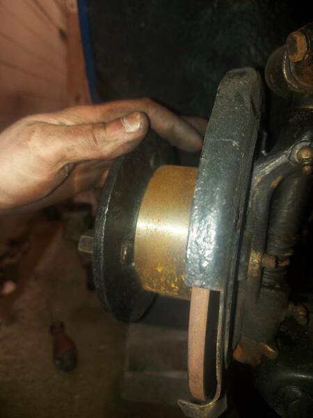

Picture heavy update. I've had wheels and tyres ready to go on this for ages. First the studs in both front hubs were bent (fuck knows how, must have been someone's good idea cos how do you bend 8 studs by accident?). Then the studs on the rear hubs were too short. So took a days holiday and headed to the unit in a car loaded with parts.
Drums off, half shafts out, hubs off and studs changed at rear (along with half shaft seals).
