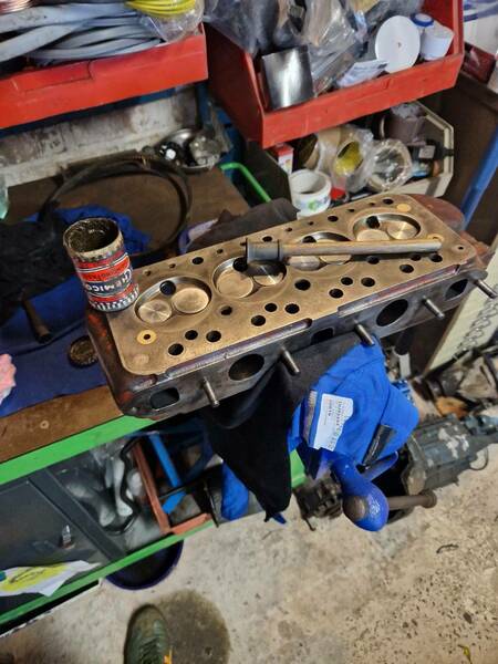

Head stripped and cleaned. Looks in good order. No cracks between the valve seats, seats themselves look good. Will NDT it tomorow cos I can, just to be sure.
It hasn't got unleaded exhaust seats sadly. My go to engine man wants 50 quid a seat. Too rich for me at the moment. Lead additive it is then. It has got one insert fitted. Best guess is a dropped valve at some point in the dim and distant causing damage and necessitating an insert to repair. New stem seals, exhaust valves and a new set of valve guides going in (valve guides are mainly bolloxed).
Before becoming too self congratulatory, I need to put it on the surface plate tomorow and just make sure.
(Edit. The more I look at that pitting around the galleries, the more I'm erring on the side of getting a light skim to clean up.)

Also, the head is casting number 12G940, the stamping near the stat reads 12G938. Best I can research is that it makes it an early Sprite or midget head and would've had double valve springs. Could one of our a series experts like @Mr Pastry or @MiniMinorMk3 put me right (I don't have double valve springs fitted)?
You should use valve springs that suit the camshaft, so there isn't really enough information about what you have to suggest anything sensible.
I think all the 1275 Spridgets had double springs, but Marinas had single springs.  That is with quite mild camshafts of course.  They all revved to about the same limit.   Maybe yours are Marina springs?  Free length 1.95", fitted length 1.383", load at fitted length 79.5 lbs.
Unless you can find exactly the springs that are designed for your cam, I think you just have to suck it and see,
But put it this way - if you had just stuck it straight in the car, fired it up and driven it, you'd probably be thrilled with it.

12G938 isnt anything particularly special beyond a 940 head but it should have double springs. Given the cam youve got I would consider getting a double spring  even if theyre just standard doubles. It will be fine without as has been said but you might suffer valve float before the camshaft is done giving all its got, particularly with something like a 731.
Minispares hold double valve spring sets for standard setups for fairly cheap. Id probably also be considering them for a lot of other parts too!

Back to the engine build. New valve guides and exhaust valves bought this week and new guides pressed in. I made up a guide on the Miller slightly bigger ID than the OD of the guides at a length of 15.25mm which is the deck height I want them pressed in to. Head in the partwash to warm it up, guides in the ice box in the canteen fridge, they went in easy.
20231121_171441.thumb.jpg.f309443f8752f230d0f027e98b69c91c.jpgso today after window cleaning, i needed to lap the valves in before the head goes for a mild skim this week to cleanup.
20231126_133316.thumb.jpg.704ab3e9f3025560a0537de9e6ed41c2.jpgDidn't someone say lapping valves in is quite theraputic? No? Thats cos it isnt. Seats have come up well though.
20231126_135642.thumb.jpg.159fc699431c64004597184b7cfe2b88.jpg20231126_151209.thumb.jpg.95596be97b477da86d97481480ef6590.jpgThank god thats done anyhow. Even god had a day off sunday. Cheers all
