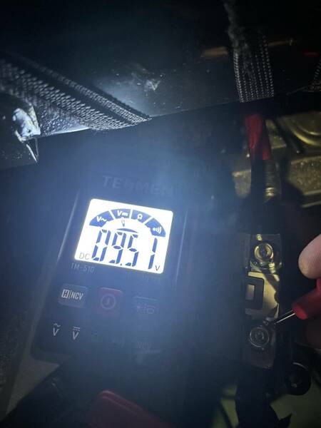

JJ0063 Posted November 2, 2023 Author Posted November 2, 2023 10 hours ago, cobblers said: if the light is on the relay it's getting power from the main battery, it's probably just the fuse between the relay and your pleasure battery that's gone. Best to put the battery on a mains charger for a while first of all - the surge of current when charging a really flat battery is what usually blows the fuse, so if you get it topped up first that'll save it just blowing the new fuse! Give this man a medal! Only thing is the relay seems to be on even with the ignition off. Dicky SCR or just too much voltage in my new main starter battery? GrumpiusMaximus 1
cobblers Posted November 2, 2023 Posted November 2, 2023 What does the relay look like? If it's a voltage sensing one, it would probably still be switched on at 13.09V anyway so it might not be faulty that's fairly decent sized wire, a lot better than I was expecting!
JJ0063 Posted November 2, 2023 Author Posted November 2, 2023 25 minutes ago, cobblers said: What does the relay look like? If it's a voltage sensing one, it would probably still be switched on at 13.09V anyway so it might not be faulty that's fairly decent sized wire, a lot better than I was expecting! I’ll have to check the exact one but it is a voltage sensing one as it definitely had what volts it cuts in and out on but I couldn’t see in the dark what the figures were, it was one of these type though I’m sure: The wiring does all appear pretty well done for a DIY job. All the speakers etc are Focal and have been wired into an amp so he seems to have spent money on doing things half decently rather than just the cheapest way. Now going to order a trickle charger from Amazon as I seem to have lost my old school battery charger over the years. I can’t see the split charge recovering it from the 9v it’s at now without a hand! barefoot and GrumpiusMaximus 2

JJ0063 Posted November 3, 2023 Author Posted November 3, 2023 Right new fuse is in and I’ve got it connected to this absolute fire hazard Amazon special charger which cost £16 and looks like it cost £16 😂 Tickman, GrumpiusMaximus and mercedade 3
JJ0063 Posted November 3, 2023 Author Posted November 3, 2023 Well I have to admit the charger has impressed me. Stuck it on in repair mode which seems to pulse it, left it probably 3-4 hours, went out and it’s done. Sitting at 12.6v and when the engines running the split charge is working and takes it up to 13.6v. Wondering whether to install that charger semi-permanently and then when we plug into camp sites, it can be topping the leisure battery up whilst we’re parked up. Can’t do any harm I guess. yes oui si and barefoot 2
