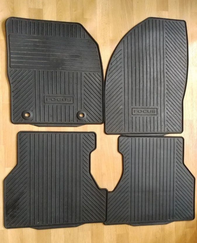

On 25/01/2022 at 14:56, Missy Charm said:
I used to have pink plastic floor mats.  Unfortunately the driver's side mat has split, which allowed dirt to pass through to the carpet below.  That mat was, therefore, pointless.  The solution to Katastrophic Kar-Mat Kollapse Gate was to buy a new set.  An unrelated trip to B&M to look for a potato peeler was unsuccessful, however did turn up a set of RAC branded car mats.
The price was reasonable and they are BRITISH.
Now in place.  The pink ones were nicer looking, however it's nice to have carpet mats back in the car.
How did I miss(y Charm) this?
Those mats, sorry to say, are absolutely horrible. They'll let probably more debris in as they don't fit properly than properly fitted mats. Plus, I needed to wash my eyes after seeing those.
May I suggest;
https://www.ebay.co.uk/itm/374944965673
These mats are on-par with OEM mats. In fact, I believe these makers make mats for specific car manufacturers.
I bought a set for a work colleagues Nissan Note, when they arrived, let's say, I was a little jealous at how nice they were.
They're not those horrid cheap thin-as-paper tufted jobs and generally, they'll have the locating holes/pins to keep the drivers one in place.
There is a proper Ford set for £cheaps on there;
https://www.ebay.co.uk/itm/167782668828
£16 or thereabouts. They're a little used hence cheap I suppose, they have a couple of tiny holes and one locating hole surround is missing.
There is a set of rubber ones here, also cheap(er) for what rubber ones usually go for:

£31.99 - I'd personally reccomend these. You can't really go wrong with proper rubber mats.
Ours is piss wet through at the minute, it’s leaking through the bulkhead seam under the windscreen.
May I suggest;
https://www.ebay.co.uk/itm/326884603464
