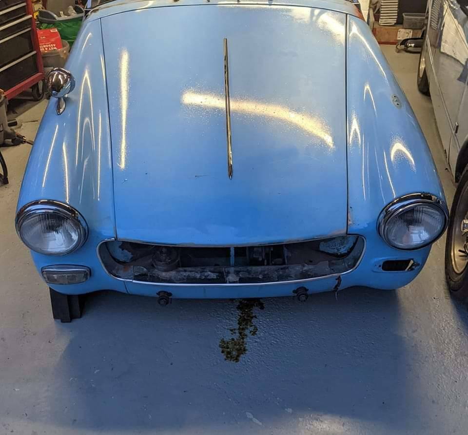

It really doesn't like its arse end in the air. This is just from one days worth of leakage. I know they will leak but not usually anywhere near this bad. Going to have to get another grow bag tray and put it under here.
Trying to figure out where it's coming from. I expected it out the front, not the rear. Possibly out of a seal in the gearbox? Then mixing with dirty engine oil from elsewhere.
If I have to rip the engine and transmission out, it'll mean it turns into an even bigger project. Seriously now contemplating stripping everything off, having the shell media blasted and going for a full restoration from there.
At least it doesn't do it when it's sat level though.
Sounds like you've fixed it already then. Get the thing solid and running and drive round in it for a bit, and THEN work out if you think it's worth the expense of a proper strip-down and rebuild. Old cars drop oil, nothing to be concerned about.
