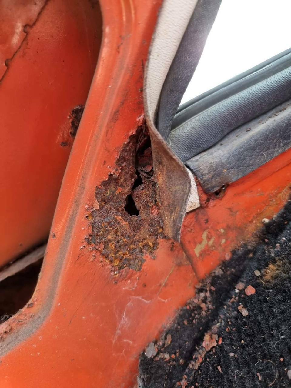

As I've found out tonight...
Riveted
Fillered
Braised
Rogue MIG wire
Filler in places that don't make sense. You can't see this with the panel on
Removed with a flat headed screwdriver to prise off the braze and unpenetrated welds.
At least I have decent access.
This bit I think is actually welded with some penetration.
At least these piss poor attempts at fixing the panels make it really easy to remove them.

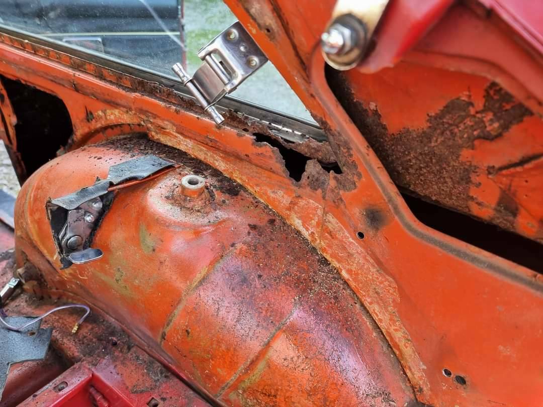

I see another trip to Moss again in the near future. Again it is braised on with a couple of poor welds.
Filler hiding the join on the inside.
Filler also on the inside. Weirdly against fresh metal.
There's this big repair patch on the inside of the arch.
Again fuggin' braised. If it was badly welded I could have run new beads but as it's braised, I need to take it all off to redo.
The other side of the repair panel is one huge thick chunk of filler. This is one of the mounting areas for the soft top. No wonder the filler has cracked.

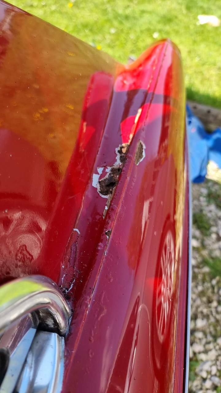

20 minutes ago, SiC said:
This had previously been restored to be a shiny car quite a few years ago. It's a good reminder that many of these expensive shiny cars you see in dealers, look like this underneath!

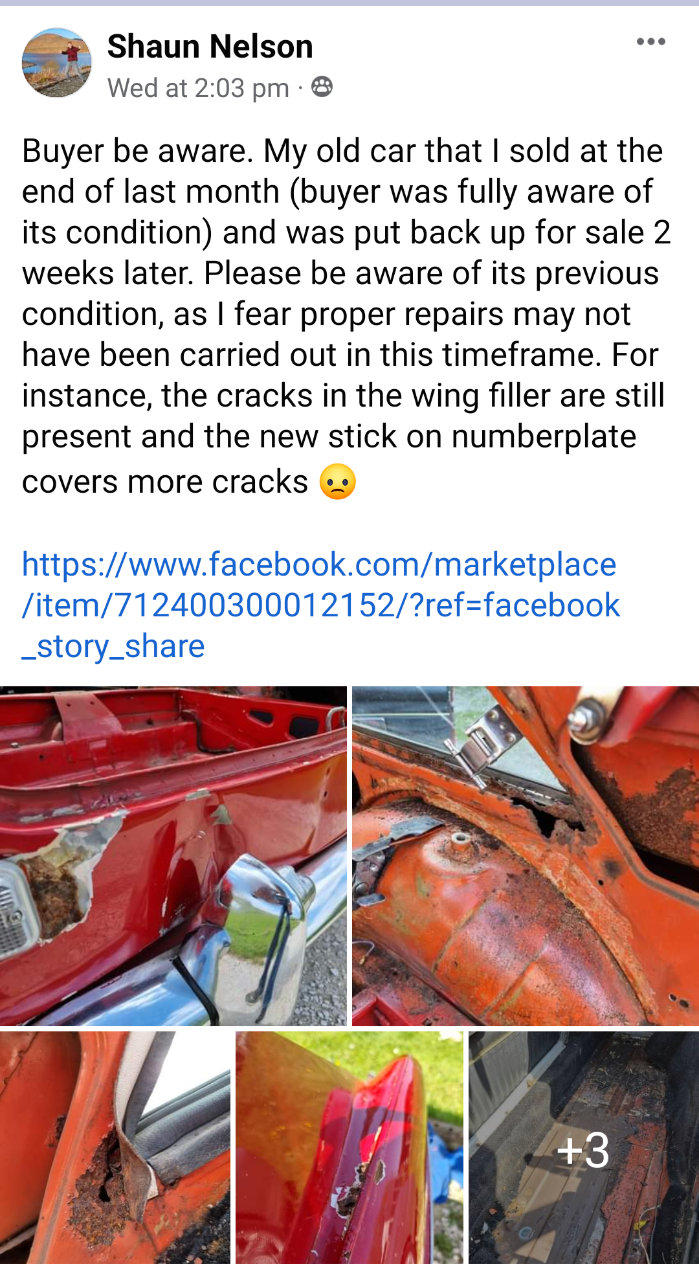

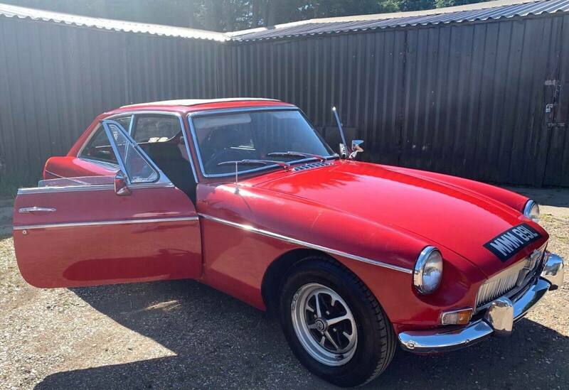

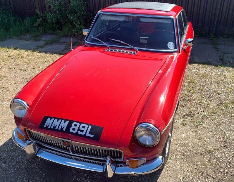

I think this is a good example that I saw the other day. Went from this:
FB_IMG_1654938639371.thumb.jpg.c4adb6bf8c9e77214448153b5974fc95.jpgFB_IMG_1654938636569.thumb.jpg.c1182d2201be8e12b2e7568e9f000583.jpgFB_IMG_1654938631869.thumb.jpg.f0a318b3c36b9a0e6ab5bf2d0119f96a.jpgFB_IMG_1654938629346.thumb.jpg.384354b25b53e1dc977875b6de4dffab.jpgFB_IMG_1654938626038.thumb.jpg.1c91c3b22a5391fa07cad3063b87242d.jpgFB_IMG_1654938620422.thumb.jpg.c545c463f0c32e2ecf1fa4eb2526ea4c.jpgFB_IMG_1654938634311.thumb.jpg.6bd1d35543fedc32a54f450dddf72c61.jpg
To this in 14 days.
619332088_s-l1600(3).thumb.jpg.dc34f1f0291bc8b6c7249d2c07462471.jpg1676250708_s-l1600(2).thumb.jpg.3e738a6fe39a59028386ea97ef12a161.jpg544320848_s-l1600(1).thumb.jpg.cd623ce3192a20b95ad0c12245df8da1.jpgs-l1600.thumb.jpg.7499199d961298b6d10de1cf849cb04c.jpg
https://www.ebay.co.uk/itm/125339383938
I mean it might have been done to a good standard in that time. But I'd be surprised.
It also went from £1200 to £4995 between those two sales.

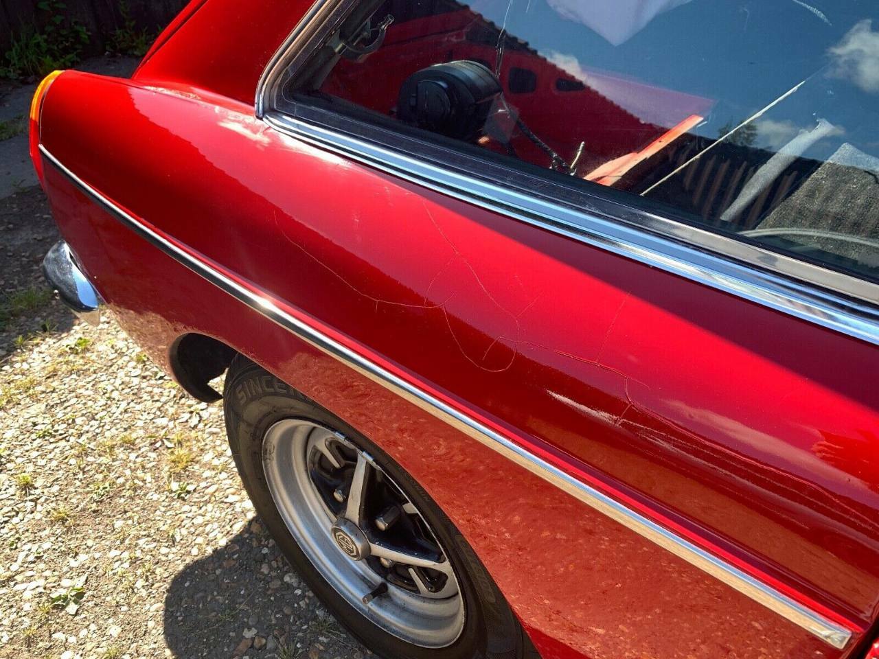

I've a very strong feeling that my MGB Roadster is exactly the same. I've had to weld quite a bit underneath that was wob and underseal.

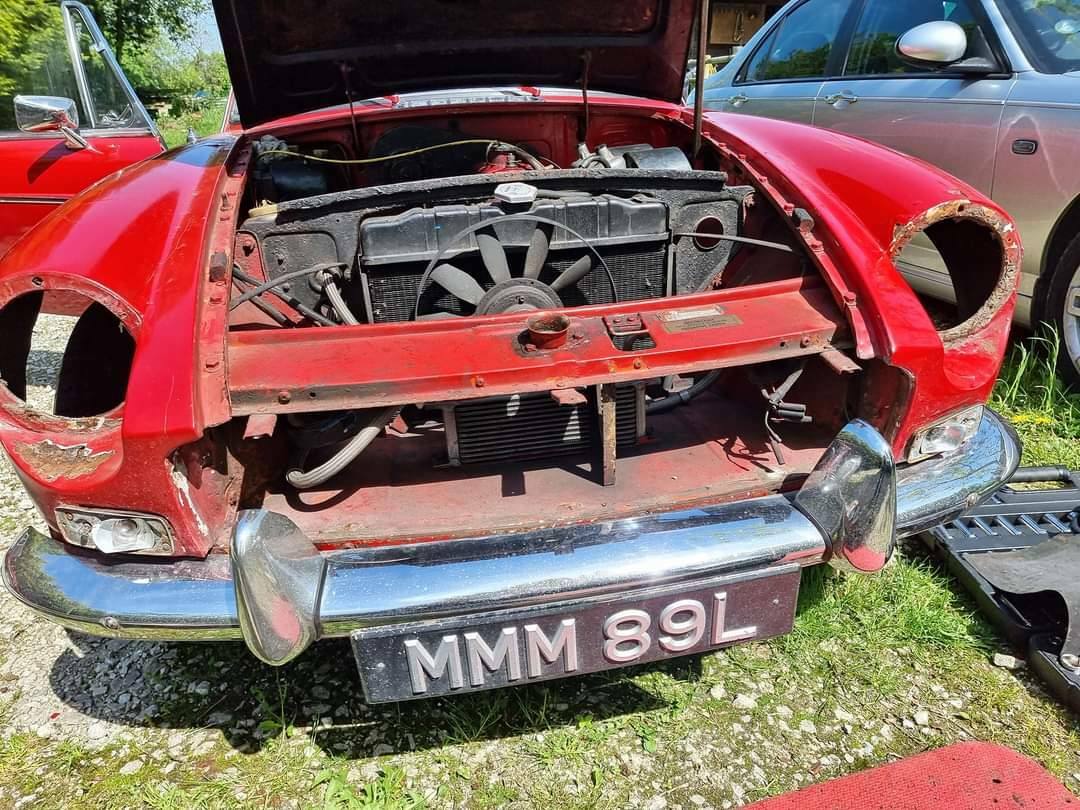

Turned into a fair bit of work that little motor, looks bang on now tho.
Thanks!
It's been an absolute joy to work on. Panels are easy to get, cheap (Ashley Hinton are a bargain) and excellent fit with virtually no reworking needed. Construction is simple and straightforward without many layers. Being a small car, pretty much everything is easily handled and clamped up within an arm's reach.
