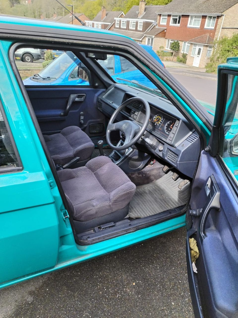

I’d forgotten how bad Favorit seats are. To punish the decadent Western bourgeoise, they put the hardest bit of the seat right beneath your coccyx.

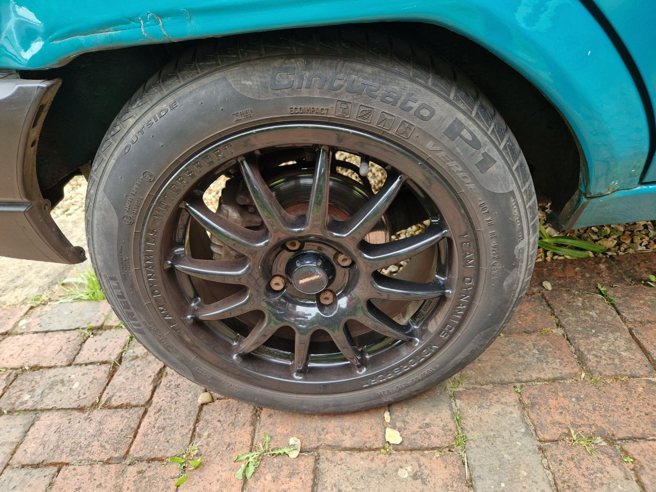

I’m also considering giving the tracking a bit more toe-in. It feels a bit wandery and I’m thinking a touch of toe-in might make it more stable on the straight ahead. Have we any geometry gurus on here?

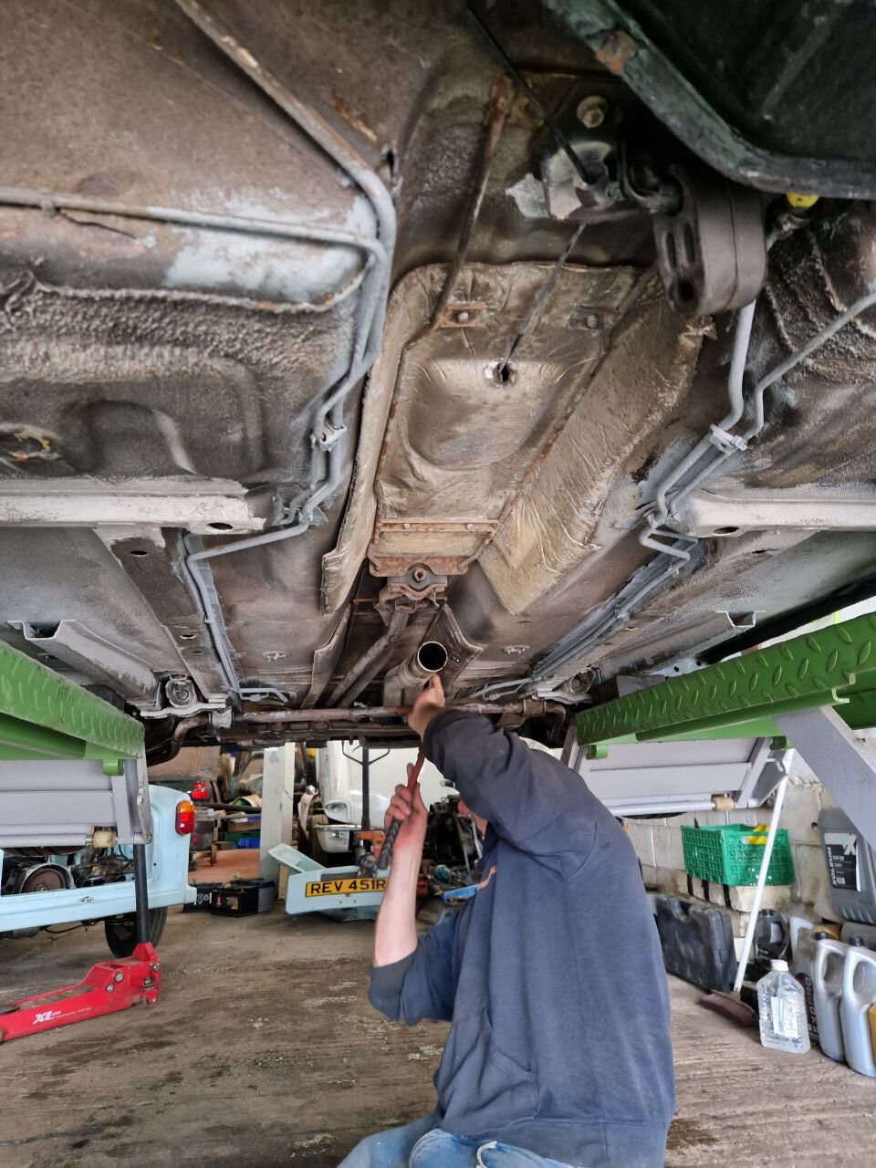

Then I did some more tinkering. I jacked it up, and on doing so I discovered how bloody awkward my driveway is for lifting a car. It is partially block paved but there are squares that have gravel in, so the surface isn't flat and it's a PITA for the jack and axle stands. 20250516_164109.jpg.8e689bf5f74946300f6509e7ce1b85ce.jpg

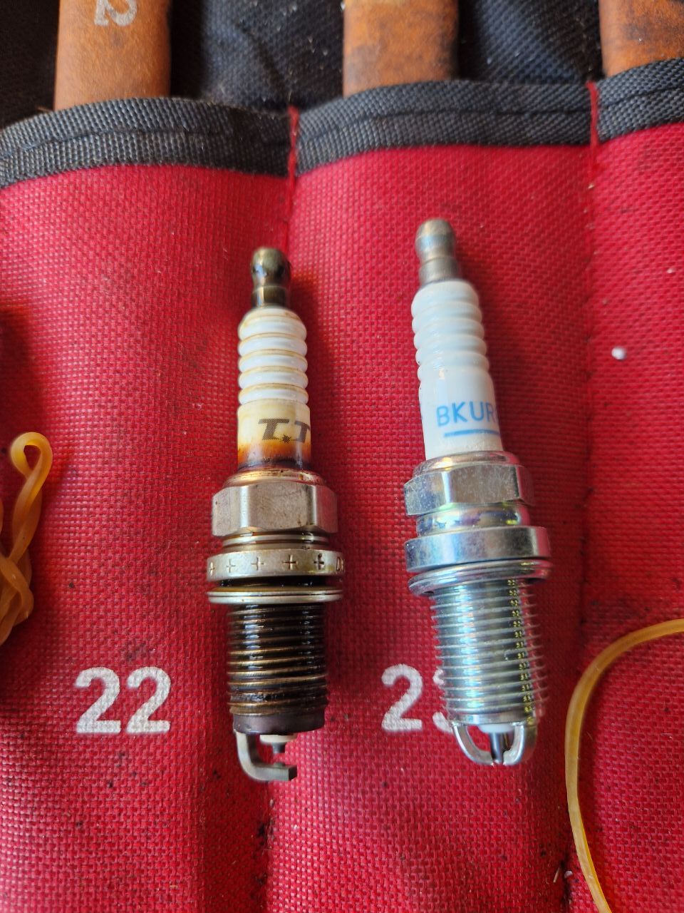

Changed the oil which looked pretty dark, and threw in a set of plugs. Different to the ones I took out (which also looked tired) but 3 electrodes is more than 1 so they must* be better. 20250516_173814.jpg.d20e5b80505f844c48c1dd9794dea3f7.jpg

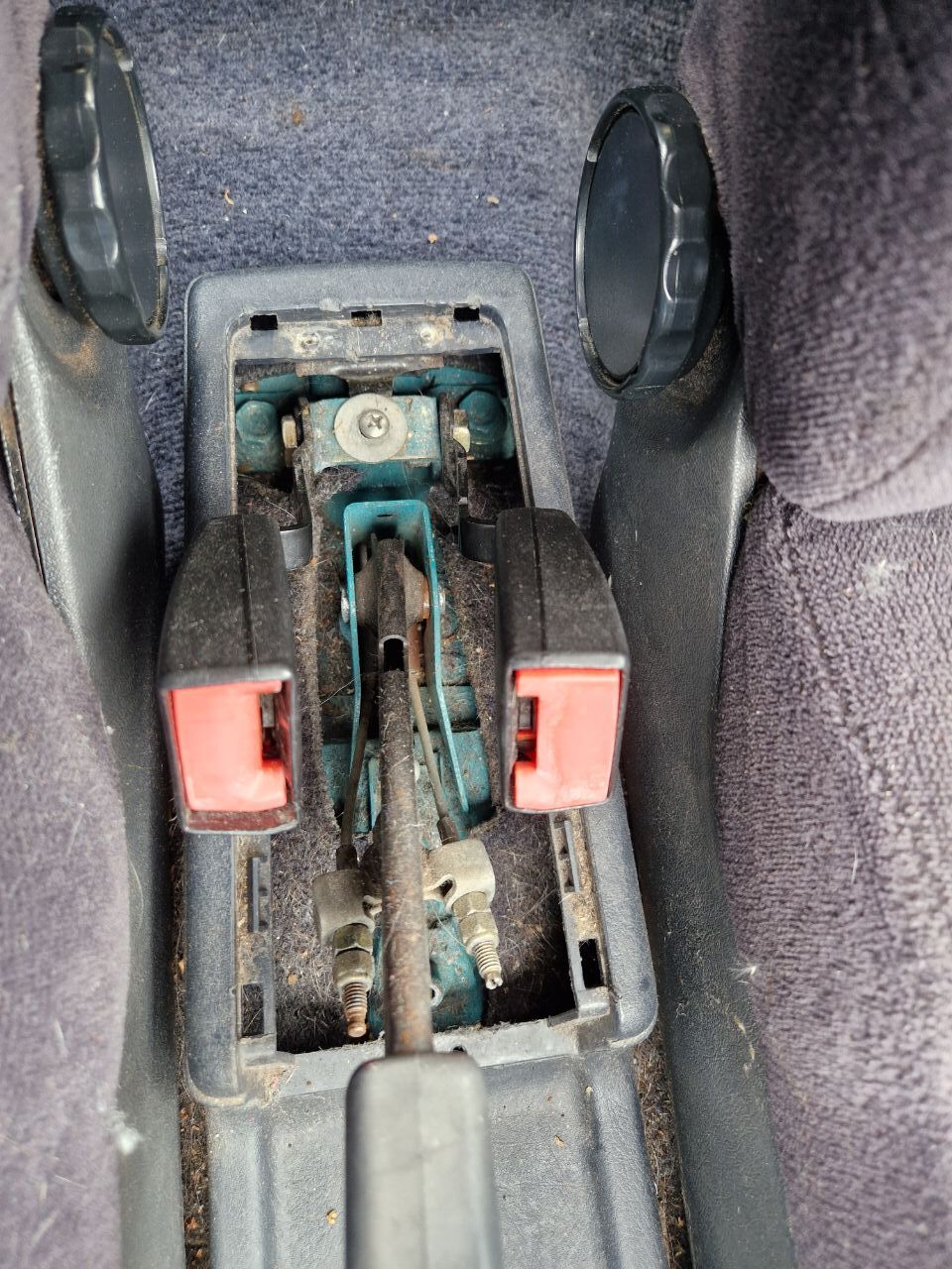

Yesterday I also swapped the seat belt stalks around. They were set so that the release button was on the inside of strap which annoyed me enough to change them. Now they sort of 'clash' in the middle, so they're one in front of the other but it's safe enough and mot man won't care. 20250515_162629.jpg.d9d1edb258c8fc2a1ef03e49add1f9ad.jpg

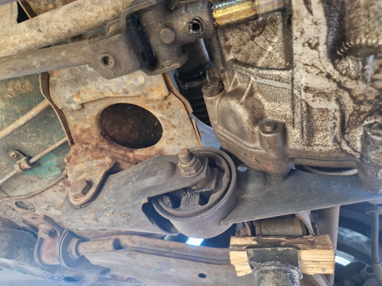

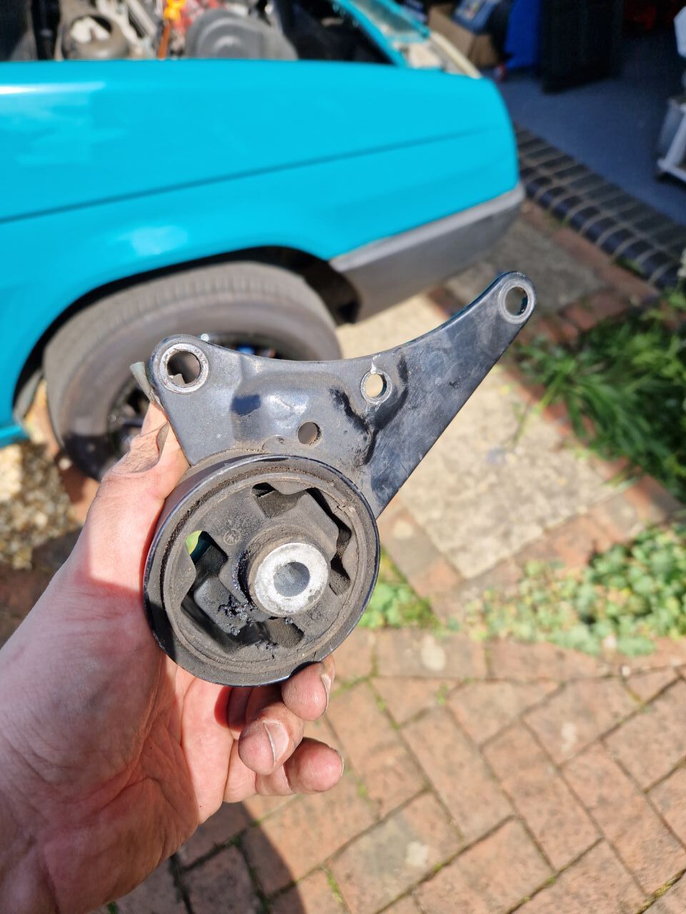

I've ordered a new gearbox mount for the Skoda, the existing one looked a bit ropey and has probably suffered trying to restrain the massive* torque of the VW engine.
Plus it was only £17 and looks easy enough to bolt on.

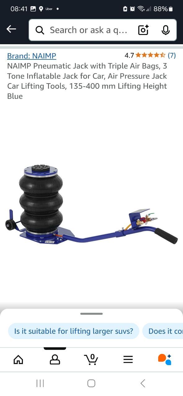

I've also treated myself to a pneumatic jack, mainly because my 'normal' jack is a PITA to manoeuvre around the drive but also because it's leaking vital fluids so I think it's kaput.

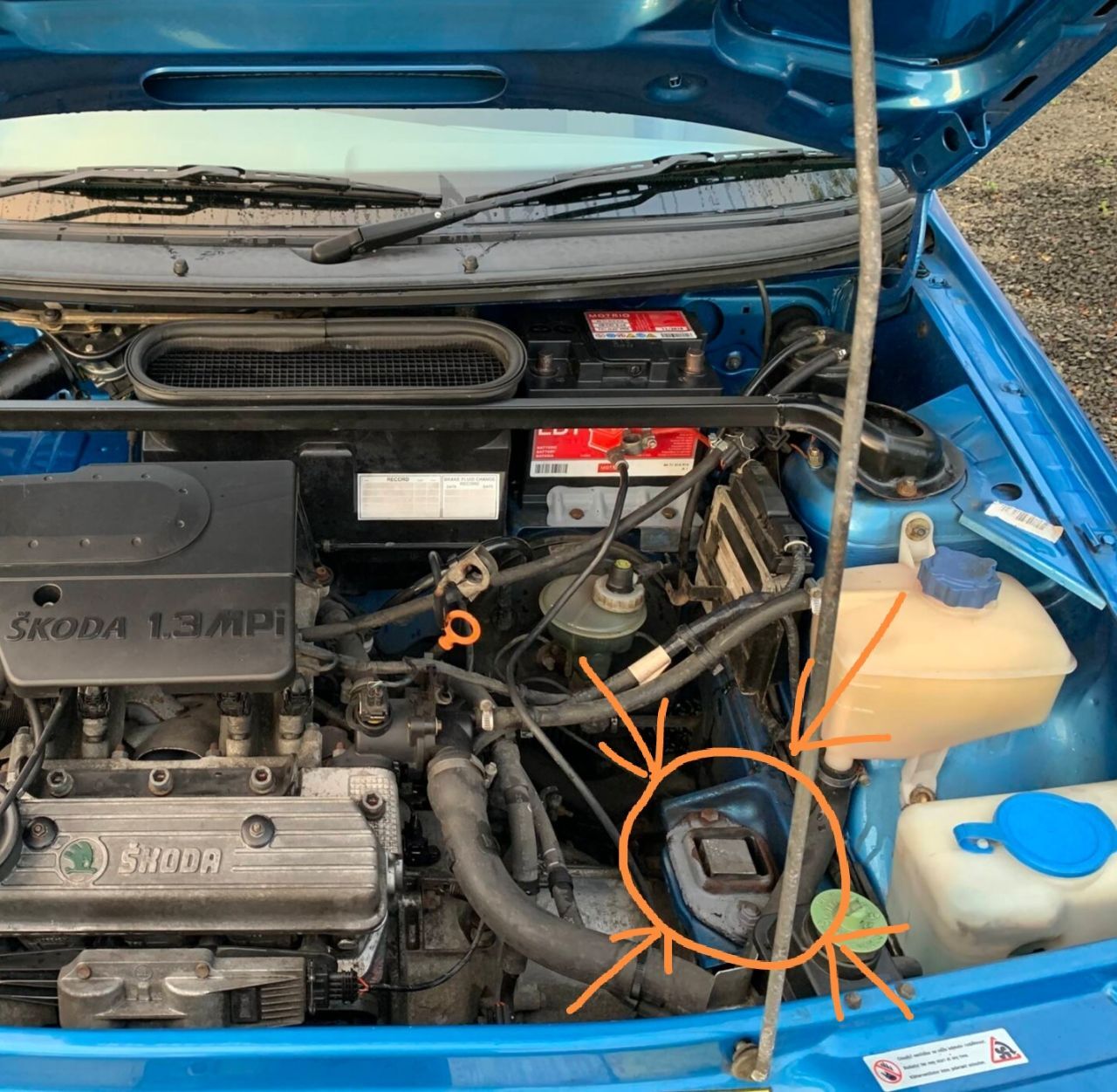

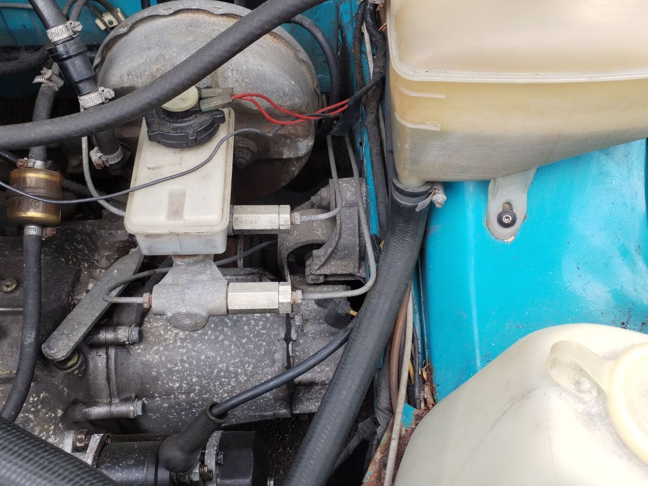

It can't hurt as it's a cheap and an easy swap but most of the work is done by the upper mount and it's not really up to the job. Even Škoda knew this and modified it for the Felicia, even the lowly 1.3.
I've just taken these pictures of mine. You can see it under the brake lines.

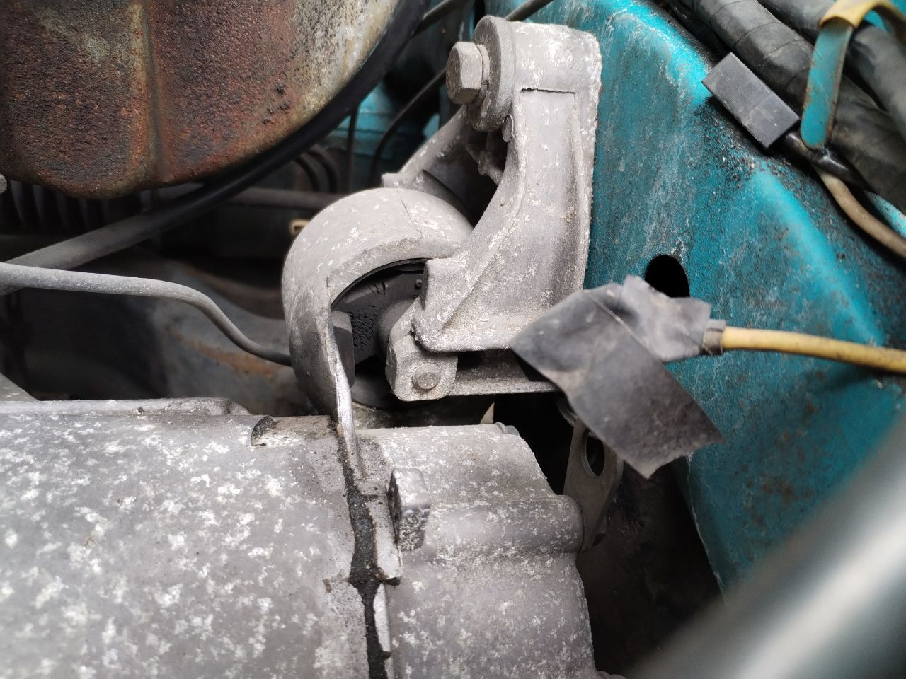

Closer.  The rubber bush sits in a round hole that is part of the gearbox end housing.
But the Felicia has this big square lump on top of the hole for the bush.
And this sits in a bracket with a square hole in it. This is lined with rubber pads that limit the forward and backwards movement as the engine rocks.
These are all freely available. Unfortunately that square plate with hole in is mounted to an extra bracket that has been welded on to the chassis leg.
946CCB3E-1A80-4E44-B1D1-CFF6484D4700.jpeg.1d1e12d55a9f941fdaabace3502f5bdf_edit_1819537033299595.jpg.d77f6e959c21e0d9ef50a32f002a01ba.jpg
So unless you have a scrap Felicia lying around it's not going to happen unfortunately. Which is why I ended up jamming extra bits of rubber in between the existing mount. Crude but effective.

All later Felicias had strut braces and I think it coincides with when they started fitting anti roll bars. But it doesn't say much for the rigidity of the bodies because Škoda wouldn't fit them if they didn't think they were essential would they?

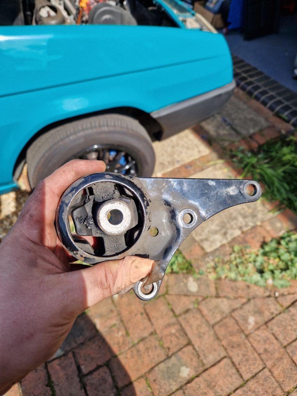

Well I didn't get very far yesterday but I did tackle the gearbox mount that was pretty tired. 20250523_153721.jpg.e3c797485f89ae6c9e7d6171cffa4840.jpg20250523_153727.jpg.5216163ace548c18ab894554fa554c05.jpg
The one I fitted seemed to have a different 'offset' but it sort of fit, plus it's rubber anyway, so it's fine*.

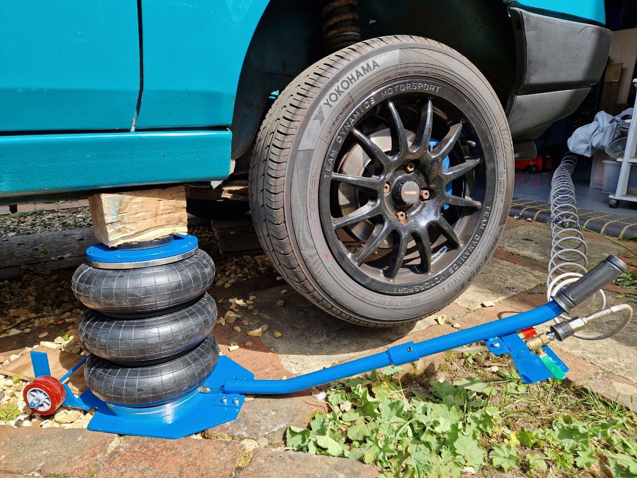

I lifted the car using my new air jack. It's a lot bigger than I expected, this is good and bad. Good because it's sturdy but bad because it's sometimes hard to get an axle stand in where it's needed while the jack is in place. 20250523_152026.jpg.dd7364c680f8873896a1d68747878992.jpg

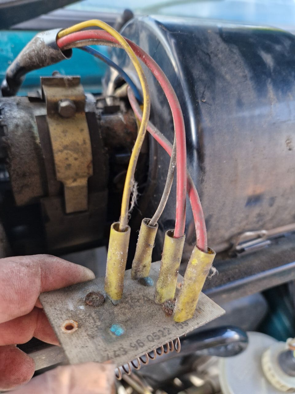

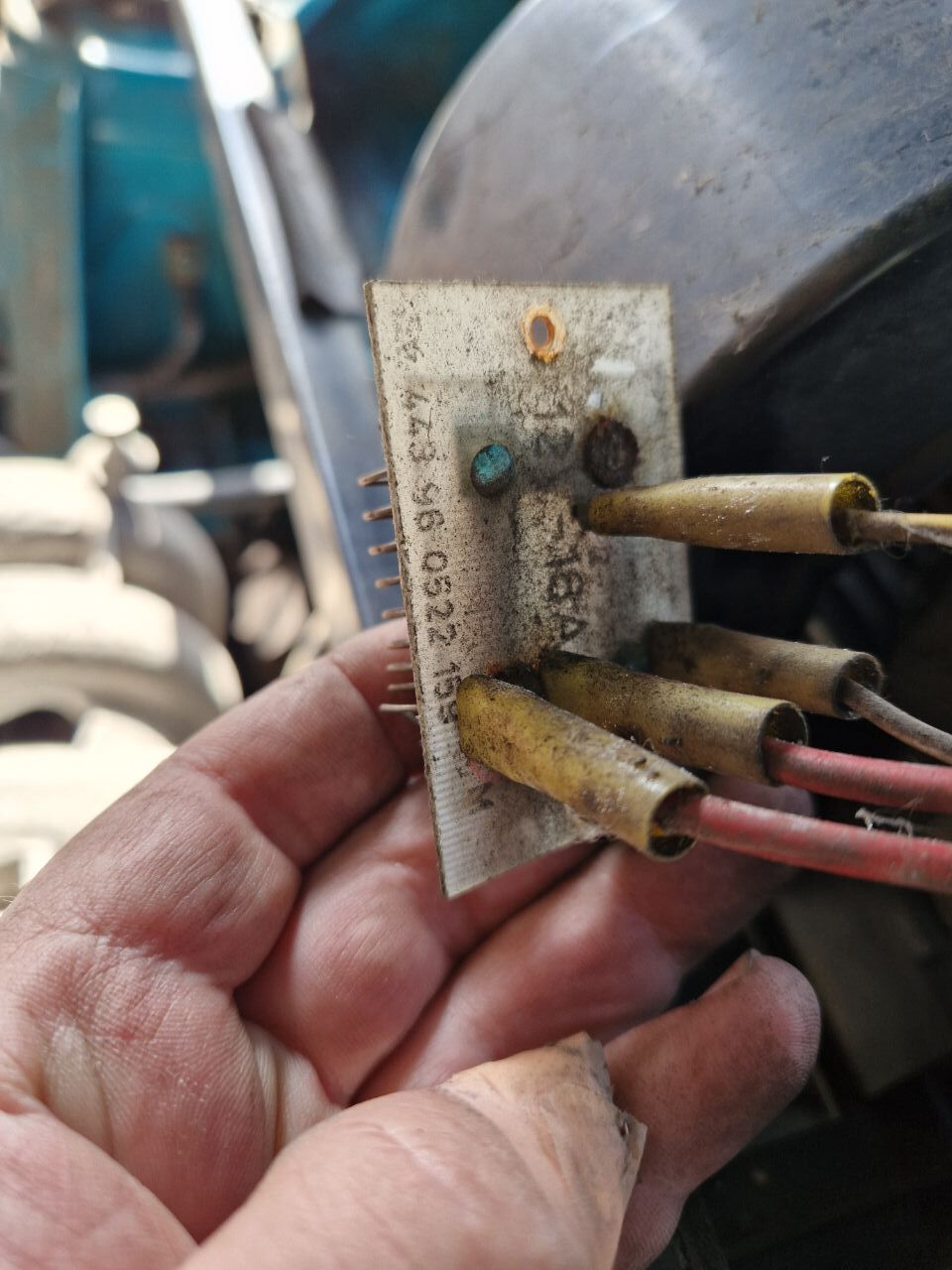

I also pulled the dash apart for shits and giggles, I'm looking for an ignition feed for the radio. The fan must have one because it only works with ignition on.
Also I pulled out the heater blower to get at the resistor. It was pretty crusty so I cleaned it up and refitted it. 20250523_164944.jpg.82c7f3f91a95d12a0adf7aa38f4b8f19.jpg20250523_165647.jpg.664ff44c1192640587bcfd7e1ad00bbd.jpg
Before: fan only works on 3 (12v straight to motor).
After: fan works on 1, 2 and 3, BUT... it's always on max setting no matter where the switch is (off is still off, though).
Weird. I do have a Felicia fan resistor which I could wire in if I could work out the pins.
The HBoL was no help at all, it completely lied about getting the motor out by forgetting to mention the two nuts that hold it to the car. And the electrical diagram was total shit, bad photocopy, too small with stuff missed off the page. Twats.

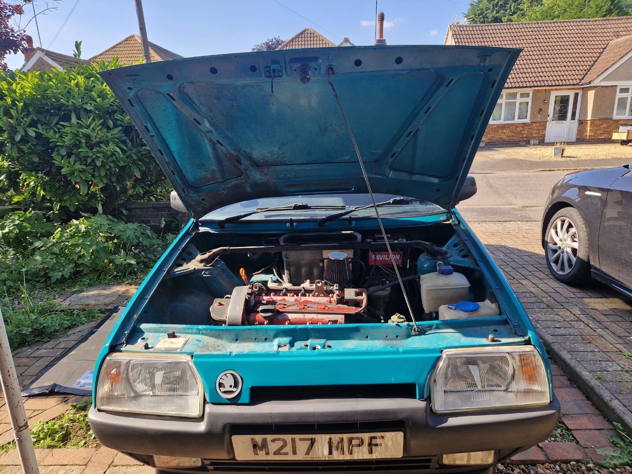

Skoda FTP! I got into it this morning with the intention of shuffling the Skoda into my Southam lockup and bring the Maestro home.
But it doesn't run. It starts, fires up but immediately dies.
On Friday I was a bit concerned about a stray bare ended wire flapping about near the battery area. I think I might have dislodged this when I removed the battery to tinker with the heater fan. The wire also had a bit of heatshrink over it, suggesting it was once attached somewhere. 20250527_091225.jpg.d67cf892904f4e5601b9e226ac95bba1.jpg
The non-running behaviour feels like the ECU is looking for a "I am running" signal, and if it doesn't see it, it shuts down again.
Next step will be to see if there is a signal or 12v on this wire in the various ignition positions.
There's nothing obviously amiss with the other wires but I need to pull out those fuses and stuff to have a proper look at the wiring around there.

The loud exhaust on the Maestro was driving me spare so I took the plunge on a Moto-Build one. Disappointingly, it was shown as £275ish on the website but that turned into £320 when I placed an order. Screenshot_20250527_193521_Chrome.jpg.9b6e6d5f87d7b7d3efa2ca03fb667f2d.jpg
It was actually a bit of a faff getting it, poor communication from the seller and probably two months of messaging back and forth before I actually received the product.
On the plus side, it seemed nicely made with decent quality welds and reinforcements between the silencers and the pipes.
Unfortunately it didn't fit. I am kind of used to this, most exhausts I've tried to fit have needed some tweaking, but this wasn't really viable. The centre silencer was a hard foul to the exhaust tunnel, so that wouldn't have helped the noise problem.
Andy first tried heating and bending it but that didn't work so he broke out the big guns. There was a donor bit of exhaust bend in the spares pile so he chopped this up and used it to splice a three piece set of collars and pipes that could be nudged around to get a good position, then tacked, then removed from under the car and properly welded.
Annoying that we had to resort to this type of surgery on a so-called performance part, but Andy did an absolutely magical job splicing the bits together. 20250527_160059.jpg.43d1a1d02a67ba2da0f4c9ebf6069560.jpg
While all this prep was going on, I used the opportunity of Car Raised Off Ground to drain the oil.
Unfortunately one of the oil containers I'd brought was full of shite old oil and acetone, instead of nice fresh 10W40 I thought it contained. Luckily Andy had a drum of the same Mannoil stuff and could donate the couple of litres I needed.
Check out the NOS oil filter! AC Delco - remember them? 20250527_153227.jpg.c177daa4e79af1c2ae699d8a64edeb2b.jpg
The results? Night and day! I can hear myself think, I can hear the radio and I don't need earplugs to drive the damn thing. Thank you so much Andy, it's been transformed!
Want a cutoff? Still quite a few around in scrappies over here, and shipping shouldn’t be too bad. It looks like 10 minute grinder job.
That's very kind, I may take you up on that.
I'd like to see how my home-made upper torque mount goes first, I've bought some bits for it. The cheapest, shittest mount I could find. Next will be a series of ball joints and links which will look very much like a bodge but will actually be fine engineering...
