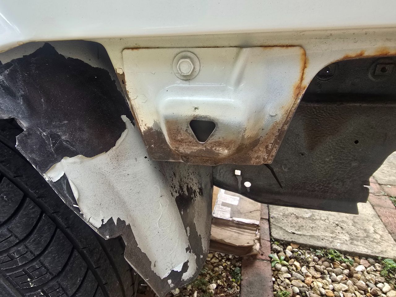

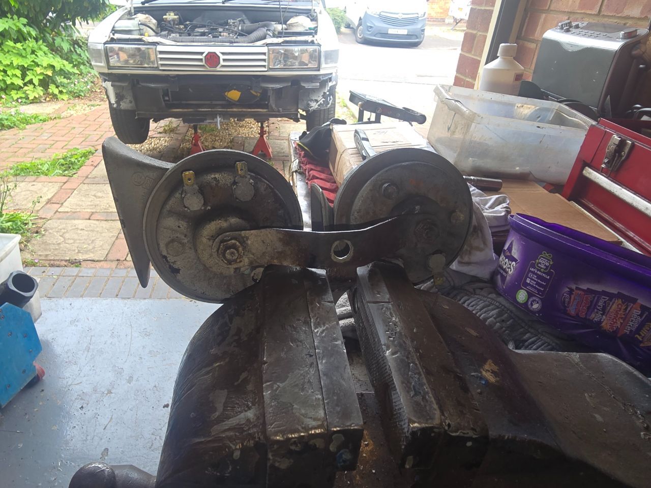

This weekend, I are be mostly taking the front bumper off the Maestro. 20260529_105424.jpg.86594384628990444755668f0fdba07c.jpg
Why?
Because it was a bit floppy and lopsided. One side was held on with a cunningly hidden cable tie, but it was a bodge I wanted to repair properly.
Of course, the job turned into a mini front end restoration, but that's OK, it's nice weather and light evenings.

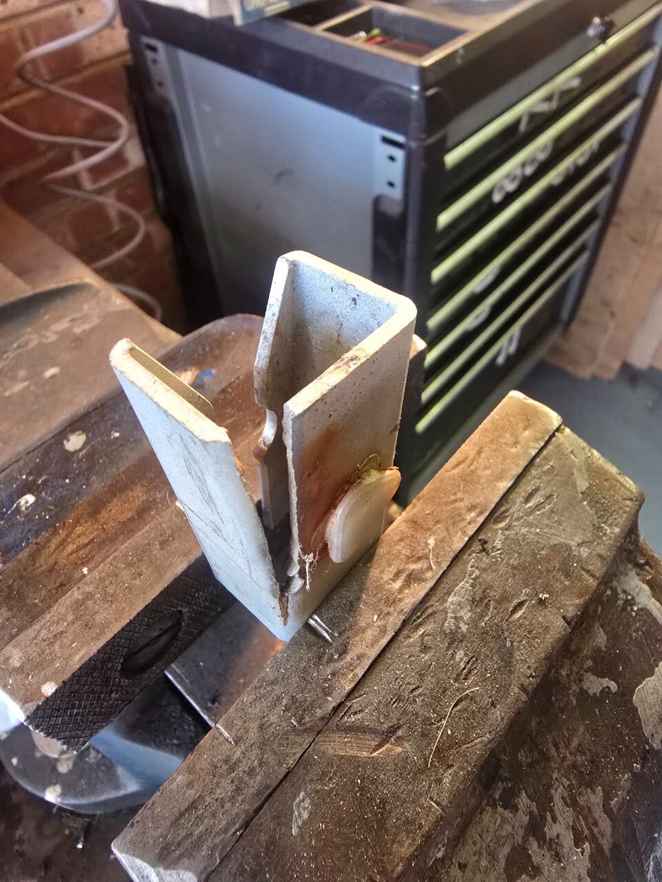

The culprit was these bumper clips. It's had a small prang in the past and there's evidence of a bumper repair, it's not bad though and invisible from the outside. But these clips are of course NLA so I had to make the best of them. 20260529_105403.jpg.4b6dde12be87994d3c8d1991f74bfbfd.jpg20260529_105356.jpg.7db64be3e21b1add47bd1d1d6c9ba2f1.jpg
I did attempt a glue repair but it wasn't very successful so I ended up using cable ties to strengthen the clips. Fortunately I was able to swap left and right sides around, so the bumper pegs now rest on non-bent bits of clip, which means the bumper sits straight on the car.
I did a couple of coats of zinc primer on any vulnerable bits. It's actually pretty good back there for 38 years old, and I only needed to wire brush/vactan the bumper clip mounts. 20260529_105411.jpg.b596f3c2c6ff43c0854ab0a48dcc53e1.jpg20260529_105417.jpg.d8fa623ece9c02f5f64e13a2f9f2355b.jpg
Pleased to find a manly dual tone horn hiding in the nearside front. The bracket got a touch up and a new bolt. 20260529_130005.jpg.806c23d3c0a5e6821c89f3d54a509400.jpg
The bumper tubes also got a fresh lick of paint.

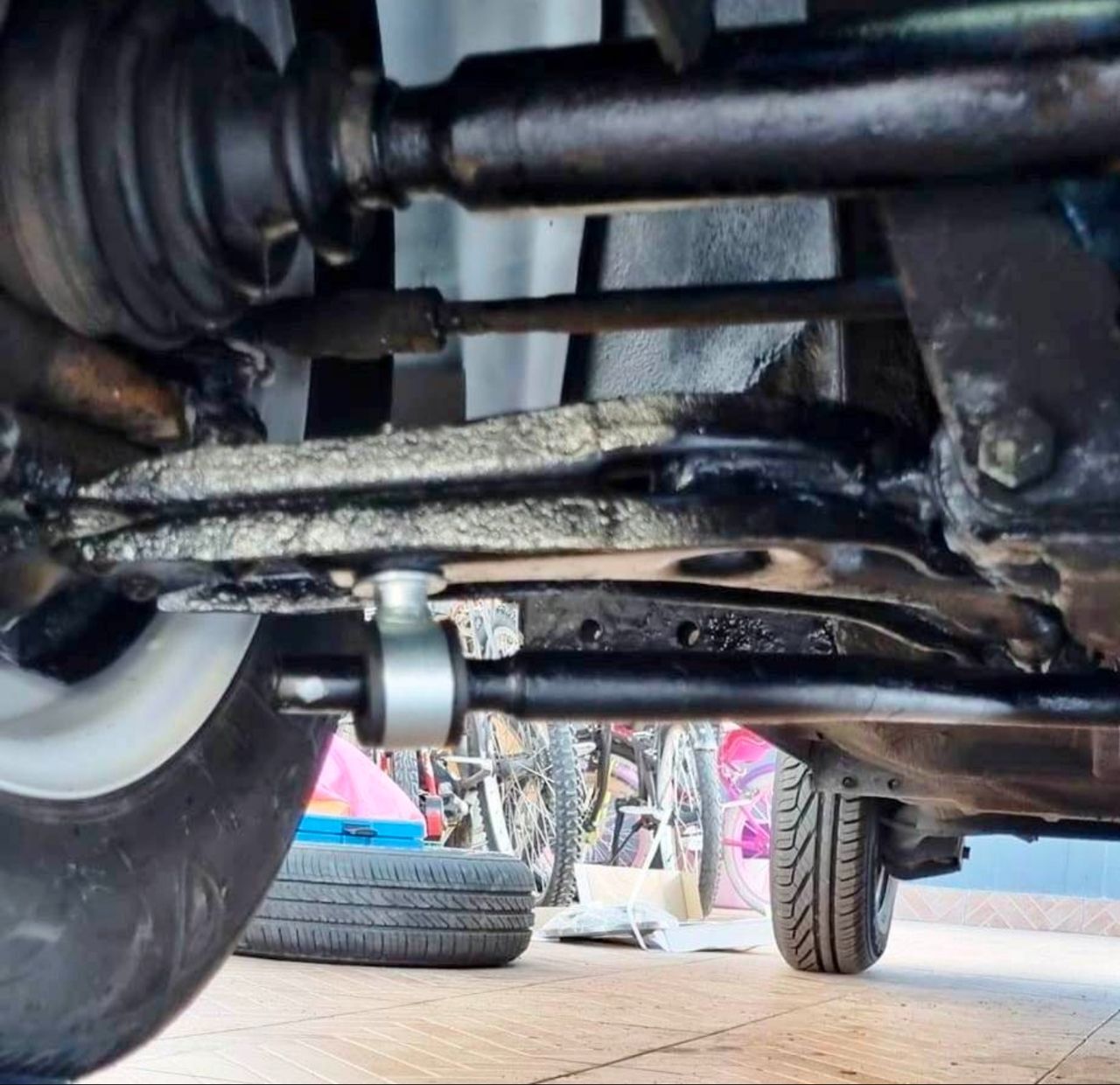

There is apparently a workaround using Golf mk1 parts. This is no surprise since BL put the Golf through its photocopier when designing the Maestro.
However it needs some cylindrical shims to make this work so I haven't actually got round to doing it yet.
(Pic is not my car, taken from the M&M nerd forum)

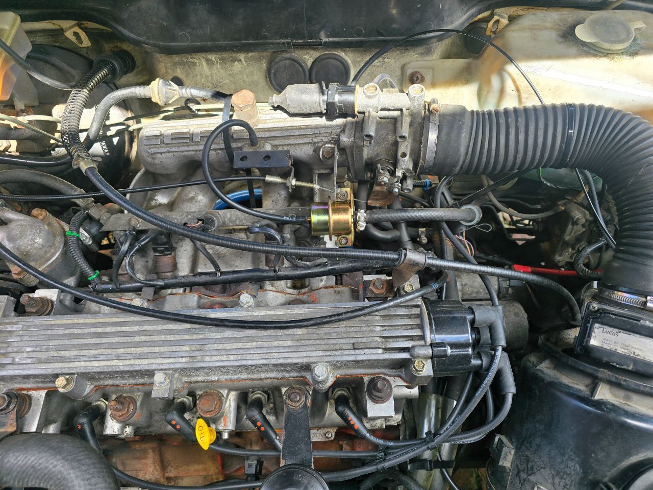

Been using the Maestro a bit because "Monty" the Mondeo is poorly with a squeaky wheel bearing, to be dealt with tomorrow if the stars align.
Felt pretty smug that I'd got to the bottom of the idling-stalling problem. Then just as I was approaching home on Friday, it gone dun conked out at traffic lights.
You bastard. It'll be getting the Cleese birch branch treatment before long.

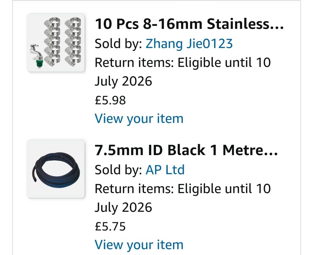

Given that the replacement fuel pressure regulator looked as crusty as the one it replaced, maybe I'm just unlucky and it's failed again (not E5 compatible, probably).

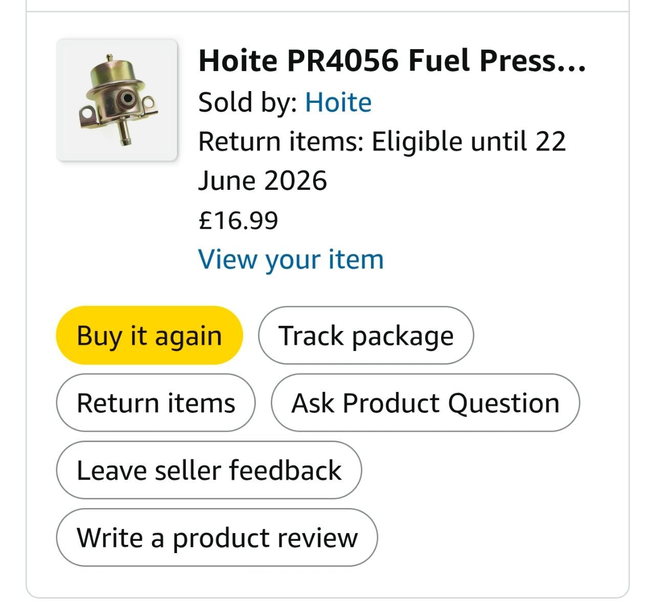

Next step is to fit the Volvo 240 FPR I'd bought as a fallback. It needs a bit of fettling as the standard return pipe has a weird metal tube that hooks onto the throttle body, which has a union to the FPR. But the Volvo one has a 8mm barbed end for a flexible pipe. I can fix this with a new length of fuel pipe to the fixed steel return line, which I've now purchased. Stainless hose clips because MASTER TECHNICIAN.

Fitted the FPR. I was going to replace the return hose but I felt lazy and couldn't be bothered to stretch through all the brake pipes to remove the clip on the flexible pipe to the metal return line.
Fashioned an anti-chafe solution with a bit of plastic hose, as it has to run a different route to the old setup now.20260613_114444.jpg.f21a2e6ce917f5ab14a108ef36f93247.jpg

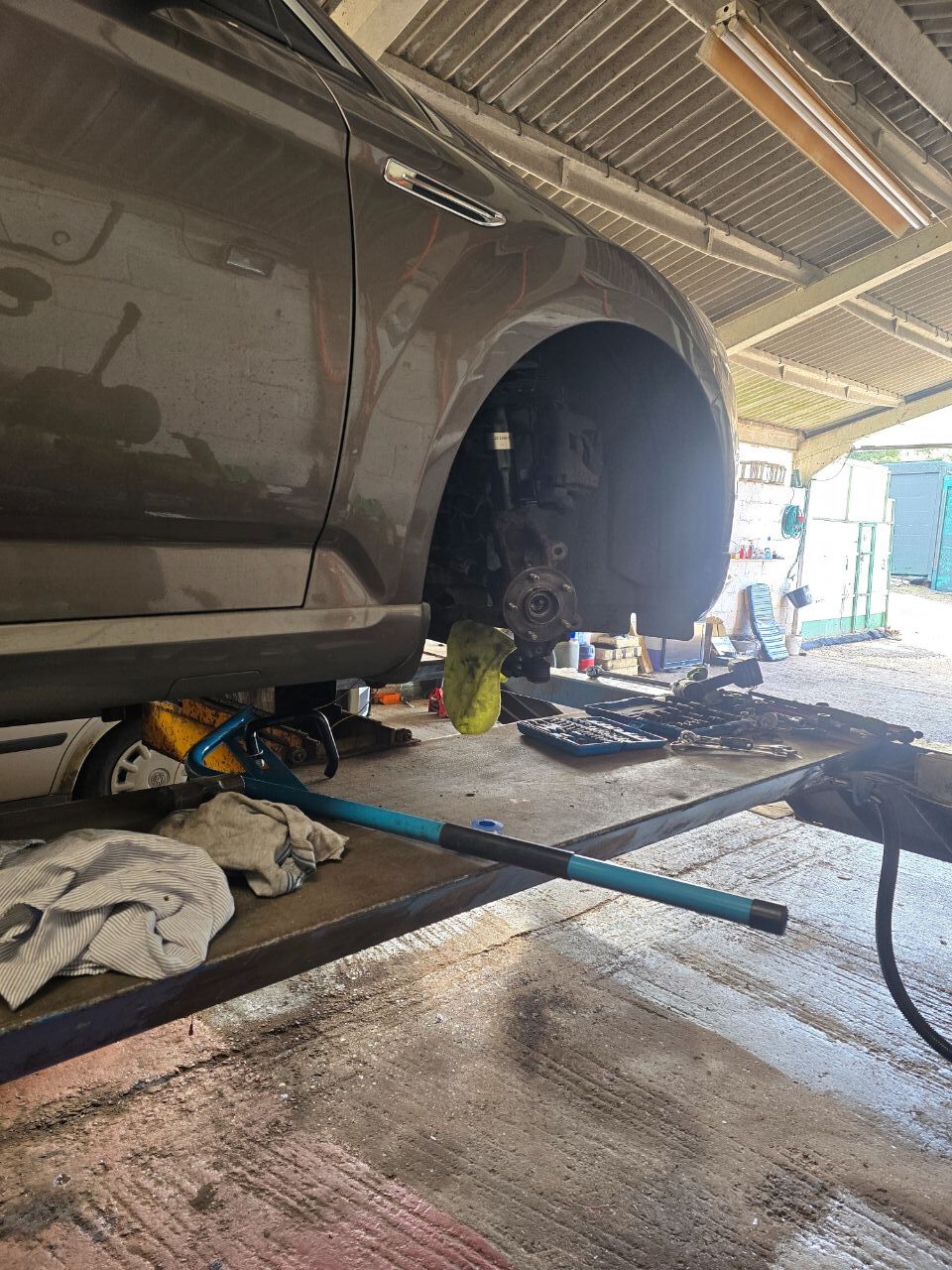

Today I took the Mondeo to @Andyrew for OSF suspension surgery.
Although I paid A Garage to fit the new shock, the old wheel bearing was screeching. And the driveshaft was still stuck in the hub.
So having bought every conceivable spare part, we attacked the old bits.
The knuckle, hub and wheel bearing had to come out together.
I'm ashamed to say that the new wheel bearing I'd pressed into the new knuckle wasn't pressed in far enough, so we had issues when reassembling... Then an ABS light, then a complete meltdown & limp mode when the transmission got confused due to no wheel speed input.
Fortunately, thanks to Andy's considerable expertise, he spotted my schoolboy error and managed to disassemble the knuckle and fully press home the hub/bearing.
Normal service resumed and I'm hoping to not touch the Mondeo for a while now. Famous last words.

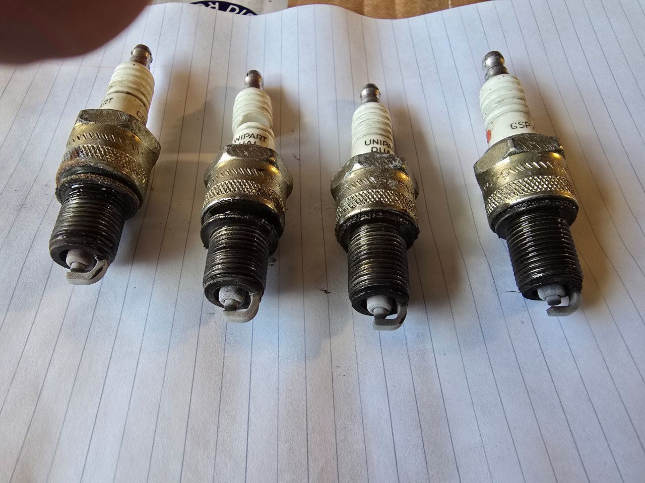

I took them out to have a look and see if it's running rich with the non-standard FPR.
They look OK to me but I'd welcome other opinions. 20260619_180703.jpg.5aa6c41b85f974d7e51bc57f9add2614.jpg
Of course, I mullered one of them while removing it. Luckily I had a spare set ready to go, so it's been treated to new plugs anyway. Screenshot_20260619_195722_Gallery.jpg.64956c74793deba9367f405a6c3a1d90.jpg
Went for a long-ish drive today in the sunshine and it performed almost faultlessly. I lost the indicators for some reason, so apologies to the traffic around me this afternoon.
Having experienced this problem before, I knew to give the hazard switch a few presses to clean the contacts. I think there's something moisture-sensitive in there that goes FUBAR after a year or two.

Good to hear that it looks as though you've sorted the running problems (hope I haven't jinxed anything by saying that!). Hope you have a good run to Lincs for the show.

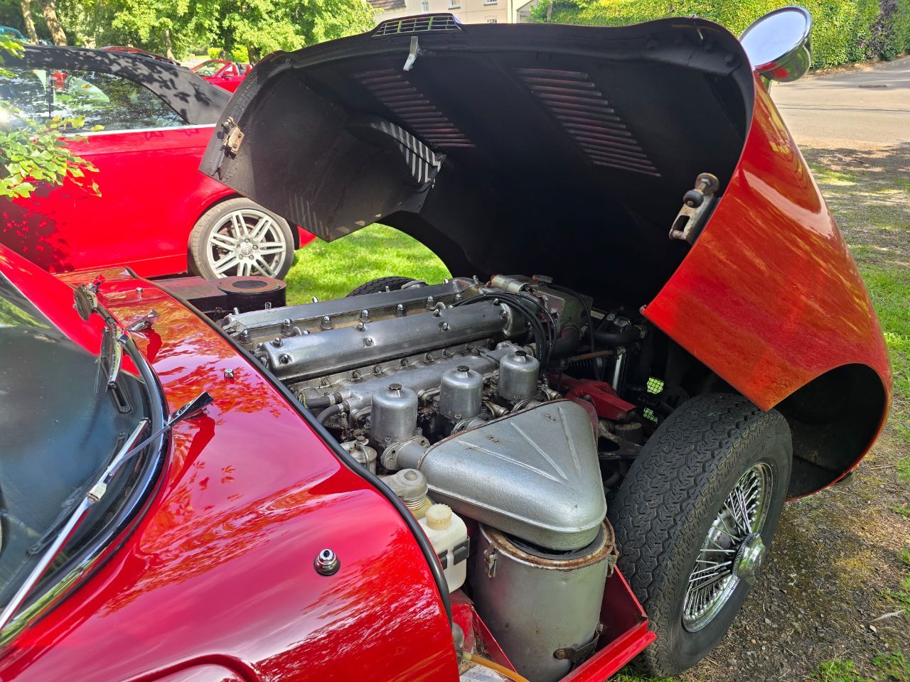

E-type with bonnet in summer mode20260621_163945.jpg.a0ca91e1cabd911ce271a5ab83602d0e.jpg20260621_163956.jpg.2688e2bc170f519961acf662e65ef48f.jpg

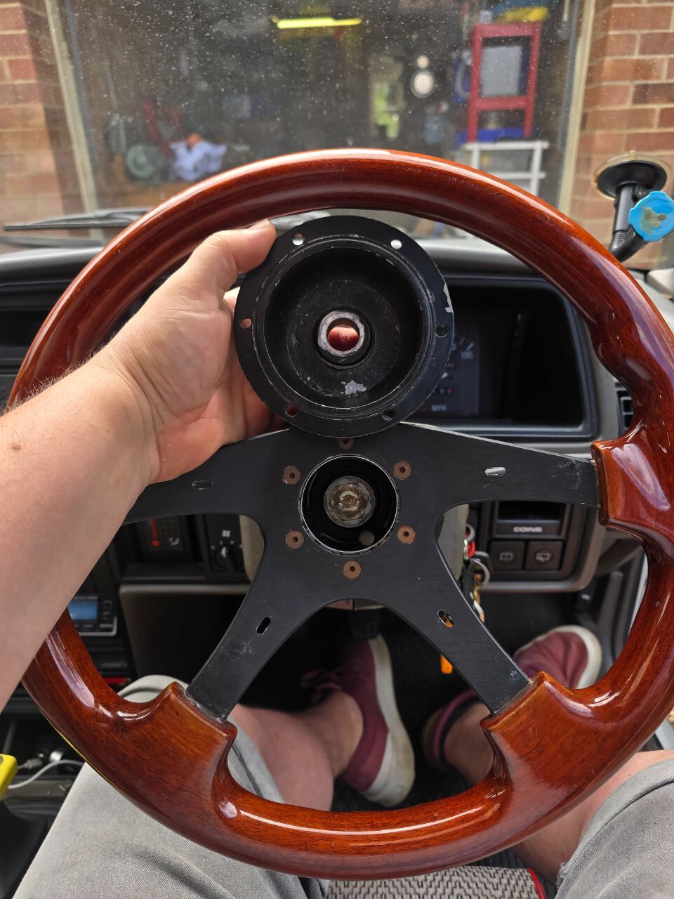

Like a knob, I'd assumed all steering wheel bosses have the same PCD for fitting whatever wheel. Wrong! 20260628_120937.jpg.d5398adcb8113b761490875433fe7073.jpg
Luckily the wheel I bought just happens to fit the spline pattern on the Maestro. Maybe it came from something else British?
I like it, I do like the feel of firm wood on my palms. I've filled the centre hole with a matt black blanking plug, so it looks better now.
I know there will be haters but I've kept the original and it's a 2 min job to change. Nu_Mrs Grogee is buying me a wooden knob to go with it.

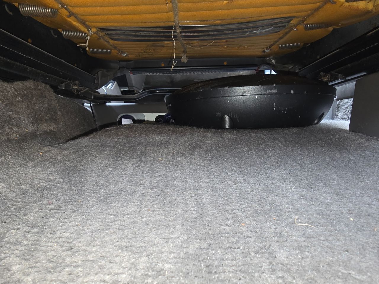

Bought this under-seat sub from the car boot thread (thanks @Imhotep) and finally got round to fitting it. 20260630_191553.jpg.ef3a514a003acdabd46e214f822dc693.jpg
Not straightforward, I took both front seats out and lifted the carpets to get the relevant power and signal wiring under the driver's seat. Had to fit a little junction box thing for the battery wire which is also feeding the rear amp that drives 6x9s on the parcel shelf.

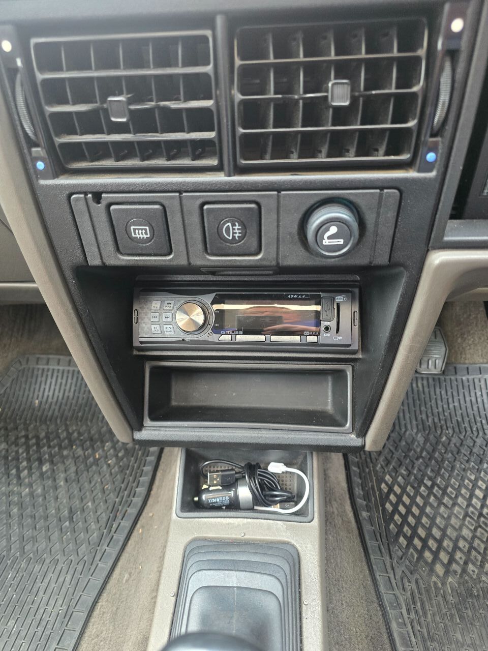

Once that was done I was able to fit another birthday present, this time from my stepdad. I really wanted one of those period-look units like @Skcat bought, but this was a budget option (£40) that does the same thing but doesn't look as nice. If you squint though, it sort of looks like an old Alpine... maybe. 20260630_191355.jpg.1485e3d7f253573cdbbbe2ae6fbd68c4.jpg
It's a shallow unit and quite lightweight but it enabled me to ditch all sorts of outdated gadgetry that was filling the footwell. So the old Parrot handsfree has gone, as well as a Digitizor DAB tuner that squirts DAB into the FM antenna (I have one of these in the Mondeo as well).
I've also ditched the heavy subwoofer that lived in the boot. Sounded good but I didn't like the look of it when opening the boot - I'm 51, not 15.

It deffo looks a bit like a 90s Alpine. I thought that's what it was until I zoomed in.
That steering wheel boss is a Mountney I think. A 13" Mountney wheel and dodgy column drop bracket were the first things I used to fit in any Mini.
Your wooden wonder reminds me of the sort you used to see in 'customised' Merc 190s. A nice upgrade though.
I’m actually sad that you’ve changed the wheel. Originality is what I like but it’s your car and your choice.
