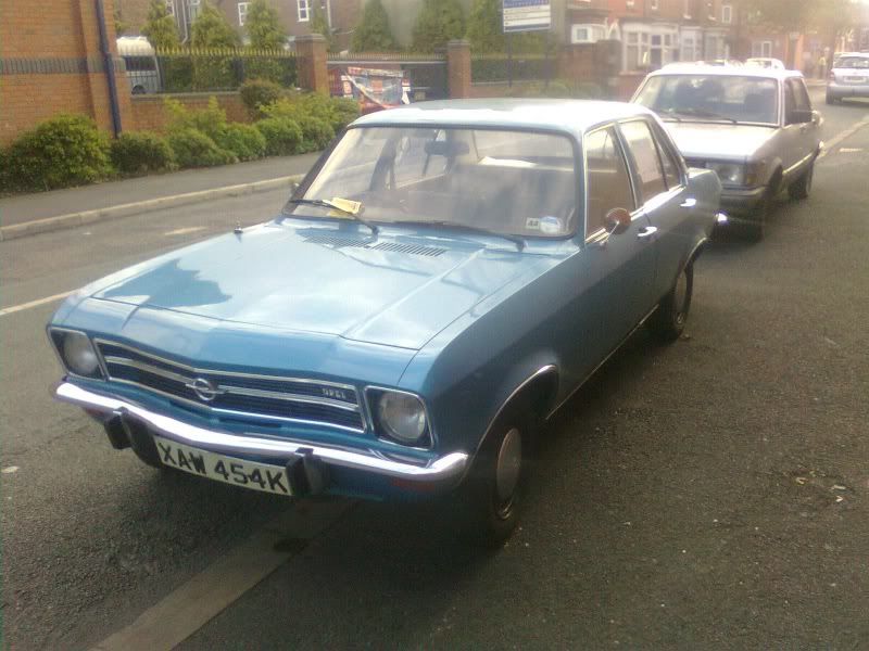

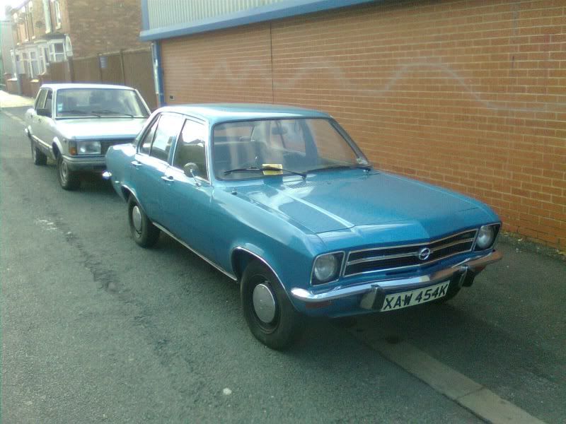

Look at this sweetie I spotted today in Crewe!
Its £2750 if anyone from Ipswich is interested. Seems a tad salty to me, its very nice alright but has a bit of wobbage behind the rear wheels that they could have done a better job on prior to painting (cos it seems like a pretty decent paint job), the rest of it appears very straight however.
