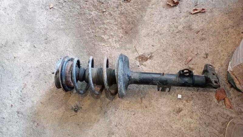

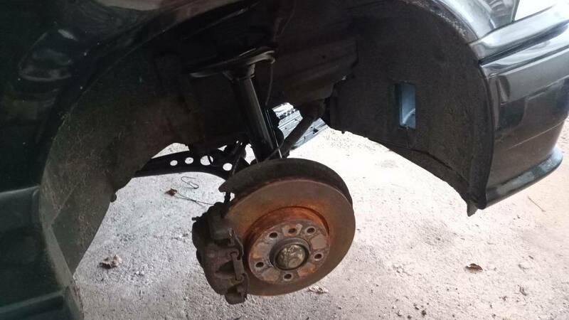

Swapped ends today.
That strut came out without much of a fight.
I'm getting ahead of myself. I still need to ask the mechanic neighbour to assemble my new struts with his grown up spring compressors.
I'm stopping here before doing the passenger side.
Aha.
The problems arrived today instead.
I thought I'd at least loosen the bolts on the passenger side strut. The top bolt on the hub isn't budging.

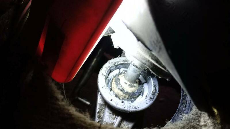

I soaked it in GT85 then crawled under the car and unclipped the linkage below the gear stick.
Apparently you can insert two flathead screwdrivers in opposite slots and unscrew the plastic bearing it sits in. It won't budge either, plus I can't seem to reassemble things to potentially move the car elsewhere either.
Joy.
I'll look at it again another time. Had one of those moments where you just down tools and walk away from it.

Slow progress is still progress. Both struts out now.
Definitely past due. The top bearings have noticeable play in them, and the front shocks just felt dead in the way it drove.

Any tips on doing the plastic bearing directly under the gear stick? The Haynes book says to put two screwdrivers into opposing slots and turn it quarter a turn anti clockwise. Yeah... No. It won't budge. I have a replacement so I'm tempted to get violent.

For the collar, it’s the same. BMW TIS recommends a special tool (obviously), however they say to turn anti clockwise from below, so maybe it’s clockwise from above?
I've been turning it anti clockwise from below already. As per the Haynes.
I don't want to buy a special tool...!

Working from above with a screwdriver and a hammer worked!
Smashed up old one removed:
New one in.
I have successfully removed the inch of vertical travel in the gear stick. Plus, 5th gear no longer occupies the same space as my left knee.

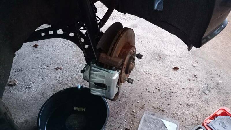

I'll do the other caliper later.

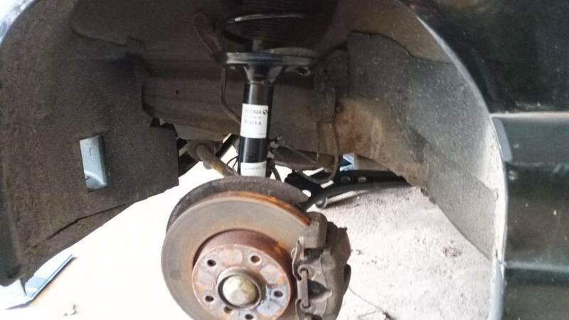

At least both struts are in now.
The discs look awful at first glance but they're fairly new. Just been sat outside without moving for a couple of months. A few good stomps should sort them, hopefully.

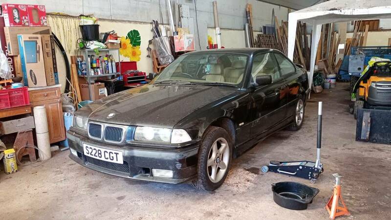

As a side thought: this is going to be the freshest E36 I've ever experienced once I'm finished.
Making good progress on this.
Look forward to it hitting the roads again and putting a smile on your face.
  • Agree 1
I'm pooped!
Front struts: done.
Front calipers: done and bled.
Still need to crawl under it and bleed the clutch, but that can wait for another day.

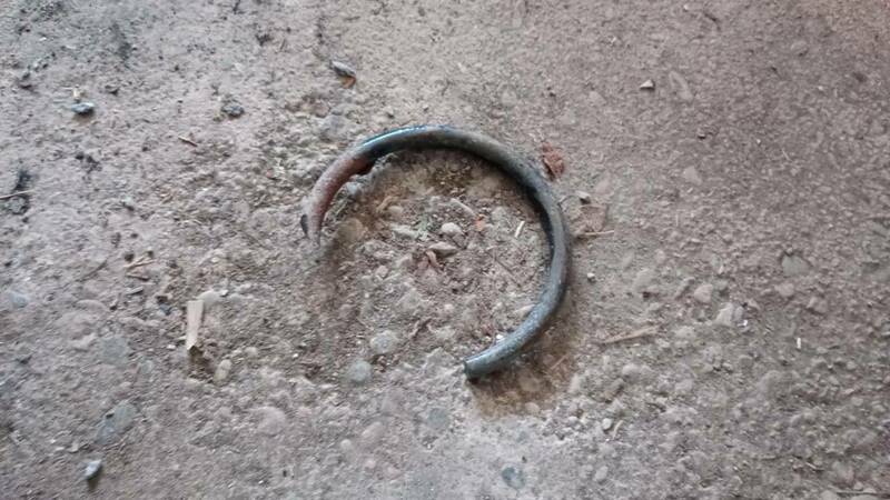

I remembered that the viscous coupling I fitted in 2022 wasn't brand new, but was second hand.
Brand new one ordered, plus a water pump pulley because the one in there had actual chunks missing from it!
