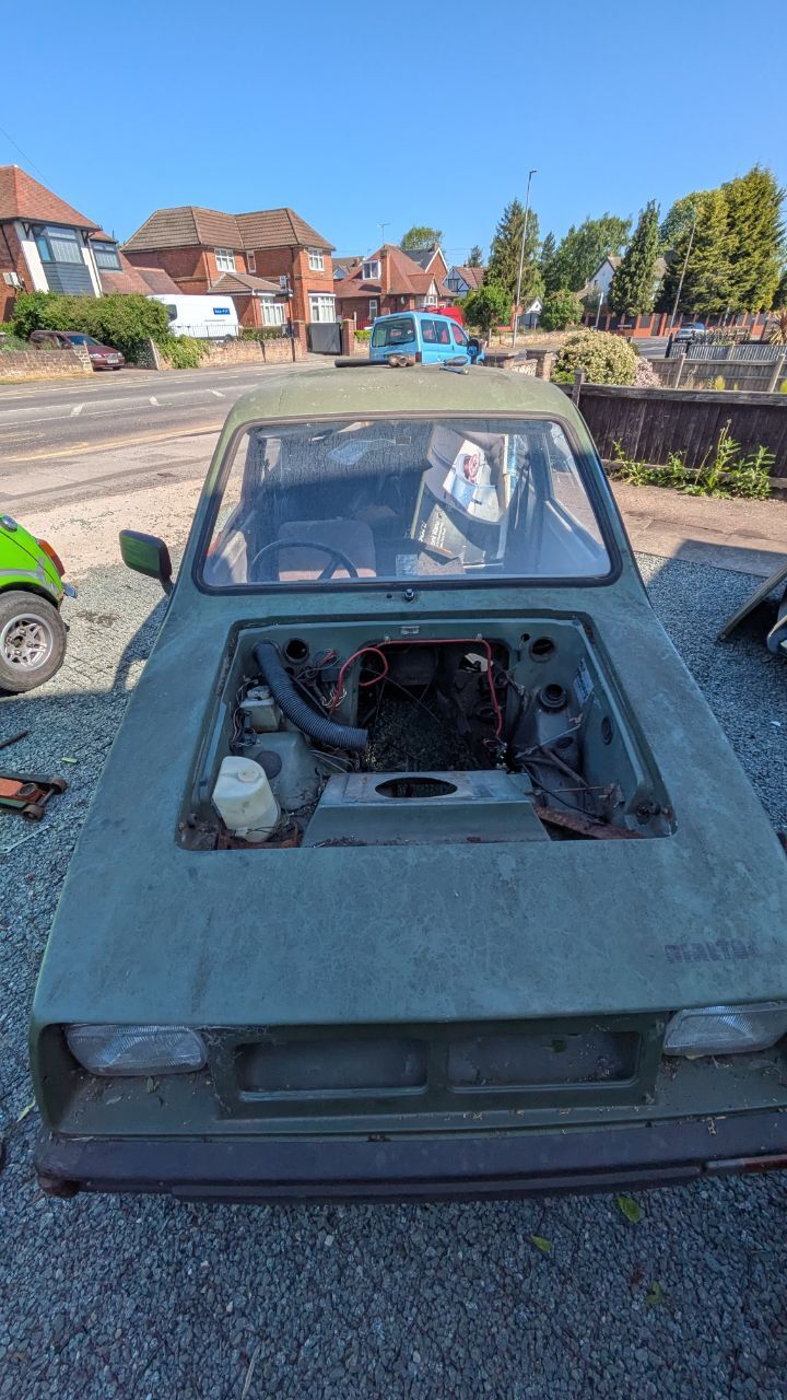

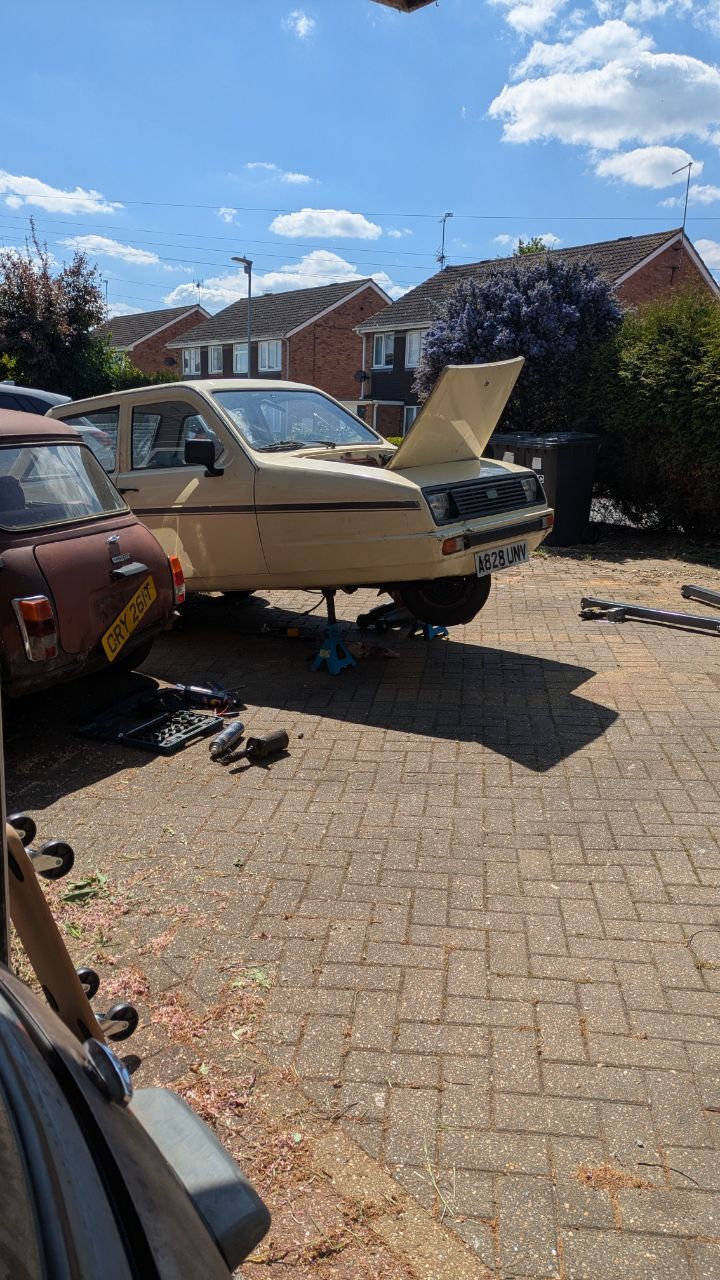

Today I did not have fun... I removed my Reliant engine in scorching heat.
First I rearranged my drive a bit
Then set to removing the engine. The prop bolts are a pain. They're nowhere near accessible but I did get them out with a pair of spanners. Then undid the engine mounts and removed the clutch cable. Unfortunately I had to cut it so I need a new cable
Finally I undid the gearbox mounts and it basically fell out

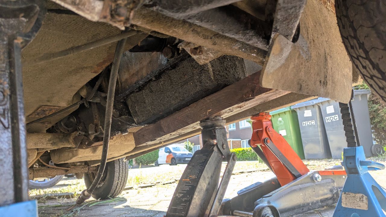

Then I had to lift the body higher to slide the engine out. I definitely didn't* jack the car up under the tyre
And she's free
I found my old core plug...

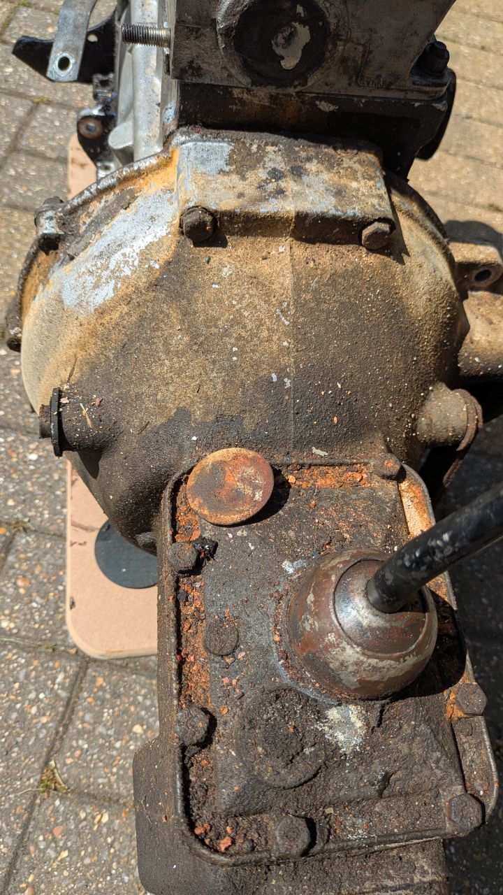

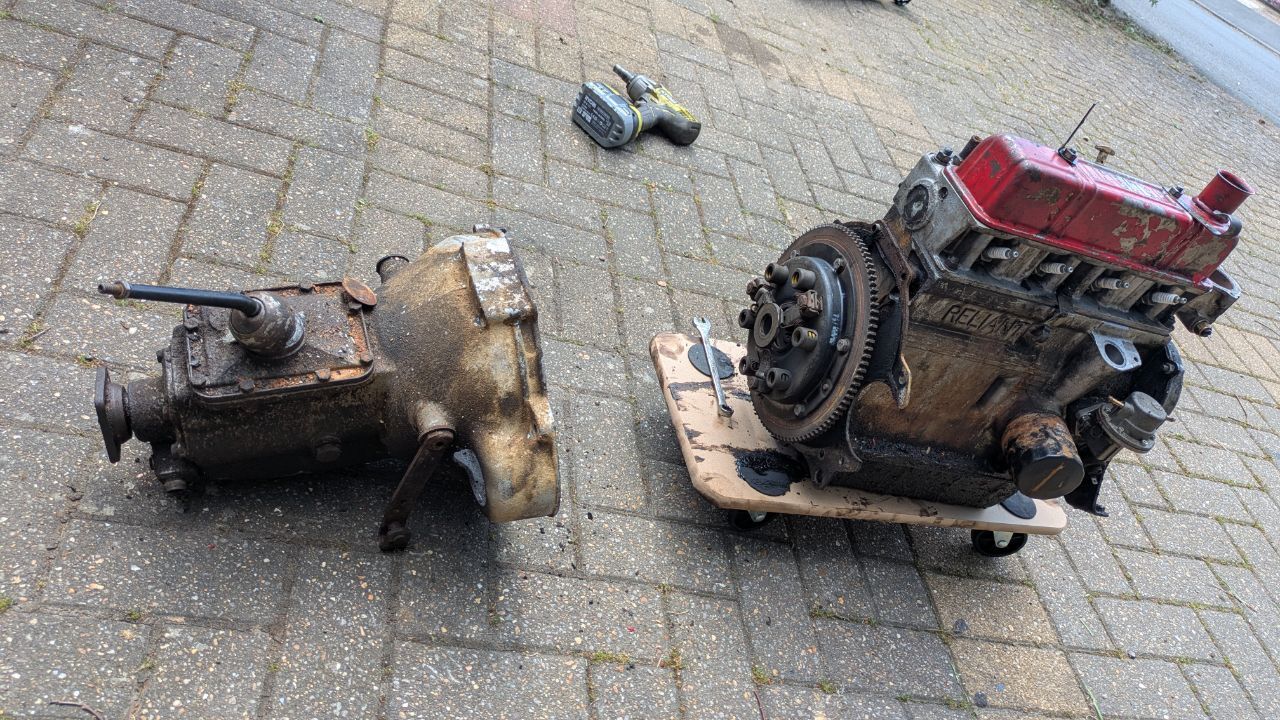

Finally I split the gearbox off to check the clutch. Thankfully there's plenty of life but they have a carbon thrust washer on the arm and that is well and truly worn out
I am not looking forward to putting the new engine back in. Lifting it back in place from underneath is going to be a pain even with an engine crane. However I do at least know roughly what I'm doing to get it back in

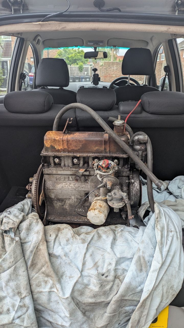

New* engine collected. This came out of a running driving car and it fit perfectly in the back of the car.
Thanks to this victim and @sharley17194 for sorting me out

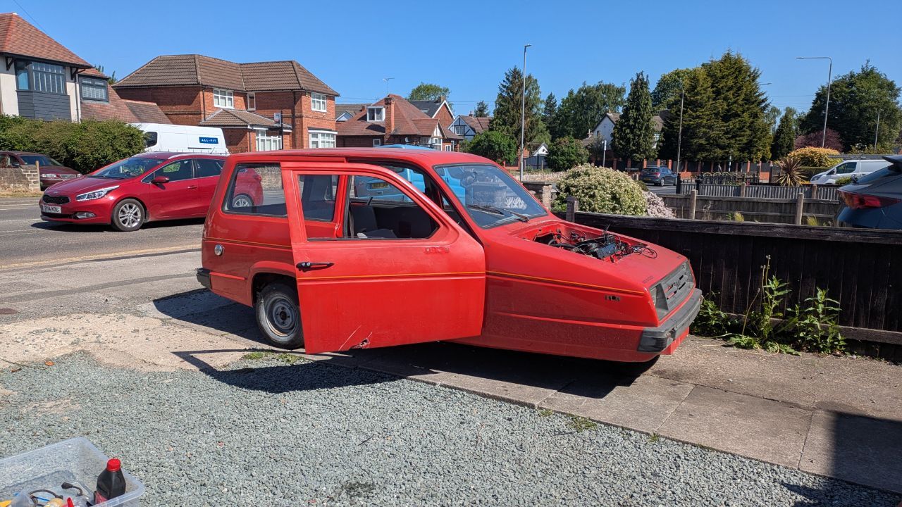

While I was collecting the engine we set to doing some work on @sharley17194 Reliant which is in a very kit car state. We managed to get a horn, wiper motor, headlights, tail lights, and indicators but there's still some bad earth's on the indicators. I did also whip up a brake line and proceeded to fit the wrong brake unions to the line I had made 😅
Notable mention to the car we took to Germany last year. Parked in a hedge which pretty much sums up this car. Still sporting my expert gaffa tape skills.

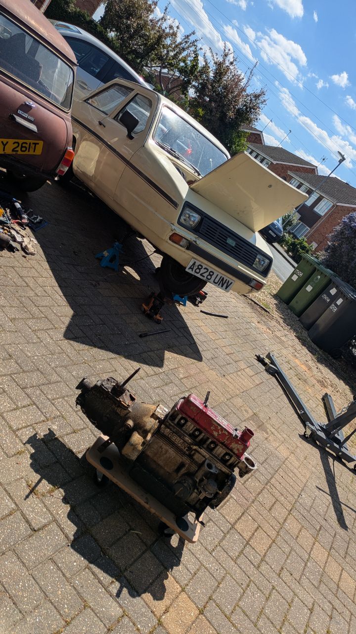

After purchasing my new* engine I spent some time over this weekend prepping and fitting it.
First off I needed to transfer some bit's over from the old engine and reattach the gearbox. I also took the opportunity to set the tappets as it's much easier out the car and then I fitted new engine mounts and also changed the thrust bearing which is carbon and wears away.
The thrust bearing should be raised like the one on the right...
While prepping the engine I found some sealant on the sump. Then I found a screw... I will be liberally applying some JB weld to this. I'm not interested in changing a sump at the moment. I drained the oil when I found it as I planned to change it anyway and now I can repair this a bit more permanently
With the engine prepped on the ground it was time to get the thing back in.
Firstly lift the car 4ft in the air using an engine crane and a lifting strap round the chassis. This definitely* wasn't* dangerous...
Then slide an engine underneath..
Drop the car back down onto axle stands then strap the engine to the crane
Safely* lift the engine from the front and then the rear so you can slot the engine mounts in place
Finally bolt the engine down! I also reinstalled the prop shaft bolts. Nothing quite makes you question your life choices like doing up fiddly bolts you can only turn a flat at a time while dirt rains into your eyes...
There's a lot left to do but the engine is now back in!
I've got to install a new clutch cable, the starter, alternator, radiator, exhaust manifold and downpipe, inlet and carb, and the dizzy. Then the fuel lines and wiring and then hope it starts!
