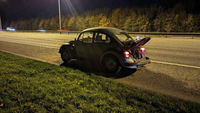

Last night I had fun...
I think it's self inflicted. Generator seems to be seized and the bearing collapsed. I fitted a new fan belt but I think I might have fitted the wrong one and it was too small so it was tugging on the bearings and it overheated and seized. It looks like both 905mm and 912mm belts were fitted and I went with 905 as I couldnt tell off the old belt as it was stretched.
I ordered a new generator and the correct belt on the roadside while I waited 😅 £70 for a new one so not the most painful mistake

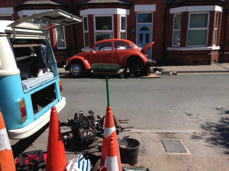

This is the one where the fan nut had become as one with the shaft.
Having to drop the engine to sort this led to a quick engine swap with the van whilst it was out (as you do):
Happy days.
