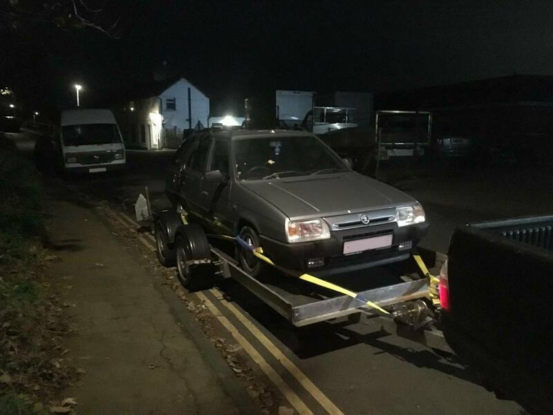

Rust Collector Posted February 17, 2022 Author Posted February 17, 2022 So another post that's a small loop back in time. Towards the end of last year I was on a beer run. Vehicle of choice was the Favorit. I ran to the local Tesco Express, parked up and bought beer. Came back out to the the car, cranked her over and she wouldn't fire. Tried again, and she tried to idle bust just couldn't get there. Admitting defeat, I put it in first gear and bumped it down the hill on the starter. Behind the Tesco Express is an excellent road for dumping cars that you don't have space for on your drive as there's no houses there. I wandered up to the main road, called my partner for a lift, and opened a beer. I then left it a few weeks before bothering to go back and get the Favorit. This was the first proper use of my big trailer, and my Shogun Sport had shit itself so my mum's L200 had to do the honours. Bonus van chod parked behind me whilst I was broken down. Then in the spirit of things, I left the Favorit on the trailer for a bit.Roll on January to unload it. Note the 16 inch Mercedes alloys on the trailer... These are not suitable trailer wheels. I need to put a post up at some point about my brother and I buying sixteen 4 x 5.5 inch trailer wheels and studding the hubs to run them but that's for another day... Unloading the Favorit disturbed a lot of hibernating ladybirds. I'm not sure why, but the Favorit undercarriage seems to be the perfect environment for them to hibernate in. Ladybirds rehomed, it was time to sort the car out. Unfortunately I don't really have any pictures or videos, but the symptoms were that the car would run from cold then die once warm. Which was the same symptoms as last time it cut out and left me stranded. A second new crank sensor later (at about the same time as I put one on the Clio) and the Favorit ran beautifully hot and cold. Fuck Lucas and their sensor that lasted less than 2,000 miles. Celebratory picture of the Favorit pulling the healing trailer mk2 for some reason whilst my brother presses the brakes. I think the photo was something to do with trailer wiring woes but it is also right after we fixed the Favorit so it is kind of suitable. Put the Favorit in the fixed pile then, and ignore the hole in the roof 😅 chodweaver, LightBulbFun, AnnoyingPentium and 5 others 8
