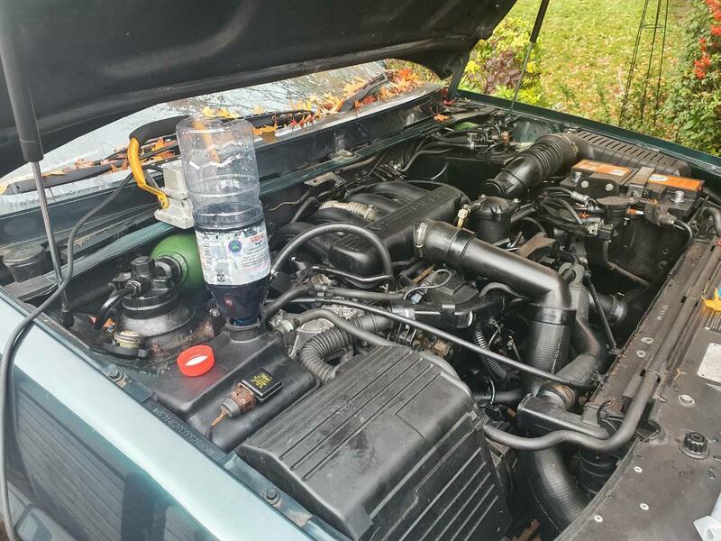

wesacosa Posted December 13, 2021 Author Posted December 13, 2021 Time for an XM update.... First job after the restart was to run for a bit with just deionised water to check for leaks and flush out any remaining OAT coolant and then fill up with a nice retro blue antifreeze!! Haynes manual top tip is to create a nice header tank from a water bottle during filling and then leave in place and half full during bleeding. This worked perfectly on the deionised water fill, you can sit in the car and watch the bubbles as you rev the engine. It was working fine on the second fill with the antifreeze too, until the plastic got too warm , collapsed and chucked half a litre of antifreeze all over my engine 🤦🏼 After that I bled all the brakes after my previous LHM change and then went for my first ever spin around the block. Sadly it became apparent after about 100 yards that all was not well. The car was bucking around all over the place and reacting very badly to bumps. I once moved a colleagues Datsun Stanza with totally shot dampers and this felt similar. Concensus from the XM forums were either shot spheres or suspension stuck in hard mode, which apparently can happen due to electrical glitches or incorrect depressurisation of the hydraulic system before starting work on the hydraulics. A quick bounce test of the car showed no suspension movement https://youtu.be/HtoIKKW4DNk (warning, video contains significant Lucas pumped cold start Diesel clatter and a bad work from home hair cut) a quck visual of the rear and underside spheres confirmed they had seen better days, and were embossed with the Citroen logo so could well be original being a late hydroactive 2 car there are 8 spheres in total (4 corners, 2 center hydroactive, 1 accumulator and 1 anti sink). I had already done the accumulator and decided to leave the anti sink so just the 6 to buy not nice weather to be under a car, and luckily I inspected my old ramps before going under I am calling them fecked !! That's better !! Sphere change is actually not too bad if you have the right tool. The blue one was good for all but the rear center sphere, but because that sphere is buried up under the exhaust you cant get access for the long handle without dropping the exhaust. the smaller black sphere tool mean you could get at it just by removing the exhaust heatshield and spare wheel holder Speaking of spare wheel holders I think its seen better days 😂 nice shiney new spheres and nice bouncy bouncy action video https://youtu.be/QoAxzPEpCcI I still not happy with the height. It seems to sometimes drop on start up, sometimes sit high. But its been stood 7 years so perhaps just needs to be used and have all the linkages start moving again. Next jobs ABS light on Suspension light doesn't come on Test drive to check for no issues after cambelt and coolant work present for MOT 😳 PrinceRupert, RobT, Bren and 16 others 19

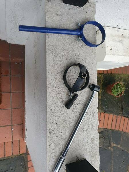

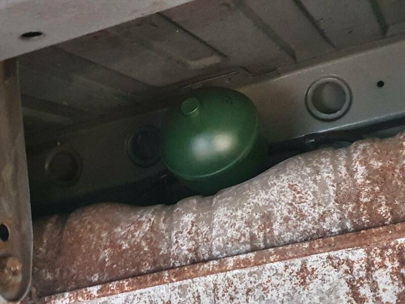

beko1987 Posted December 13, 2021 Posted December 13, 2021 Plusgas the front and rear height corrector, then many citrobatics and as you say, throw it down some windy B roads very fast a bit. Had the rear seize up on my xantia and it wasn't fun. Worse at night as you blind everyone if its got the arse down! Reasonably* simple* job to remove, strip and clean and reassemble. I imagine once you've got it off running every metal part over a wire wheel and just reassembling would fix 73% of all the issues they'll ever have. I used to be able to move the height lever a bit then when the car started to move up or down, put it back and it would sort of stay there then for a while. Got home from work a few times. Whilst it's up on stands is a good way to check. Nothing heightens the desire to fill ones pants more than manually moving the height corrector lever the 3mm it actually moves and having the entire belly of the car creep closer as you lay on the floor under it😕 (Mark the positions of the bars going to the corrector too before you start but it's reasonably simple but very fiddly to set it manually) wesacosa 1
wesacosa Posted December 13, 2021 Author Posted December 13, 2021 I did throw some grease on the bits of the height corrector and linkages I could recognise and reach with the car on ramps on low. but perhaps needs more
beko1987 Posted December 13, 2021 Posted December 13, 2021 1 hour ago, wesacosa said: I did throw some grease on the bits of the height corrector and linkages I could recognise and reach with the car on ramps on low. but perhaps needs more A few doses of arm-under-on-high free'd mine up eventually but I'd class it as a bodge rather than a fix... Would probably see you through winter though as laying on one's back in the warmer spring sounds much more favourable! wesacosa 1

beko1987 Posted December 14, 2021 Posted December 14, 2021 Having changed spheres on my xm and all the springs on a Meriva A the sphere job was far simpler 😅 Granted it all falls down when pipes or unions start going south but I guess the same would be true of hidden leaky brake or fuel lines on any other car. Bear and wesacosa 2
