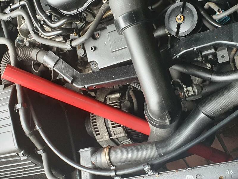

wesacosa Posted June 19, 2021 Author Posted June 19, 2021 got the little fecker off. was thinking about what you said @Ian_Fearn and thought even if I do get a chain wrench might still need shocking loose. I managed to get an old jack handle in through all the pipes and hoses to make contact at the right angle. gave it a few hits with a hefty hammer and it cracked loose (mms from impaling the wrench handle into the radiator fins 😬) Three Speed, chodweaver, Mudster and 1 other 4

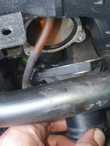

wesacosa Posted June 28, 2021 Author Posted June 28, 2021 uh oh . Appears to be no thermostat. I have a horrible feeling I may have bought a dud, which is hiding some horrible secret 😨 EDIT - This is an empty Thermostat housing used to attach top hose to block. See below for the ludicrous placing of the actual thermostat housing 🤣 Fumbler and PrinceRupert 2

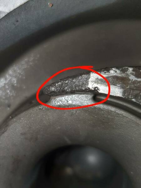

wesacosa Posted June 28, 2021 Author Posted June 28, 2021 Its both my first Citroen and my first diesel so a lot of learning to do. Plus the Haynes manual on this is particularly useless. Today's latest drama is what looks like a chunk out of the sealing flange on the block where the water pump goes Ian_Fearn 1
