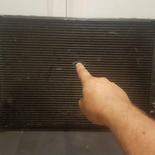

I removed the radiator from the car and flushed it through with the neighbours hosepipe while they were drinking cheap wine with Mrs Motown. The water flow was good and clear with no horrible stuff coming out.
217712697_642051107186107_469557680057369578_n.thumb.jpg.ee36a46dfcf5d1848c6323bf7b7b1498.jpg
The radiator seemed to be in good condition apart from a dent on the fan side

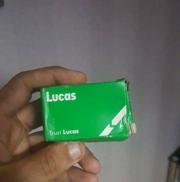

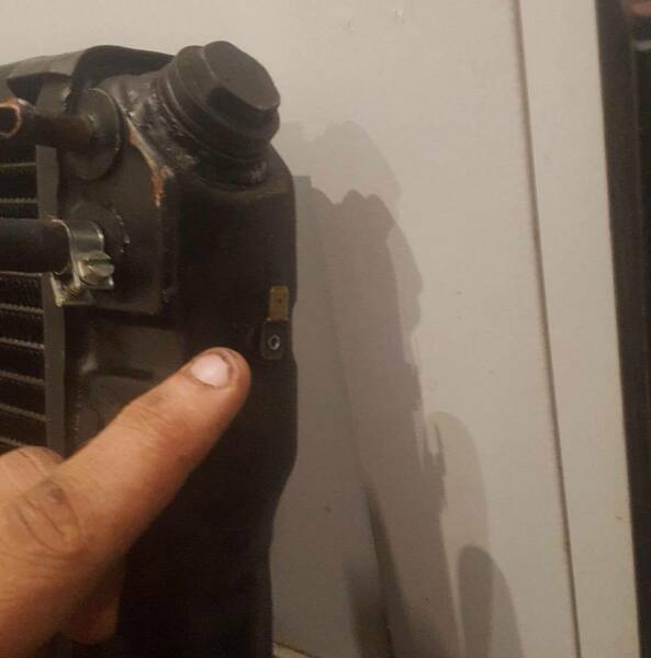

It was while i was replacing the gasket I had a brain wave from my 827 days it could be the coolant temperature sensor.... When these fail they send a false signal or no signal at all to the ECU.... Usually they fail and send a permanently cold signal so the car doesn't start but they can also send a permanently hot signal causeing overheating...  My temperature gauge doesn't seem to work either which again pointed towards a faulty CTS…
So I unplugged the CTS connector from the side of the block and bridged the connector with a paper clip i turned on the ignition and almost immediately my temperature gauge went to max so clearly the gauge works. I  reconnected the connector back to the CTS and nothing....  THE CTS HAS FAILED!!!!
217400009_5102223369792964_2231446329925845717_n.thumb.jpg.0d21dd07a98abb9e448fffda25990c50.jpg
I grabbed a Lucas coolant temperature sensor from my spares and waited for the engine bay to cool but in the meantime i got distracted by the sunshine and alcohol so il fit it tomorrow and report back 😃👍
