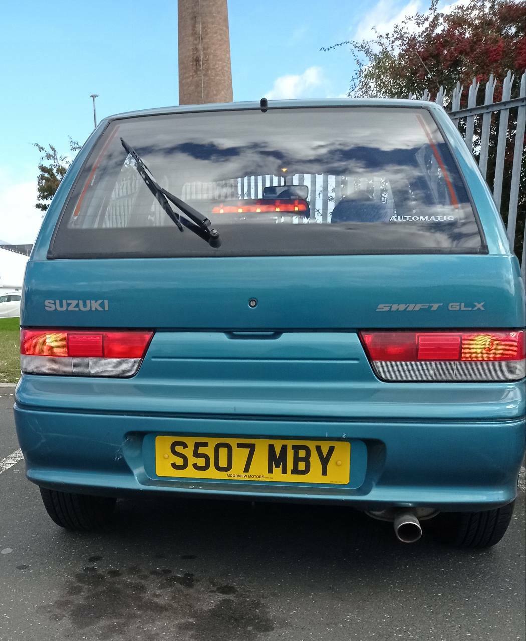

tooSavvy Posted September 18, 2021 Posted September 18, 2021 On 08/09/2021 at 17:57, Tadhg Tiogar said: I fitted one in the 635CSi and it worked alright, although the adhesive pads dried out and it proved difficult to find new pads that would stay on the rear glass. I'd fit one in the CX but the louvres over the rear screen would obscure it. I have just fitted a breaker sourced Picarse Mk1 hi-brake light, into SuziQ. I replaced the 5 bulbs (actually the car guys robbed them...) with Chink W5W White LEDs. Performs as Advertised...... £13, the lot! rainagain 1
