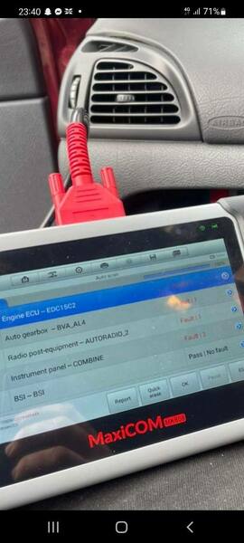

Service done today
We checked the codes whilst it was there
as you can see, gearbox code
now this is a slipping code (brake bands/clutches)
Now, I know what it'll need in the next 50k or so
A new or rebuilt transmission
I'm going to do it as well
2k I'd say would get it done
I stress its not needed quite yet, but in the next few years it's a job I'll be getting done
I really don't have the skills to rebuild an auto transmission so I'll get someone to do it so it'll actually work
2k on what will be a 20+ year old 220k odd citroen.....yes
I'm going to get it to 200k and see how it is, then if its got worse I'll get the box replaced/rebuilt
I like the car, a lot, and what else decent is there for 2k thats equivalent? Not going to be easy to find something actually good and not fucked without buying new.....which would be my other choice
Otherwise, car is doing great, gearbox is good don't get me wrong but sometimes it slips slightly going into 4th which I'm keeping an eye on
