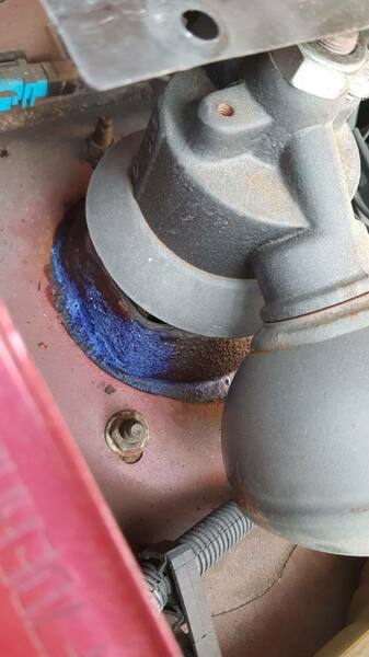

so to give you an idea, this is the drivers side strut before
quite crusty!
i'm not expecting this to work, as of right now i am still waiting for it to dry etc as it says approx 3 hours before fully cured
as you can see i did both sides, quite difficult to get round the back and under the sphere but i did the best i could
quite looking forward to seeing what this looks like in a few hours
