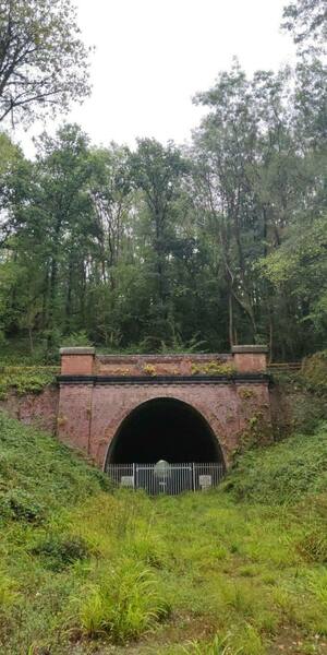

Crackers Posted July 14, 2021 Author Posted July 14, 2021 While the topic is in my mind, here's a pic I took last year of the Ardingly tunnel from the not-Bluebell end. CaptainBoom, LightBulbFun and Eyersey1234 3
Tadhg Tiogar Posted July 14, 2021 Posted July 14, 2021 54 minutes ago, Crackers said: While the topic is in my mind, here's a pic I took last year of the Ardingly tunnel from the not-Bluebell end. The trackbed often gets waterlogged.
somewhatfoolish Posted July 15, 2021 Posted July 15, 2021 That's all right, steam engines wade better than electric ones. mitsisigma01 1

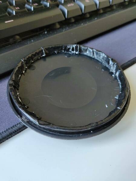

Crackers Posted July 16, 2021 Author Posted July 16, 2021 The steering wheel centre cap plopped out and landed in my lap on the way home from work, I think it had got a bit warm and whatever goop the previous owner had used to hold it in had returned to a liquid state and given up. I've fixed* this with two layers of gaffer tape around the inner ring of the disc which should add enough to the diameter to act like an o-ring to hold it in place. *because I'm too cheap to spend £8 on a new centre cap of course High Jetter, tooSavvy, LightBulbFun and 1 other 3 1

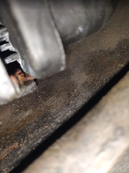

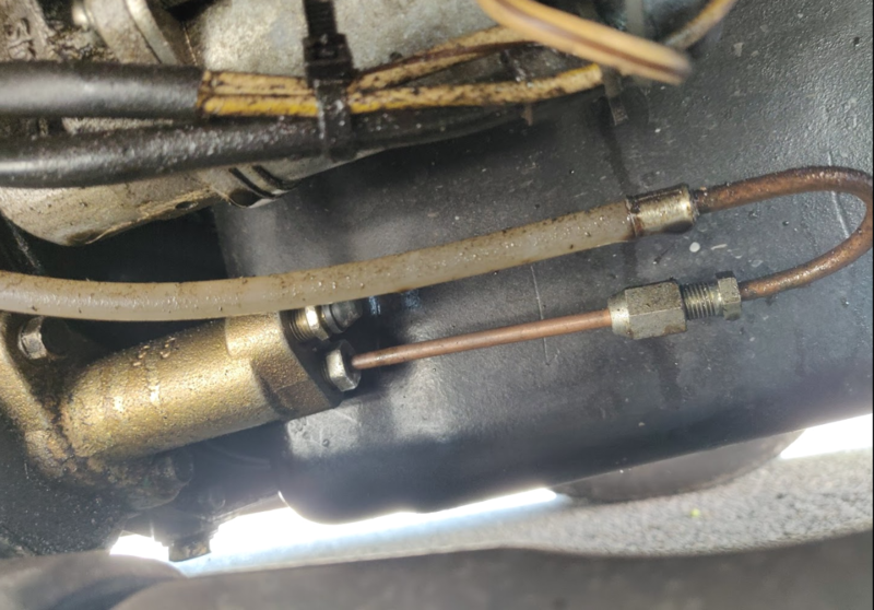

Crackers Posted July 18, 2021 Author Posted July 18, 2021 Long post incoming. So as mentioned in the News 24 thread, the dreaded clutch judder resurfaced yesterday after a blast up the A27. This afternoon I wedged myself under the car for a look around, primarily to see if there was anything obviously wrong with the hydraulics and also to see where the various oily drips on the floor were coming from. It's a bit of a bitch to see underneath this car without it up in the air, so quite a lot of finger poking and camera fiddling was required. First let's have a gander at the tiny coolant leak that drips off the front valance - this is literally a single drip a day at most, but it looks bad as it's visible right under the nose of the car, and will eventually rot the valance. I've tweaked both rad hose clips but they were tight AF and didn't go any further. Cleaned off the trail of dried coolant on top of the valance, and will reassess later - I stuck the camera in the tiny gap and the only hint I can see of a potential leak is this: Top left of that photo, bit of white chalky stuff inside the lowest row of radiator elements. Will be a bugger if that's the leak, as that means the rad needs removing, and this rad was only put in a couple of years ago. Next thing was to mop up some oil from various locations. First one was the front crossmember - looks like there's a small drip from the front of the engine which is running down and dripping off the crossmember. Hopefully this isn't the sump bolts as there's literally no access whatsoever to tighten them as far I can see. Will keep driving it and assess again later. Next up, why is there oil dripping off the bottom of the starter motor (visible just below the wiring in the pic below)? Yeah, I'm not sure either. Possibly running off the back/side of the sump and dropping down but hard to tell without the car in the air. Clutch wise: The slave cylinder looks virtually new, which it should be as it went in a couple of years ago with the LT77 conversion. Nothing appears to be leaking (although some engine oil had splashed over it, I've wiped it off and will look again in a few days) however the hydraulic line from the master to slave is a clear pipe with a last bit of copper whacked on the end. I don't like this at all and have a feeling this could be contributing to the judder, and here's why. The slave cylinder and hydraulic line runs within a few inches of the exhaust downpipe. That's the downpipe, out of focus at the bottom of the photo. Now, a penny for your thoughts on this: The judder only seems to come in after either a motorway blast (where the engine's revving harder and getting the exhausts bloody hot), or if the car is switched off once hot, left to sit for a while (30 mins to a few hours, let's say) which means there's no airflow over the exhausts. Could it be that the radiant heat is permeating into that horrible clear hose and boiling the fluid, thus causing the slave cylinder to become ineffective, therefore causing the pronounced clutch judder when pulling away from standstill? I'm tempted to swap in a length of racey braided hose, give the system a serious bleeding, and see if anything changes. Failing that, it can only be a failed slave (fair enough, easy job) or a crapped out clutch (in which case I'll sit in the corner and cry instead). JeeExEll, mitsisigma01, LightBulbFun and 2 others 5
SiC Posted July 18, 2021 Posted July 18, 2021 Ah yeah not a factory installed manual. Bet it's the brake fluid boiling off in there. Wrap the exhaust in manifold tape around that area to try keeping some of the heat away? Crackers and LightBulbFun 2
SiC Posted July 18, 2021 Posted July 18, 2021 As a test, go for a spirited drive/motorway to get it hot and a problem. Then spray water around there and go for a drive to see if the problem goes? If the fluid has boiled off then the fluid in there is no good anyway. Short term fix might be to replace the fluid, which will bleed the system too if it has boiled over. LightBulbFun and Crackers 2
mitsisigma01 Posted July 18, 2021 Posted July 18, 2021 On 7/16/2021 at 4:35 PM, Crackers said: The steering wheel centre cap plopped out and landed in my lap on the way home from work, I think it had got a bit warm and whatever goop the previous owner had used to hold it in had returned to a liquid state and given up. I've fixed* this with two layers of gaffer tape around the inner ring of the disc which should add enough to the diameter to act like an o-ring to hold it in place. *because I'm too cheap to spend £8 on a new centre cap of course True Autoshite style 👍11/10 Crackers and tooSavvy 2
SiC Posted July 18, 2021 Posted July 18, 2021 If it is boiling off, another potential solution could be to have a high temperature brake fluid. Not sure if this is high enough still, but may just be enough to get away with it, especially with an exhaust wrap around that area. https://www.halfords.com/motoring/engine-oils-and-fluids/brake-clutch-fluid/millers-oils-racing-brake-fluid-300-plus---500ml-417830.html Just may require you change the clutch fluid more often than you usually would too. LightBulbFun and Crackers 2
