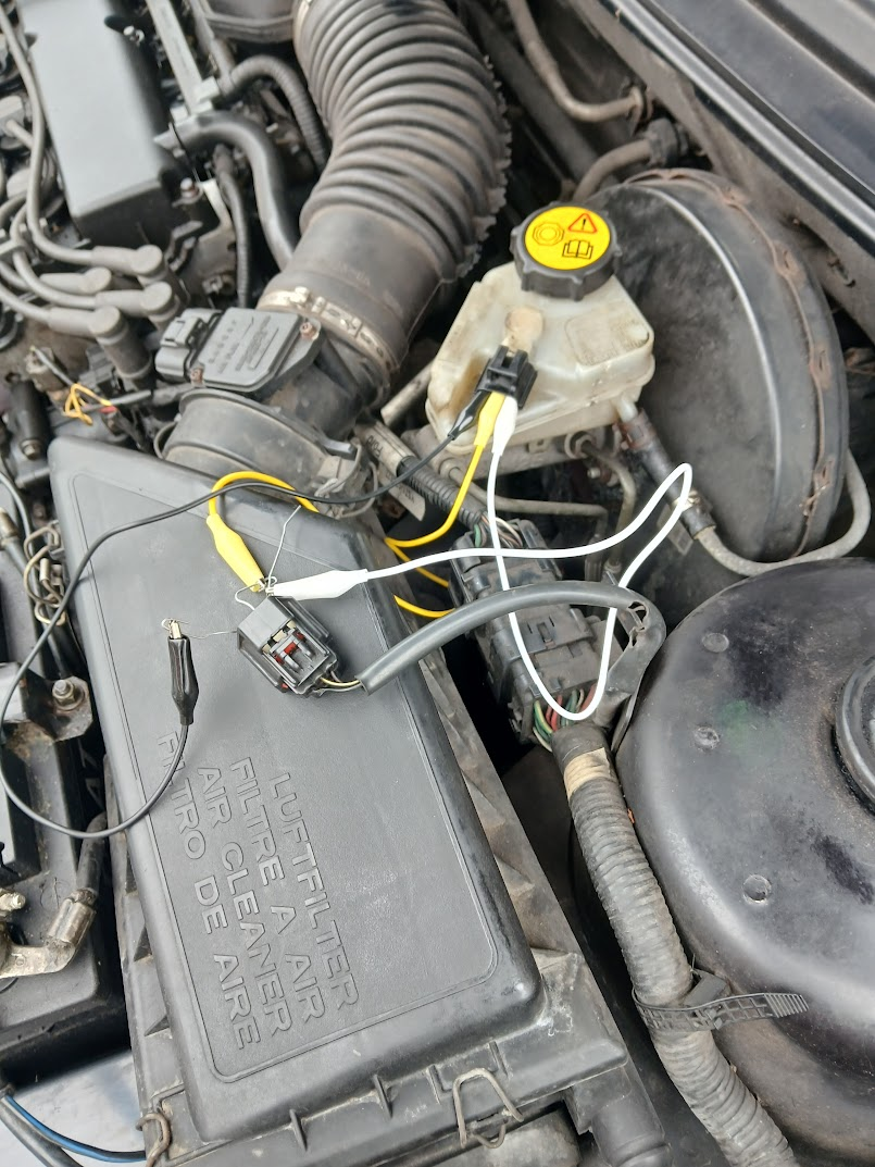

The diagram posted does miss out the handbrake switch itself which is earthed on the right, just out of view. However, you're correct that I think I have misunderstood. Unplugged the multi plug today and it's still permanent on. I guess the next check is to short all 3 pins together (the opposite condition to open circuit) and see if that has any effect.

The brake warning is wired on a "fail safe" system, which means that the light will illuminate if there's a problem with the brakes (low fluid and/or handbrake on) AND/OR there's a problem with the wiring. This is to alert the driver to a brake problem and/or a wiring problem.  It's better to be safe rather than sorry, and that's why the system's wired in this way. A good analogy is to think about air brakes on trucks & trains; if there's a problem with the vacuum the brakes are automatically applied, hence the 'fail-safe' phrase.
 D.M. me if you want more help-happy to pop round chéz vous sometime.
Yes, I assume it's logical to 'fail safe'; which is presumably what it is actually doing - so it's doing its job well!
May give you a shout later in the week @Andrew353w when I've a bit of time to look at it - thanks!
I had ordered a decently-priced m/c and brake fluid reservoir, just in case, last week. I had a look today - I think when I drew off the brake fluid previously, it took off only half of the circuit's fluid, leaving some in the other half of the reservoir, hence the switch was reading ok as, err, it was. The reservoir (empty) which I have here has continuity between all pins, which is how it 'should' be according to the diagram in its condition... I think. Anyway, if you plug the multi plug into it, the brake light glows bright red rather than just the mid-dull it is stuck on. So it's definitely something wiring related.

A couple of bits done at lunchtime. I think the next thing to do will be to test the link between the brake fluid reservoir and the dash, based on the diagram, so a start made in taking the dash apart.

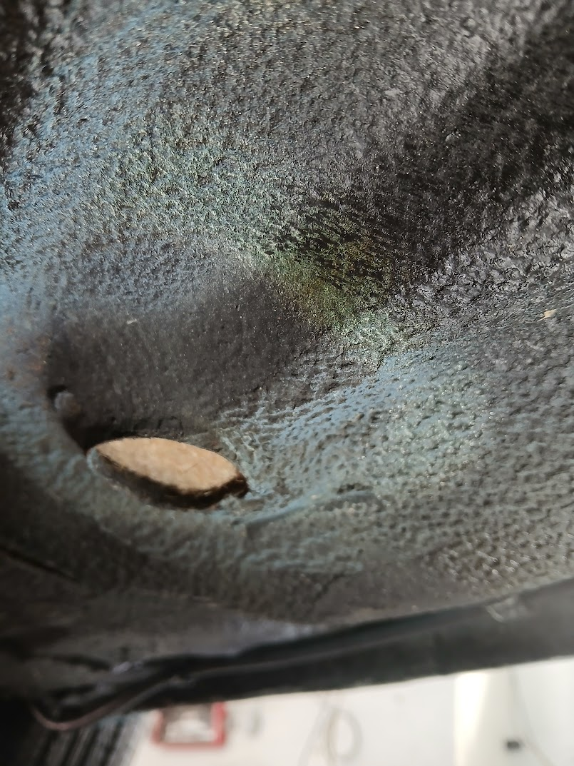

Also had a look at the bumper, which the spray paint has flaked off in a couple of places, to see about re-doing that while I'm at it.

To do a bit of testing, I used a highly advanced* method, connecting the connectors via test leads and, err, bent paperclips. Frustratingly, it seems the only circuit diagram in the Haynes book is from a Mk1 Mondeo - trying to find the pinout at dash end, since the fault seems to lie between the brake reservoir and the dash. More after lunch.

The handbrake light issue seems better after a thorough clean up of everything, although there's still something not quite right as it does glow (now very dimly), but sufficient to be passable.

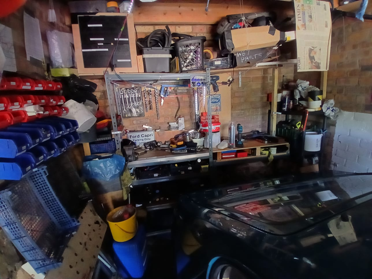

I spent most of yesterday tidying and re-organising my lockup.
Somehow, I got six bags of rubbish out of there. A combination of old parts that were knackered and I'd just chucked in the corner, offcuts which were realistically never going to be used, dried up paint, manky old jumper that had got damp and oily etc etc.
Rearranged the workbench and shelving units to give me a bit more space and an easier working position. See here with the Capri parked in the garage - previously, the workbench was about half its length to the right, so to go and do any work on the bench or the vice when the car was in situ, was a bit of a squeeze.
There's also been some more organising and putting-away of things so that, theoretically at least, things are easy to find and to hand. There's a box for mondeo parts, a box for capri parts, and a box of generic bits and pieces. The workbench now extends, too, so to give a bit more working space (/dumping space...) and, in bringing that side up, a handy space was created to slide tool sets into (torx/spline set, 6 point impact sockets, circlip pliers - those bits that you'll lose if mixed in with everything else). Definitely an improvement!
