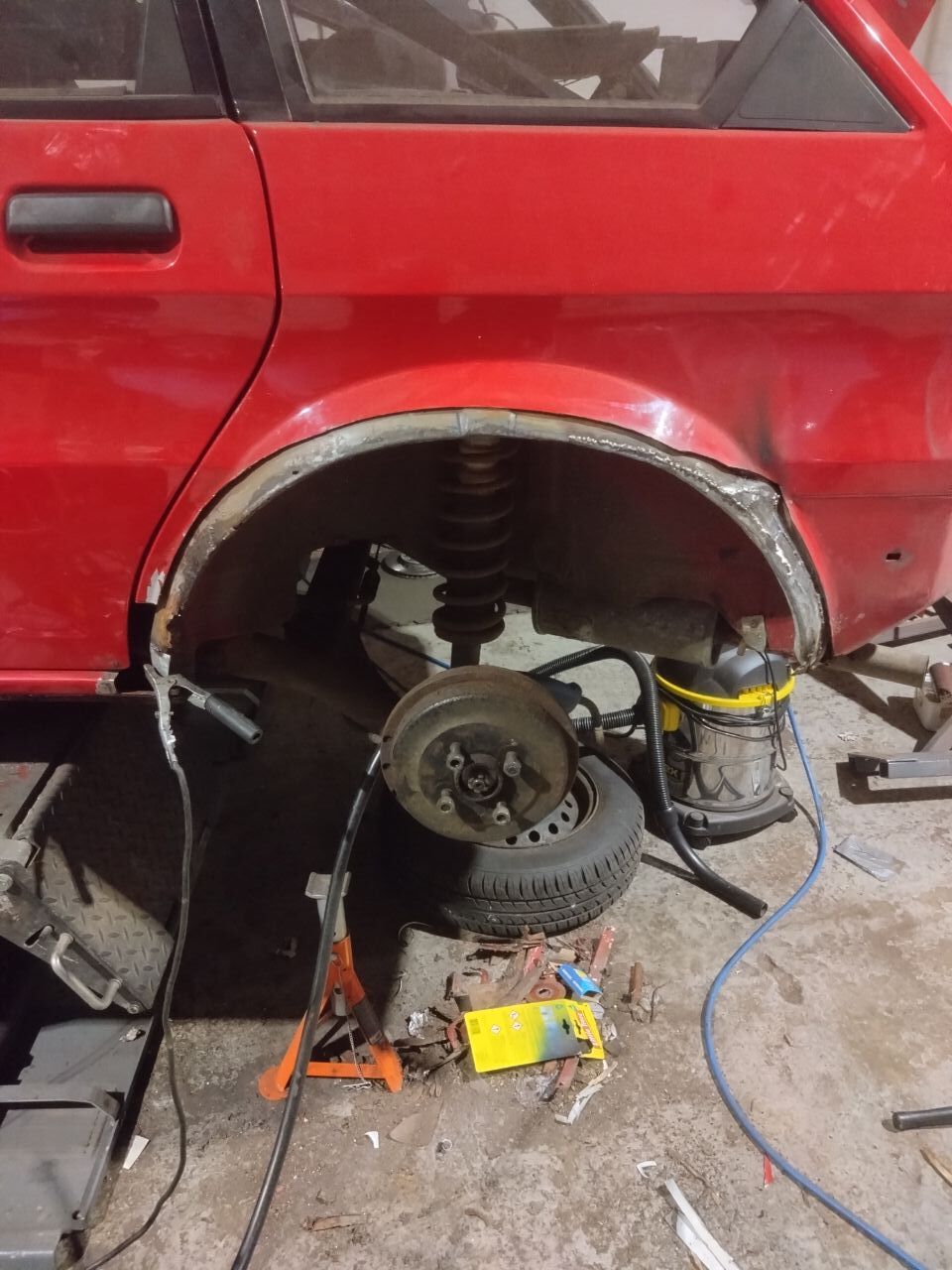

Back on the Maestro today.
Booked the rest of the week off. My thinking was to chap on with the arch this week.
Reconstructing the inner arch lip by doing it in little sections at a time.
Went a little hotter with the welder. Laying down much neater tacks. Less grinding required hopefully.
Not perfect. Doubt it'll matter once the paint, sealer and underbody Schutz is gobbed on.
I'll see how far I get today. Would like the inner done by the end of tomorrow. Like shite that'll happen 😆!

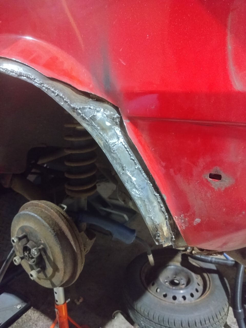

Another day later than expected. The Maestro has this.
Will warn folk it's a patchwork. Had to stick the grinder in when I wasn't happy with the profile and then fill the cuts back up with snot.
It's been ground down but not to blend the metal in. This is to keep some rigidity and not thin the metal out.
Check for pinholes, paint with red oxide and then think about chopping up my expensive outer arch.
Left the ends of the inner for now.  I'll sort those when the outer is on for good.

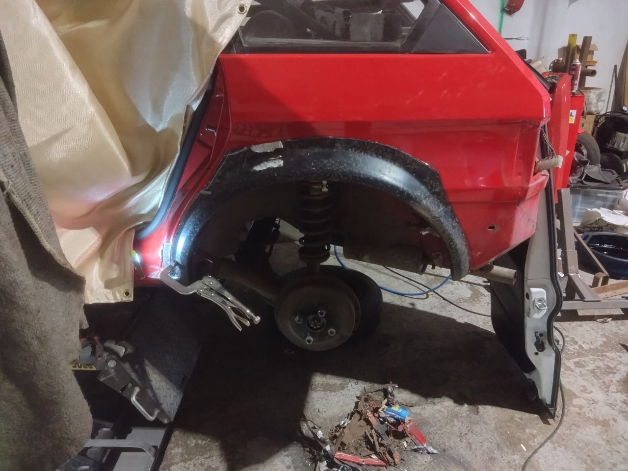

Finished off the inner arch to sill area. The outer sits on the sill so crafted a wee piece to slot on to replace the thin air
Dug out the new (to me) arch and set about sorting the rust pits and spider lines on the back of the panel. Hand sanded with 120 grit and then applied two coats of Hydrate 80.
With two decent coats of the Bonda primer.
The next bit was a little nerve racking. I had to trim the panel down. Laid it over to plan my next move.
Clamping it on and then cutting both arch and quarter panel to make them fit.
Another clean up and threw some tacks on.
Glad I followed what others have said about arch repairs. About not using all of the panel. There is some gappy parts. Which is more of an inconvenience than a "oh crap, I've ruined it!".
I like the fact I can also retain most of the body lines and things like the door shuts remain unaffected. Like so.
I'm pretty pleased with the job. Still some work to do, the panel needs twisted and pushed in to achieve the fit I need.

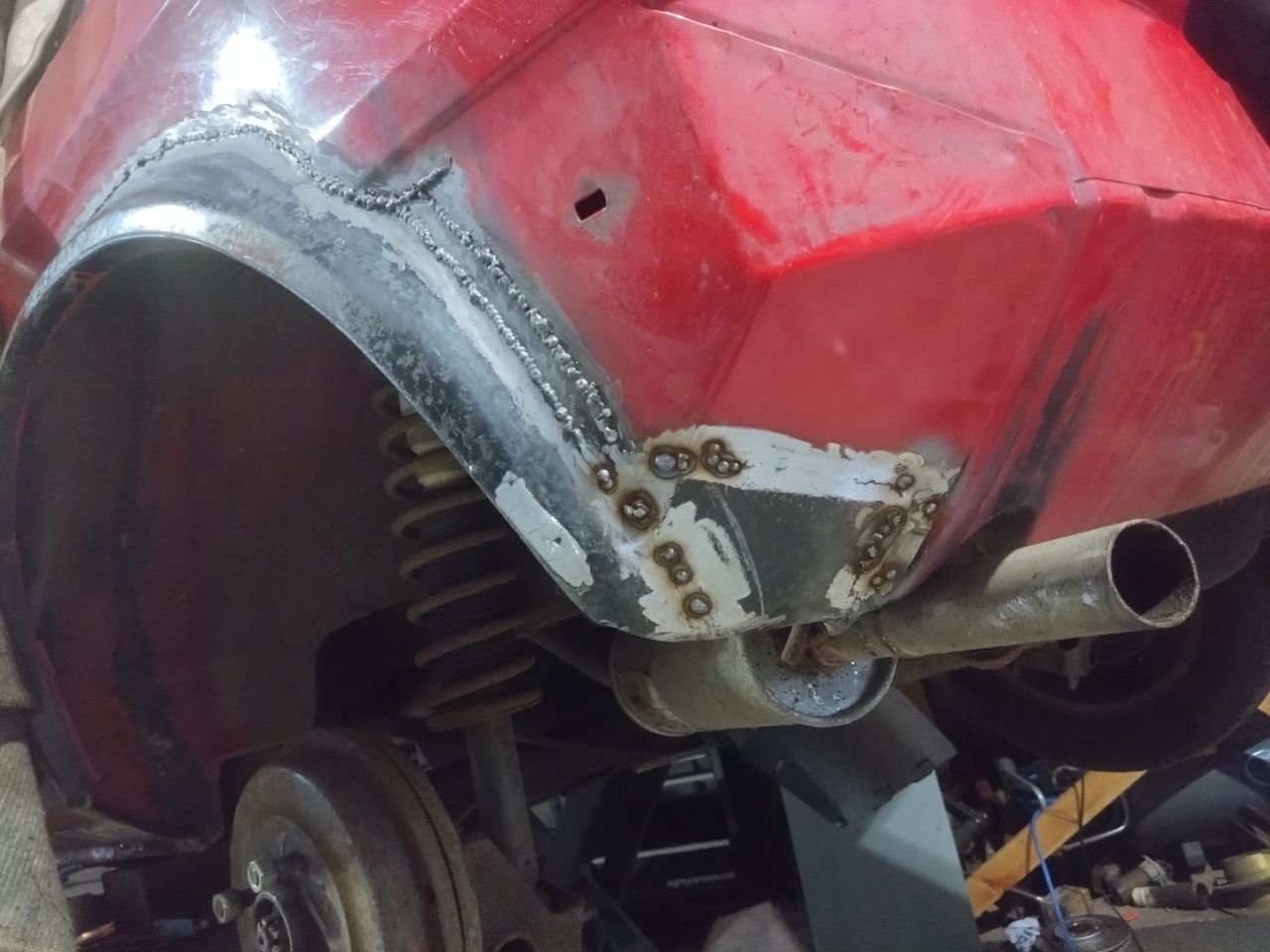

Had a few hours to spare after work this morning.
That's the arch to rear valance area rebuilt.
Extra spots of weld is me filling the pinholes or missed bits. Hoped to have had the front section done too. Meh! That can wait for tomorrow.

Another few hours spent resulting in this. Front section all welded and threw a good few heavier tacks on the bottom of the dogleg.
Then a combo of finger file and just a ordinary grinder with a boggo grinding disc. Makes for neat and quick work. I rarely use flappy discs now. I'm chuffed with how well came out.
Made a start on the plug welds of the arch lip.
It's maybe a bit arse backwards to do this when the arch is attached. My reasoning is it's easier to judge where I need to make the hole to weld inner to outer. I had to bash and bend the inner to a tight fit.
Kinda cocked up too, as I was going to show my technique for welding the two. But it's dead easy to explain. 3mm hole drilled as a pilot hole through both layers and then up to 5.5mm but only on the outer layer. Clamped a piece of copper behind the hole and sent it with the welder with a decent amount of heat. Mostly getting flat plug welds.
If I remember I'll take a picture to show this method. As I ran out of time and only got as far as you see on the last photo.
