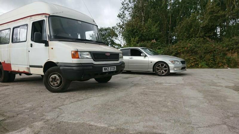

Threw that on and took another picture. With a pals LDV that he has been welding up. Oh boy that was a project!

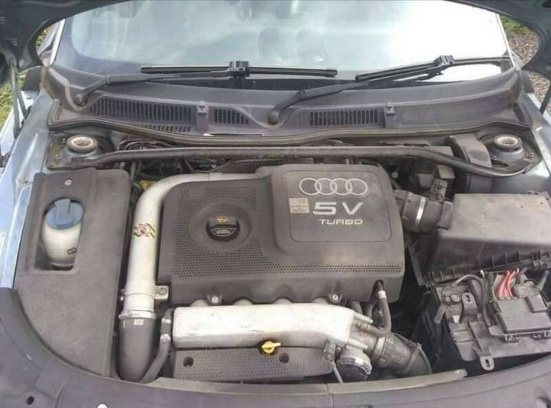

Then as in the news thread, I went a got an Audi TT. A pal was selling it, naturally I jumped straight in and bought the thing.
It's a 225bhp 1.8t convertible. Interior looks clean. Usual dash display issue was surprised that a new screen is cheap to buy. Plans will have to wait though. Want it at the lock up first and check over and see if it's worth fixing.
Can finally upload some pictures. So have TT pictures.

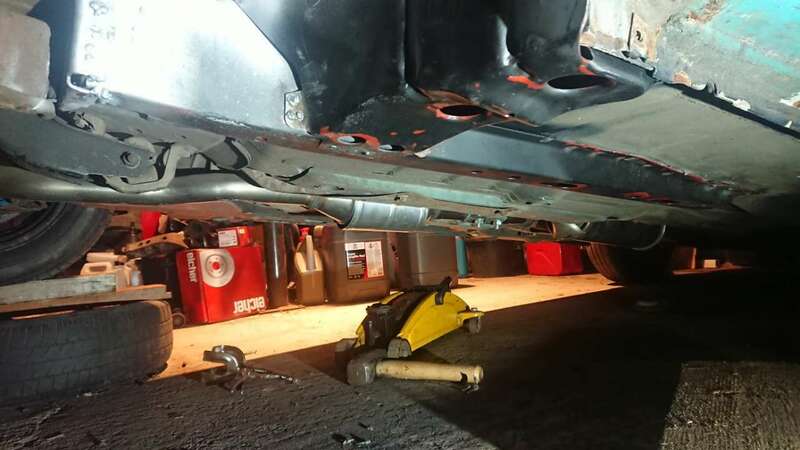

Thought I'd chap on with the Corsa. That chassis leg looked better than it actually was.
Did not see the point of repairing this one. As you'll see. Still not the worse I've seen or had.
Figured that chopping the whole thing off and replacing with fresh would be a hell of a lot easier and tidier. Glad to see the floor was fine.
Still some old chassis leg to remove. Welding in the new leg and outrigger should be quicker and easier,

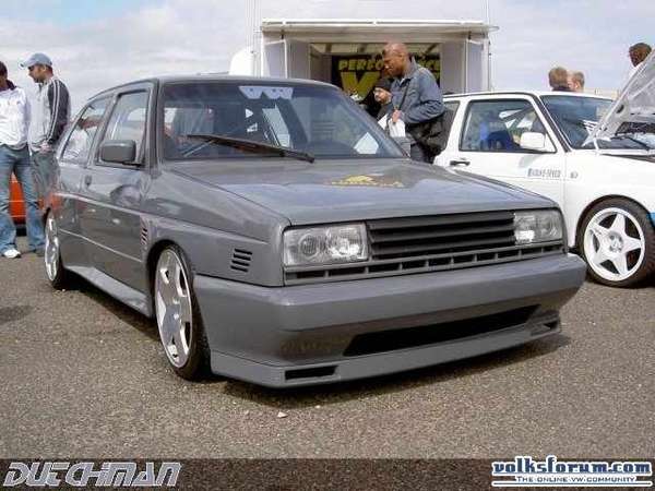

On a side note. Still remember (and have the issue it was properly featured in) of this car from Performance VW.
TT wheels, 1.8t and TT dashboard. Might not be to everyones taste, but I loved it!
Loving the new wheels on the Altezza and the grill. Are you UK or Ireland, seeing both numberplates that's all?
Has your avatar always been sassman, only just noticed it?
Thanks, it makes a quite a difference like. I'm UK based. It just happened to be the Van had an NI plate on it.

Oh how I missed welding.
Nahhhh, really haven't. Scratching about the floor is shit.
Progress was made regardless of my gurning.
I near drowned the rail in red oxide and spray undersealer.
The outrigger has since been fitted. Which means that's the biggest job welding wise done. Still a little fettling to make it 100%. Because aftermarket panels.
Strange though. I'd of binned this off years ago because of the rot. Now. Yeah, I'm glad I tore into it and now fixing it.
