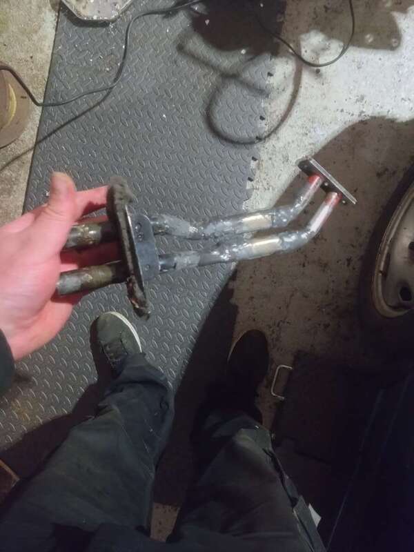

I had a look at my spare set of pipes. I've manged to separate the pipes from the mounting flange without much hassle. Also remembered I have a load of 15mm copper pipe from a DIY job ages ago and some Yorkshire fittings with a near enough bend to work. Nowt to lose by having a go at making a set.

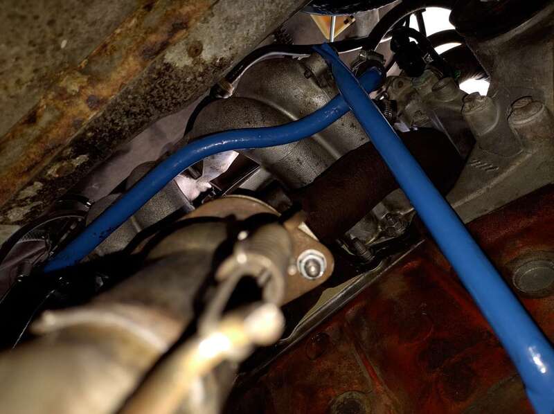

On the subject of rusty pipes, I did these support/transfer bits and pieces on my Maestro in high temp paint. Black would have been better but I already had a tin of blue open.
The upright struts support the manifolds and the crossways one is a coolant pipe. I chose high temp as it's pretty close to the zorst...

Found the leak. A pin hole, blobbed some weld in and smeared some more chemy metal on. Ran for a good while leak stopped.
At this rate I could do a reasonably good job of icing cakes! 😆
Then a picture for @grogee of the pipes in situ.
I have made my other set up now. I just need to figure out a method of attaching the mating flange to them. Did buy some brazing rods from Halfords. They weren't very good. I'll sort something out another day, as these ones are holding up for now.
