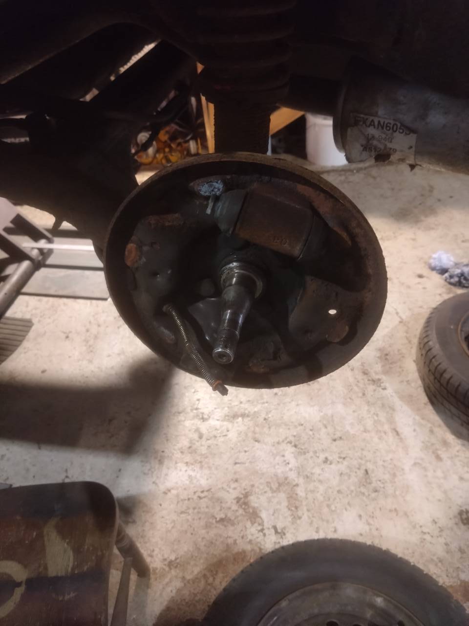

Brake pedal never felt right to me. I thought I'd do an investigation to why.
Made sure to be careful with the L/H hub nut. If you own/owned one of these you'll know why.
Quite easy to strip and rebuild the back brakes. Found the quadrant for the handbrake adjustment was seized on both sides. Typical Maestro/Montego.
Freed and copper slipped. Built the brakes back up and now have a much better feeling brake pedal and the handbrake locks up as it should.
Think that's it for now mechanically. I badly want to sort the rear arches. On the other hand, think I may pudding them up again for a short term bodge.
