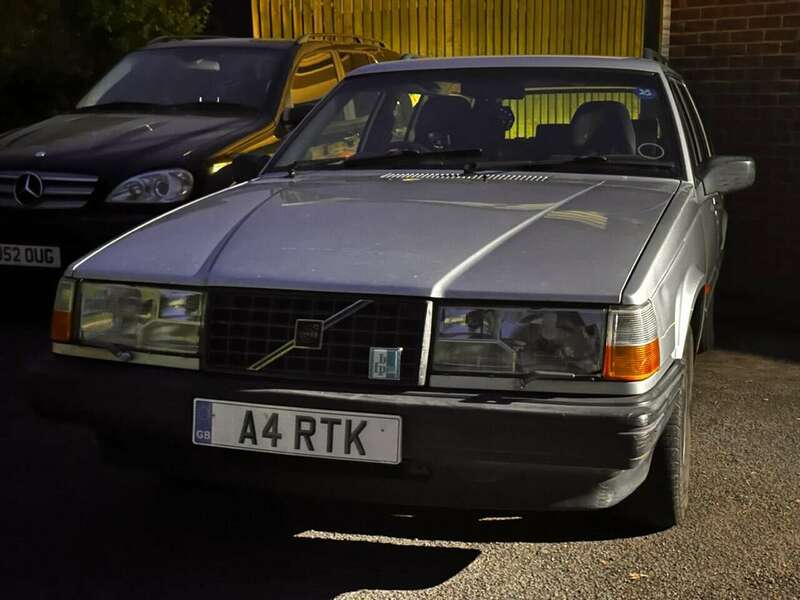

1: Running rather nicely now, good smooth idle.
2: I wonder why the brake light failure is on...
1 hour ago, RichardK said:
No points, surely, on this?!
Doubt it has it. All Volvos at least here, after 1985, have electronic ignition.
So, yeah. Bulb failure was "it wasn't a stop tail bulb". Emissions is probably the duff plug lead as it's going like a beast now. And washer jets were Β£7.50 for a pair...
That garage owes me an MoT I reckon πŸ˜‚

That’d be a right result if the emissions problem was just that dodgy plug lead!
Those bulb fail warning lights can be very sensitive, I’ve had them come on before because of different branded light bulbs side - side before! Even damp and corrosion on the bulb holders etc can cause it to come on. There’s a relay for that system in the dash which works on the circuits being balanced on load. Hence if a bulb pops or you get corroded contacts on one light the relay sees the circuit as an imbalance and illuminates the warning light. I had this on my 740 because someone had ripped out the metal circuit tracks on one tail lamp and replaced them with bits of crappy wire and connections. There was obviously much more resistance in that light than the other side!
7 hours ago, RichardK said:
They are on the list but Bosch cap is expensive. No points, surely, on this?!
Redblocks are K-Jet, no points.
Just looked up the price of a cap, fucking hell. Bosch cap for the 300E is 'only' 80...
Well, that was my first thought because the NS was brighter than OS - but it got brighter with brakes on.
It was a single filament bulb in the holder. Stopped at garage after getting chips and bought the right bulb, and all lights on as they should be.
Obviously I can't tell if the emissions are better but it is definitely running better with new Bosch leads on. Suspect a cap and arm would improve it further... but the slight miss/offbeat tone was gone.

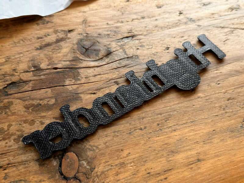

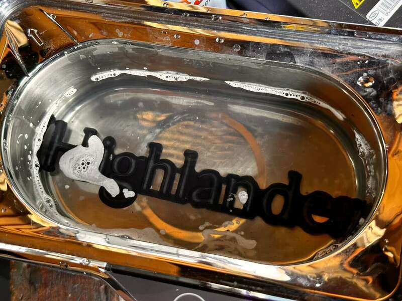

Clay bar suggests the car has lived near a railway - huge amount of rust fallout. The boot/D pillar paint is smooth again...
Now where's my liquid chrome pen and 3M tape...
Β
Got m'car back:
And this:
Just need to cut the tape down to profile then it can be restored with no risk of losing the H.
(I am guessing it's obvious how much I like this car)

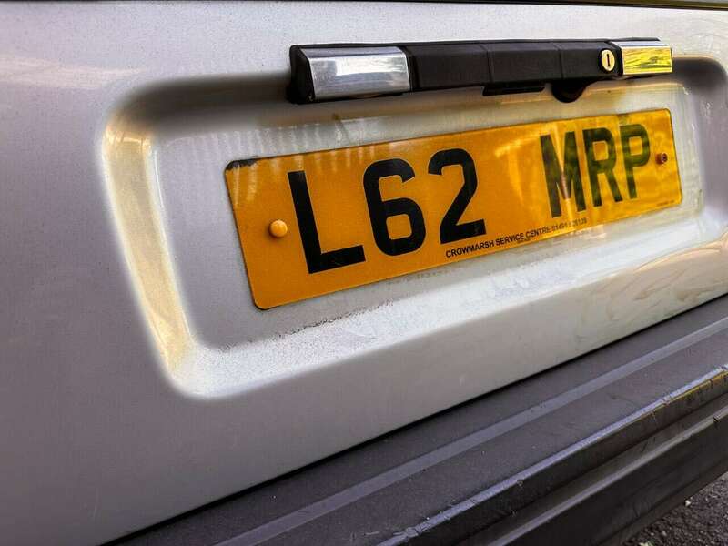

Clay and tidying is improving things, but... the light is an eyesore and should have failed MOT on visible white technically...
The Β badge isn't straight - I lined it up with marks left by the old one, will remove and straighten but making a 3M foam backing to fit was a nightmare! Horrid stuff to cut to detail.
I hate finding hidden rust:
So I'm glad there was none.
Depo. Translation: a copy yet somehow, worse. But it fits okay - the bulb holders are prevented from fitting by the contact strips. The trick is to fit them before fitting the light.
Good enough though.
