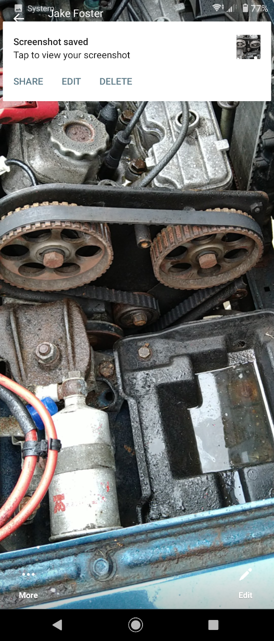

I've no doubt it's the correct one but that cam belt is typical of many Fiat/Lancia belts in that it looks way too narrow for the application, my Panda is very similar.
Good luck on the MOT!
Yes they are quite narrow , not a massive problem on normal asperated engines . But the turbo ones especially in 16v form suffered with belt failure . Lancia recalled the 16v ones and fitted later pulleys and belts , it has deeper teeth and is much stronger .
