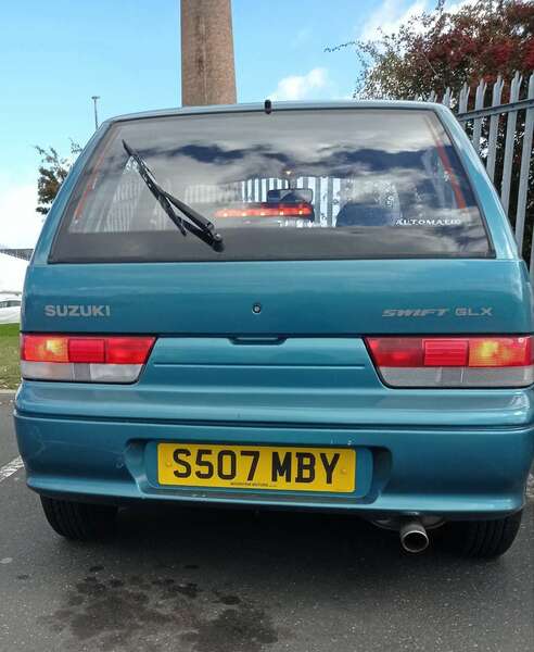

loserone Posted September 19, 2022 Posted September 19, 2022 Did you spot my Xantia? Should have hollered!ย tooSavvy 1

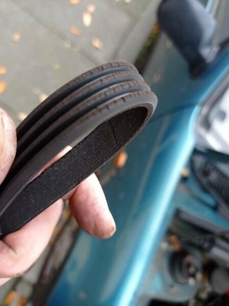

tooSavvy Posted October 3, 2022 Author Posted October 3, 2022 Well...well...well (not)๐ฑ ..... I pulled up, dropping anklebiter @No1 boyf, and I'm 'Sniffinn... Sniff.Sniff.Sniffin' ๐ฎ Bar-B-Qd rubber something ๐ค.... Pops bonnet and sniffin..... Yupp, fan belt ๐ Get home and give the hand around the world jobbie .... Red Hot alt pulley + belt has fibreglass white whiskers/is sandpaper crusty on the flat back (toasted!!) Ah well, trusty spare is in boot so that's a job for the morning ๐จโ๏ธ๐
tooSavvy Posted October 4, 2022 Author Posted October 4, 2022 Aye......... Ffffiiiinnnnellll ๐ #1. Requires Mr Tickle arms & fingers. #2. Alt is tiny (to grapple with) and trapped under inj/brakes vac booster. #3. LEVERAGE (see YooToobsย ๐๏ธ) ..... All done ๐ Dyslexic Viking, privatewire and Matty 3

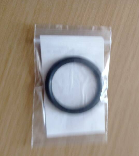

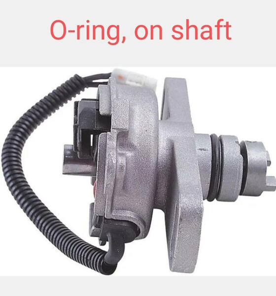

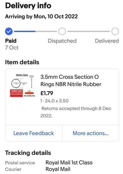

tooSavvy Posted October 7, 2022 Author Posted October 7, 2022 Whilst doing the fan belt I spotted an oil leak/general oily mist mess, at the gbox end... Ahh..... Dizzy O-ring [TADTS] ๐ Drilling *expertly into the 'hive mind' (of Geo forum USA) I gleaned the dims. Std Jap P-24 =ย 30.7 x 23.7 x 3.5 eBay to the rescue..... ..... No, I'm not paying 'Suzuki o-ring kit' prices, I'm a cheapskate FFS ๐๐ Liggle, Dyslexic Viking and privatewire 3
tooSavvy Posted October 8, 2022 Author Posted October 8, 2022 Oooof..... Quick! privatewire and Dyslexic Viking 2
tooSavvy Posted October 10, 2022 Author Posted October 10, 2022 Well I Never...... I have received 'the mark'! ..... The 'mark of Cain'๐..... The rivet counters, over on US Geo forum, have opined that I'm "off piste" with the use of a generic 24mm i.d. O-ring... Factory is 23.7mm ๐ฑ .............................. AnnoyingPentium and privatewire 1 1

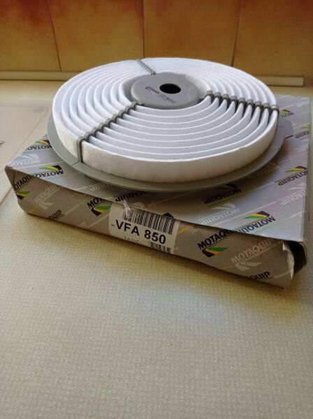

tooSavvy Posted October 10, 2022 Author Posted October 10, 2022 1 hour ago, AnnoyingPentium said: Rebellious behaviour... you'll send them into panic. Hmm..... paid ยฃ2.22 for an air filter (saw the current one a bit coally, when doing Alt belt) ๐ privatewire and AnnoyingPentium 2
tooSavvy Posted October 11, 2022 Author Posted October 11, 2022 Yo Ho-Ho.... Anklebiters No1 bf turned up, from his college, and planned to chill for an hour waiting schools out ๐ ..... Not Bloody Likely, m8! All he knows about cars is opening the door... Never too young to learn.... I pitched him into the street, I pointed and he unscrewed/unclipped ".... reassembly is reverse of dismantling!" & 'Lefty Loosely - Righty Tighty' had useful demonstration ๐จ Air filter is in ๐ rob88h, privatewire and 500tops 3

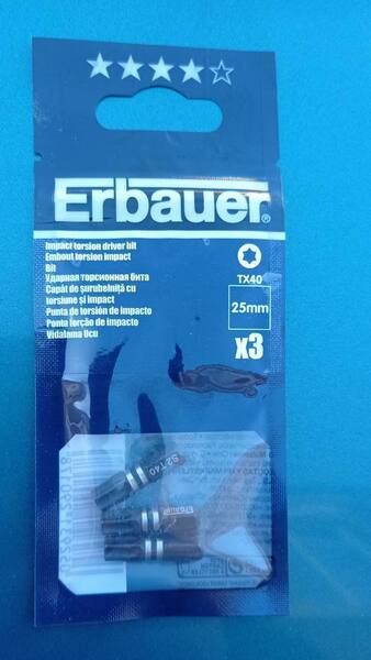

tooSavvy Posted October 13, 2022 Author Posted October 13, 2022 Ah $hite.... ๐ฎ ..... No T40 Torx bit hiding in my toolbag/rummage sock... ๐ Need it for Dizz bolts.... ยฃ2.79 Toolstation ๐ privatewire 1
tooSavvy Posted October 13, 2022 Author Posted October 13, 2022 ๐ ..... ๐ *O-ring not a problem for fitting, blue Hylomar squishing out all round base. Nice 13mm a/f bolts c/w thick washers subbed Torx, for clamping duties โ๏ธ๐ YES... Scratchmark to re-align 100% ๐ง๐ Fired straight up ๐๐จ privatewire 1

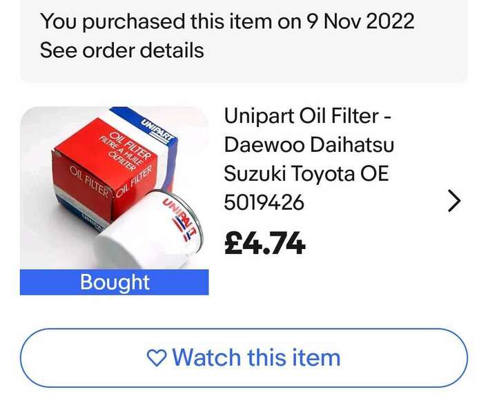

tooSavvy Posted November 14, 2022 Author Posted November 14, 2022 46 1/2 k...... Oil filter dropped off - KerrChingg โ๏ธ๐จ Now..... Rainydayzz this week ๐
tooSavvy Posted November 24, 2022 Author Posted November 24, 2022 Actually completed the oil change @46,930. ..... Well, forced myself outside [before the rain]= Bloody Freezing ๐ต Charging was a bit limp, at tickover, so I nipped my new flat alt belt a 'smidge more' ๐ต ..... Deffo some stretching since fitted ๐ Topped up washer bottle. Car runs like a Swiss watch, meh ๐พ๐ฅ๐ privatewire and Dyslexic Viking 2

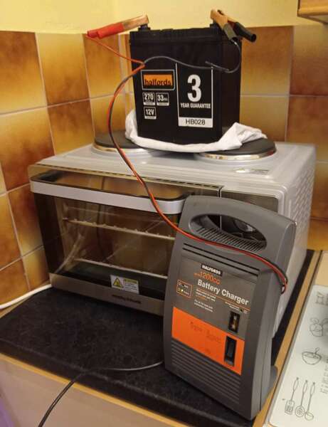

tooSavvy Posted November 29, 2022 Author Posted November 29, 2022 F.T.P. ....... Ah! ๐ ...... Jack Frost nippin at yerr Nose = read 'Grim Reaper winnows out flaky batteries @-2ยฐ' ๐ฑ
tooSavvy Posted November 29, 2022 Author Posted November 29, 2022 ....... Well..... Not Quite, or so it seems ๐ง When I unclamped the battery and went to remove the +/- clamps >>> the Red + just came off... No twisting or undoing [funny ๐ค] the Plain - Earth was good and nipped โ๏ธ No corrosion or anything, no damage to posts [skinny Jap style]. After an hour & half, green light came on the charger. I plonked the battery back in (I put a nail in under the + clamp) and that is now yarking tight ๐ I have immediately notice that the Voltmeter doesn't go below 11.9/12.2 on tickover and sits at 13.6/14.0 on the main road = all the headlights on! I think I shall give the battery a reprieve....ย We Will See ๐๐จ

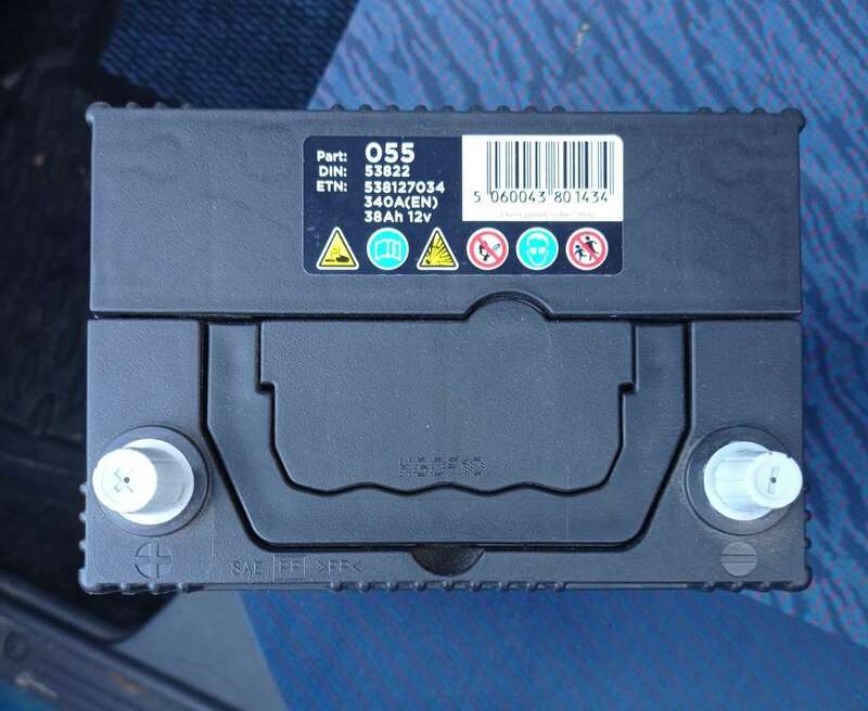

tooSavvy Posted December 7, 2022 Author Posted December 7, 2022 ...... Bit-the-Bullet..... Hope this is the heart of my maladies ๐ *I volt tested the old one, on my meter, 12.4V after a run out = not good ๐ Platinum HD ..... read of that what you will ๐ง ProgRocker and privatewire 2
