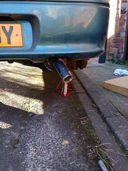

tooSavvy Posted February 7, 2023 Author Posted February 7, 2023 Well...... 'powertrain' you say 🙄 I have started getting a proper racket up from front & rear.... Sounds like the Ex pipe - front to back 😱 Up on the ramps we go [... Again... 😮] and, well, wodd ja no 👁️.... The Ex tip has Welded it's self to the Thermoplastic bumper 😵😵 A little bit of tennon saw action got a large, melted snot chopped out = Ex now dangling as it should 😎 ...... bodgitt n scarper haven't a look in 🤣🤣 🚙💨 Matty 1

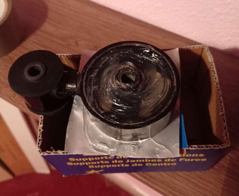

tooSavvy Posted February 16, 2023 Author Posted February 16, 2023 Hmmm..... If my porksword was as limp as the rubber in this Dogbone 😟 Ah haa.... Fully injected with construction glue!! 😋😋 ..... Give it 7 days ⌚ 🚙💨 privatewire 1
