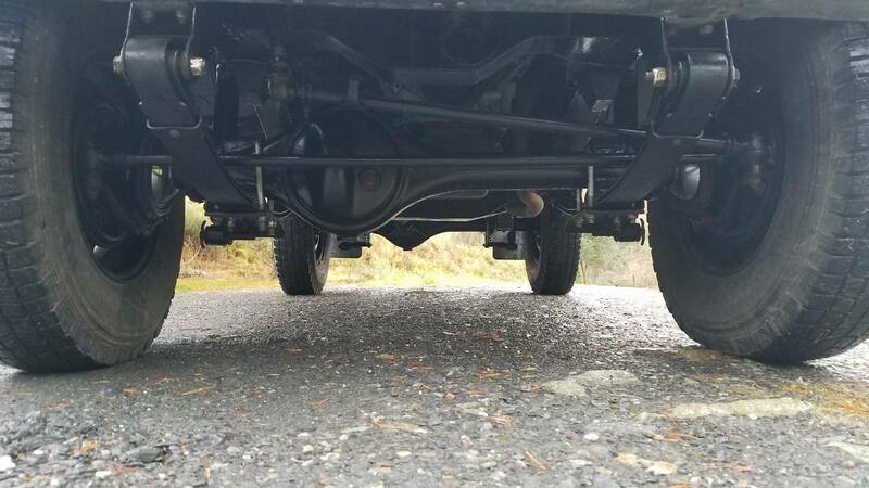

What a muppet. I've made a start on fitting the new parabolic springs today, and it was a nice easy job. All fasteners (bar one) came out nicely, as it's only been together for a year.
But the job would have gone a lot more quickly if I could tell my nearside from my offside! Fortunately I realised before doing the rear springs, but as they are handed I had to swap the fronts over :oops:
At least one end is done now, just need to lower it onto its wheels and tighten everything up.
A colleague who knows I like Land Rovers has shown me pics of a S3 Lightweight that a mate of his wants to sell. He parked it up two years ago. I don't need it but will have to take a look
All four springs are now on!
The front two bolts on the rear springs both had to be cut off, so I think they weren't removed during the restoration. I'm waiting for replacements to arrive before I can lower it onto its wheels again and try them out.
An unexpected benefit is how much lighter they are - seems obvious now but the old springs weigh a lot more. Can only help matters.
I'm pleased with how solid the chassis is too - no evidence of any rot coming through. Obviously there are some chips from 1500 miles driving, which have started to rust but on the whole it's very good. I've sprayed it with ACF-50 which I've now discovered, so will sit and see how well that protects things.
Looks a lot more airy and spacious back there now, well done!
Are they any lighter than the (effing heavy) regulation springs?
Yeah, that's what I mean - I'd guess maybe half to two thirds the weight. Not sure if it counts as unsprung or sprung weight though!
I hope it doesn't lift it too much. I removed the rear wheels with them just on the ground, and now I'm going to have to lift the axle by a couple of inches just to get the wheels on, I'm expecting them to sag more readily though once weight is applied; that's one of the benefits i.e. having greater extension when unloaded. Properly looking forwards to a drive!
All done now, and it's not noticeably raised.
At first glance they appear standard, just the way I like things.
I didn't get chance to take it for a spin today, but hopefully will rectify that tomorrow. It certainly felt softer in the bounce test!

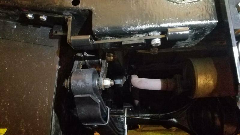

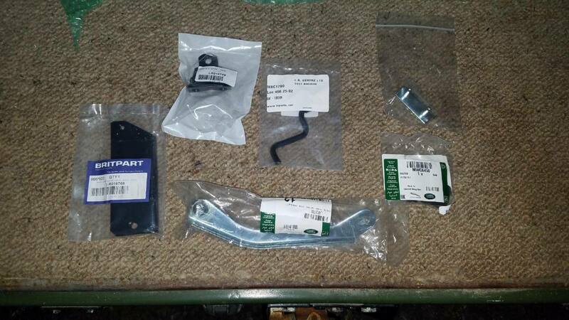

I've now got all the bits I need for the rear door check strap.
I couldn't find a single supplier who had all the bits, so had to shop around and pay three lots of postage sadly.
It was fairly obvious how things went together after a spot of head scratching.
The large plate sits on the inside of the wheel arch to spread the load. I smeared it with Bilt Hamber UB before tightening it down, but I'm not convinced it's spreading the load over enough of an area.

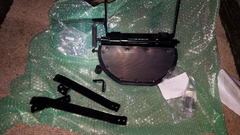

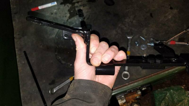

Onto the next thing then, which is the rear step. These are mega expensive to buy new, over £150 which I'm not paying! @Talbothad the bright idea of modifying a much cheaper side step to fit the rear, so that's what I've bought.
First thing to do was hack it up and drill a new 10.5mm hole.
I could then screw it onto a captive nut on the rear crossmember.
All I need to do now is use some of the many extra brackets bent to the correct shape, weld them on to the step, and screw into the existing holes.
We've also used this for Christmas tree shopping ;-)
Looks the part out in the wild!
In the photo below you can see there is a tab on the back of the step which bottoms out against the bracket, by the triple holes.
Once mounted this puts the step at a slight downward sloping angle, making it awkward to use. So I needed to make up some kind of spacer to get the step to sit horizontal. The spacer needed to be around the same thickness as the bracket, and by chance one of the offcuts was already drilled with the same spacing as two of the holes. Even more flukily, the hole diameter was perfect for tapping out to M8, and bolted nicely into position.
I've welded a tab on the rear to stop it twisting, and another angled mount on the left.

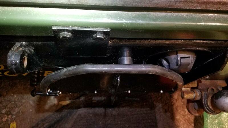

All bolts up using existing holes like so:
There's a rubber stop in the kit which is fastened using a rivnut, again into a standard hole.
And when not in use it hinges away neatly.
Quite a satisfying job, more so than just bolting something on :-) It's not quite the same as an original bracket, but close enough.

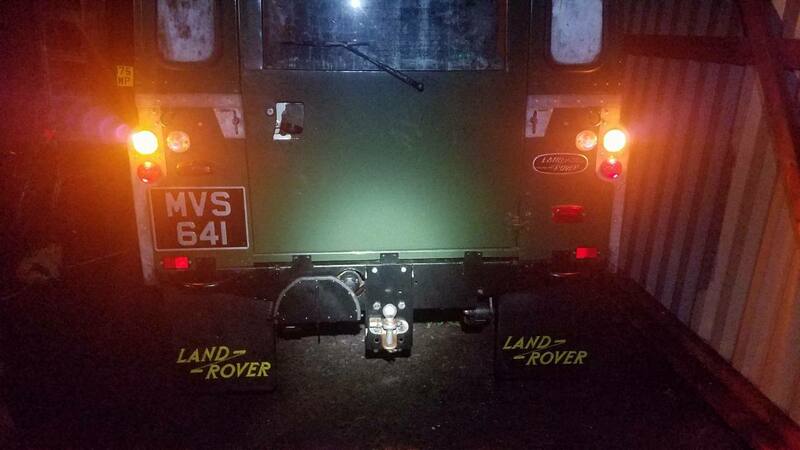

When I bought this, the hazard warning switch was just hanging out of the dashboard.
I had a quick play with it back then, and the switch itself seemed functional, plus I knew the flasher unit was fine as the indicators worked. I drew a blank looking at the Haynes wiring diagram as no details were in there, so I guessed it must be a later add-on. Yet the wiring looked factory, no scotchlocks or dodgy joints here! Puzzling.
Unplugging it knocked out the indicators, so I just tucked it away when I added a voltmeter.
It's always been in the back of my mind, as this is the oldest car in the fleet, so seemed to be tempting fate not having hazard lights! With a bit of wire tracing I discovered that there was an additional flasher relay, just for the hazards. Everything checked out ok wiring wise, so I opened up the relay and it was a mess of rust. Swapped it with a spare I had, and...
Success! So I mounted the switch on the dash, out of the way of the gear lever, and another job ticked off the list.

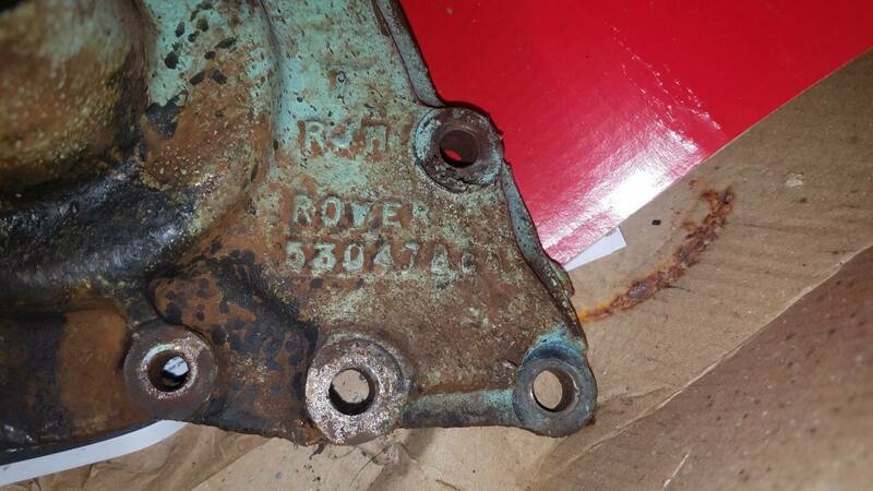

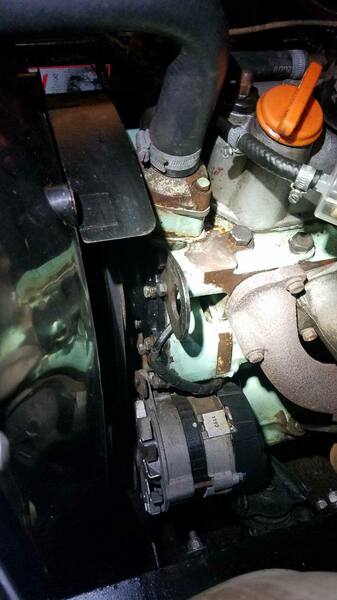

Can't remember whether I mentioned that the water pump had a small leak. They are available for as little as £15, but having worked in their manufacture previously I was wary of that price. The Britpart Proflow pump turned out to be made by Mark Water Pumps (formally Quinton Hazell, who I used to work for) so I had a word with my old boss! He's also a Series 3 owner, so I asked him whether he'd be happy fitting one to his. I half hoped I'd get a freebie out of him, but no joy although he was confident in their quality, and I got a good deal.
The old pump looked as though it could be the 40 year old original:
New pump appeared well made, so was quickly bolted into place using my new Christmas toy of a cordless ratchet.
