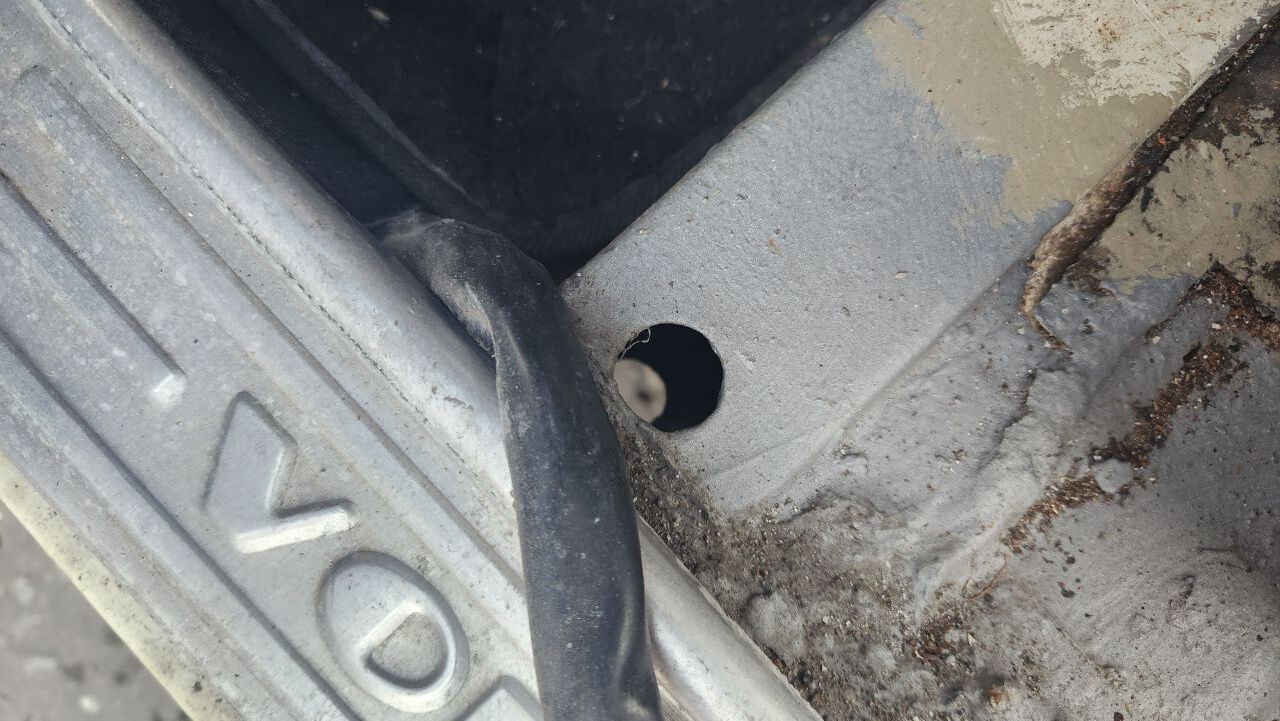

I've managed to solve the smells almost entirely by dropping the exhaust and rebuilding it with assembly paste. I also noticed quite a few floor grommets had buggered off over the last couple of years.
Oops, that definitely doesn't help.
Sealing those up also cut down a bit of road noise as you'd expect.
