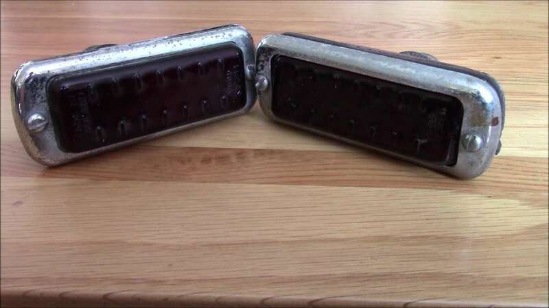

Sorting out the rear lights on the Lanchester, the first time.
Before we get into this one, I have since found the problem and I made some mistakes in the wiring at this point that I didn't know were mistakes.  It has been a learning journey.  Right, let's get into this one then.  How hard can brake lights really be?
We begin with two fairly grubby light units, both complete.  These Lucas 464A lenses probably aren't correct since our car has aftermarket reflectors on the boot lid and these have reflectors that are integral to the lenses themselves.
The chromed bezel and lens are loose on these units, the two chromed screws hold them in by screwing through them and into the aluminium pod on the rear wings.  This is why you have to be careful removing them so that you don't drop the glass lens and break it... put a pin in that particular statement.  Once you've removed bezel and lens there's a rubber seal (which you can still get new) beneath that seals everything up quite well.
With all that removed you get a look at the inside.  Not bad all things considered.  This is the original white finish too, there was some debate about keeping it this original white or repainting in a different colour, something I experimented with and we'll see the results of a little later in this write up.
On the back is a rubber boot (also still available new) that covers the connectors and wiring.  These catch a lot of dirt from the inner arch so are quite important otherwise your connectors will just get full of mud and water and you'll have a bad time.

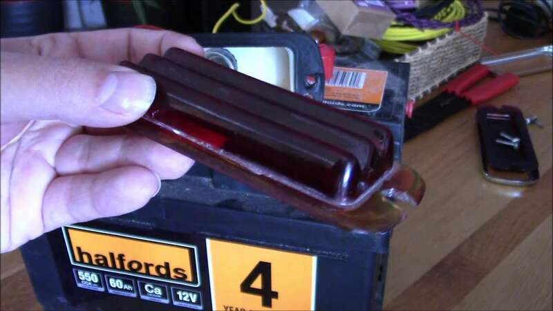

The other light unit has had a harder life, this one was on the side with the damaged rear arch so it's probably a replacement, or a repair of a damaged original.  What you can see here is the little earth loop next to the main socket, it's important not to have paint inside this bit.  You can also see the reflector is just a mess of black and red primer which is going to need refreshing in something more reflective if this light is to be any use.
They break down really easily.  A surprising amount of this is still available new, you can get all the rubber bits, the chrome screws and even the chromed bezels.  The glass lenses are difficult to find and when you do they tend to be expensive, and the main reflector/body can also be a bit harder to find.  The benefit of wide parts sharing on this one, so many cars used these light units there's still plenty of supply, just a shame they often get the classic car tax by unscrupulous sellers sticking prestige brand names on the listings to bump up the price.
Some time in the ultrasonic cleaner and a bit of Autosol and hand polishing got the units looking much better than I expected.  The rubber boots aren't in the best shape and will need replacing eventually but they'll do for now.

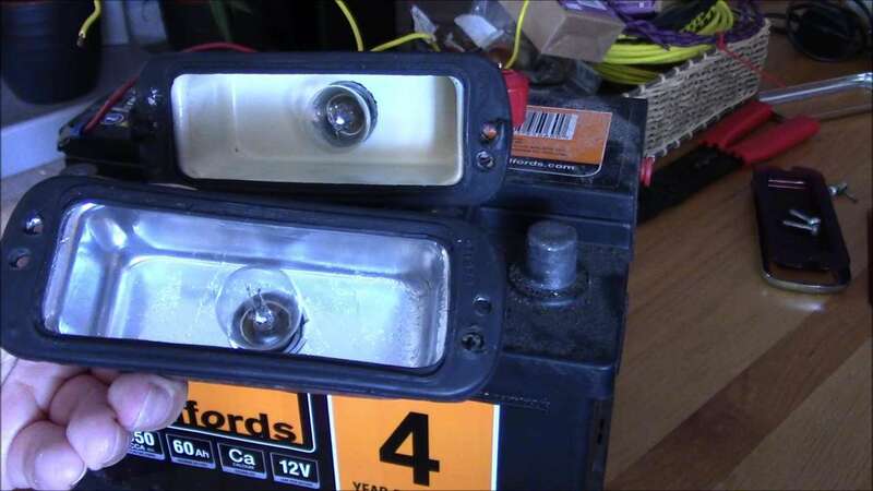

I'll be making use of a Lucas 464 lens (these have no markings on them, but that's what they are) which the car came with one of.  I got a replacement to match this happily which is the style Pat and I prefer and since we have the reflectors already on the boot lid we can run these no bother.
We'll test the unit with the original white paint first.  Running and then brake light shown here.
That at least shows the light unit does work so hopefully the problem isn't in that.  Next, let's see how the chrome painted light unit compares.  I was careful to mask off the bulb holder portion when I painted this.
In person, the chrome reflector offers a much brighter and wider spread of light than the original white.  Photos and video don't really show it as well as I'd like  That means we decided to go with the chrome, just like we did with the instrument panel, and we now know the light units work properly.  The back of the units were painted in purple enamel since that's all I had to hand and they're totally hidden from view so the colour doesn't really matter.  I made sure to mask off the electrical connectors and the inside of the earth point before spraying so that we'd be assured of the best possible connections.
Everything reassembled, and the moment of truth.  Will they work?

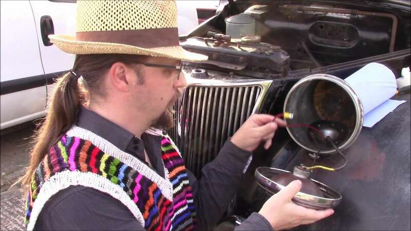

Yes!  And also no.  Whenever the lights are turned from sidelight to main, the rear lights (but not the number plate light) turn off.  Now, at the time of writing this I do know what the problem is and I believe I've resolved it as I've been unable to replicate this issue since making the correction.  As usual, it was a simple problem that was very obvious once found.  Many of my problems were related to not knowing what I'm doing and being confused by the info I did have available.  No fault of anyone trying to help with this one, I can be a little hard of learning at times.  The headlight wiring would also be corrected and improved later and those too are working as they ought now.
The most frustrating part of this chapter was definitely that when the headlights did this...
...the rear lights did this.

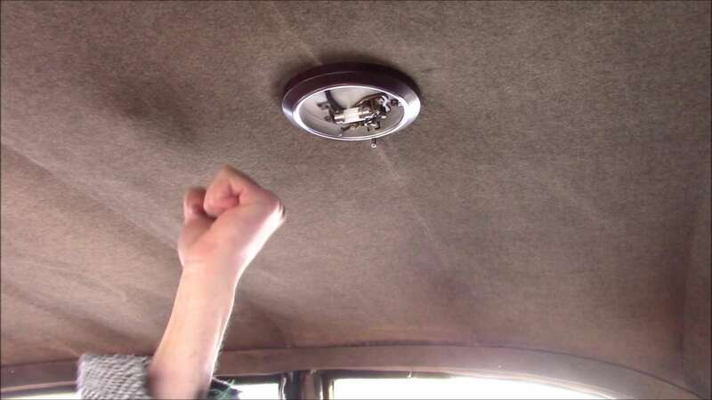

The interior light on the Lanchester didn't work when the car arrived.  Since putting the new wiring in it seemed like it ought to be a simple matter of connecting it, sticking a bulb in, and then it would work.  This was not to be the case.  Happily, things are a bit simpler than they might be on this because the Lanchester only has a switch on the unit itself to operate it, there are no additional door switches to worry about here, so there are a lot less things to go wrong and investigate.  Before we do anything it needs cleaning so we can assess what we're dealing with.  The unit is held by three screws to a piece of plywood fixed to the roof frame behind the headlining.  You'll need to remove the white lens to get to the them.

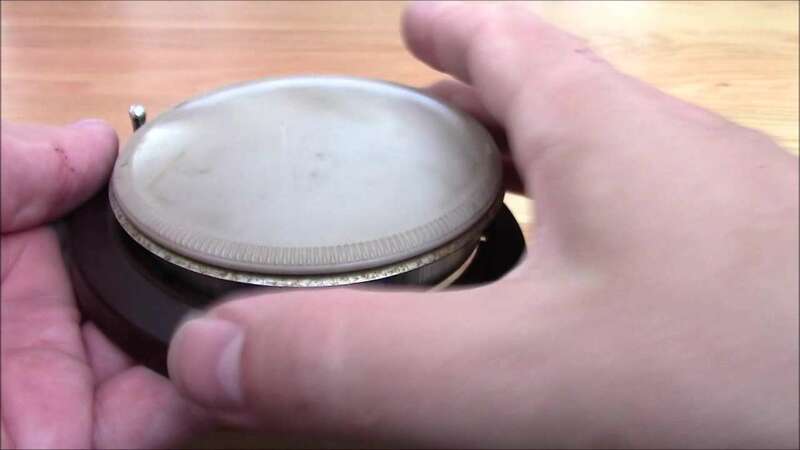

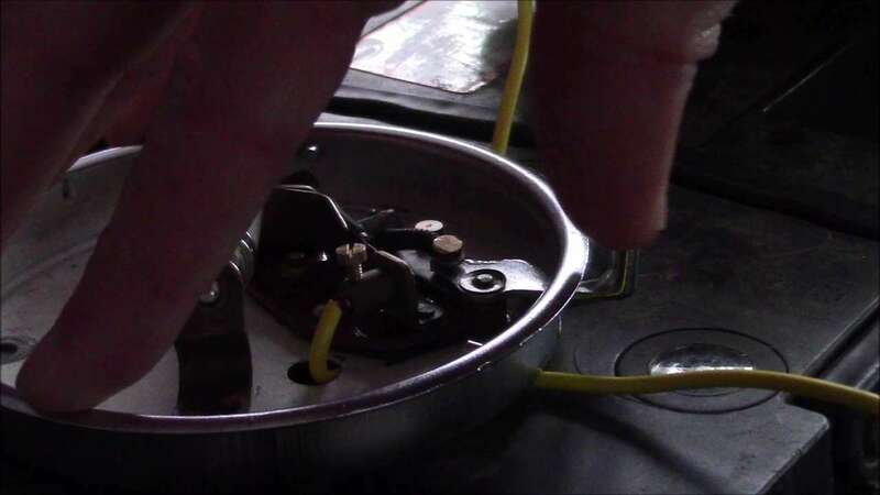

Once it's off the car, you can lift the unit out of the bakelite trim which is just a loose fit, there are no fixings or locking mechanisms on this.
The lens locks to the central unit by means of a bayonet fitting. Simply press very lightly and twist and it comes undone easily.
It's a complicated looking mechanical switch and a simple festoon bulb holder inside.  There is some signs of corrosion in here which can't be helping matters.  I opted not to dismantle the switch or remove it from the housing, there didn't seem to be any benefit to doing that.
Taken apart enough to clean.
I made use of my ultrasonic cleaner, soapy water, and some Autosol metal polish.  Nothing aggressive was required, it all cleaned up very easily.
On testing, it seemed to be a little intermittent in function.  After some fiddling I could get the bulb to illuminate but the unit wanted to rest in the off state.  This is not a bad thing entirely, it means it's likely to be safer when in the car and less likely to be a battery drain or fire hazard as a result.  It is, however, annoying that I can't get it to function reliably.  If you touch the switch and apply a little pressure it works.
However, as soon as that pressure is released, the connection is broken whatever the position of the switch.  The problem was the main rivet on the switch itself.  I did my best with the tools to hand to try and peen it over and tighten it a little but I need more suitable tools and/or a new rivet putting in to tighten this up.  It's probably just several decades of use that has made the rivet a little loose.
We got it working pretty reliably after some tweaking and felt comfortable fitting it in the car to see if it would work in situ.  It did!
Then it didn't.
Then we figured out where the switch needed to be exactly for it to work.  You sort of turn it on and then turn the switch off a little bit but without engaging the off position and there's just enough tension in the mechanism to overcome the loose rivet and maintain the connection.  One day, we'll replace that rivet and it will work properly.  For now, it works well enough.

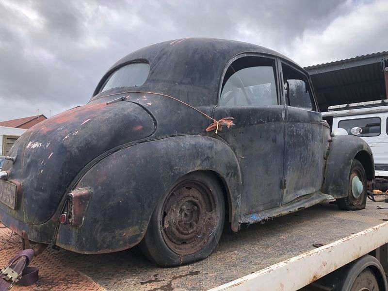

Donor is arriving Saturday morning.  That's perfect because I have nothing planned this weekend, so I guess now I do.
Not yet!  Delivery person is aiming for a 10am delivery and is driving about 200 miles so I'm expecting that delivery time to be more of an estimate.  They must be a morning person.

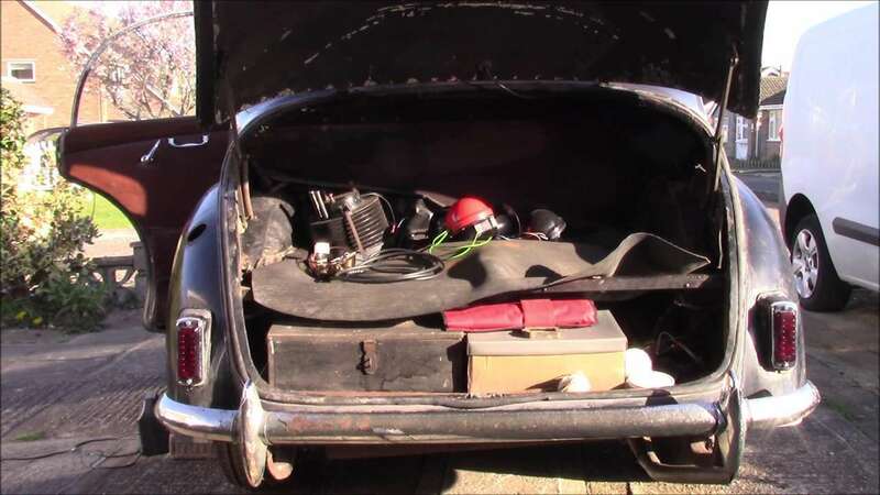

I have arrived.
Somehow I now have to resist the urge to rummage until Pat gets home after work this afternoon.  I've already found some treasures and seen enough of the overall condition to not feel at all bad about breakign this one for parts.  The Maestro did its best trying to tug it further back up the drive but the new resident has decided where it has landed is where it's comfortable.
Excellent. It was a no brainer really,the chance of a cheap spares car wasn't going to turn up everyday.
It will make your lives so much easier and hopefully speed things along.
After some time, Pat and I have cleared out the interior, the boxes and boxes of stuff, and found some actual treasure. Also a lot of rat poop. Every piece of plywood is riddled with woodworm to the degree that some of the car has self-disassembled. The rot to the steel is pretty extensive in places.
Perhaps the most exciting find in the whole car has been a NOS looking front engine mount which is something our car needs and isn't available to buy.
The only disappointment thus far has been discovering the seats are red, not brown. We've salvaged the material anyway because antique leather is hard to get for repairs, especially in less usual colours. Headlining on this car used to be green, which was a surprise, but has faded to the same sort of brown as our once-salmon-ish headlining so that's going to help with the last of the interior repairs I need to do.
Haven't even started on the body of the car, it's taken us this long just to clear it out and we still haven't gone through all the boxes yet so there's bound to be more treasure hiding. This was a shockingly good purchase and should pay for itself in the parts we use alone.
