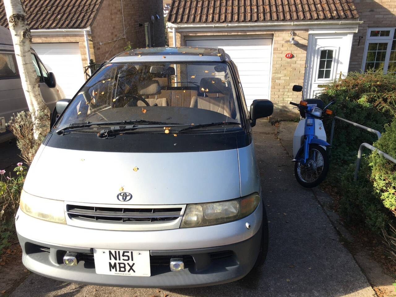

The Lucida is already proving a fun family bus, kids absolutely love it, Mrs T is keen, even my usually sulky teenage daughter has described it as "the best car you've ever bought" so realistically it's looking like the Berlingo's days might be numbered. Toyota's MOT is fairly soon though so I'll probably clear that hurdle before doing anything rash. Personally I'm in love with the styling of it, and especially JDMish details like the rear window tints which are a silvery bronzy colour. Driving wise it's wafty and thrummy, goes well but a bit sluggish and leaden in town, especially with the hills here. On the open road it flies along.
I'm thinking that if anything the best bet for a third car would be "nippy, cheap to run family town runabout". The irony is that the Berlingo almost fits that bill perfectly, in fact the only thing counting against it is a lack of narrowness and quirks like door handles that don't work reliably from the inside. Ideally a small japanese motor to complete the C90, Lucida, +? trilogy. Yaris maybe... 3 cylinders would be fun.

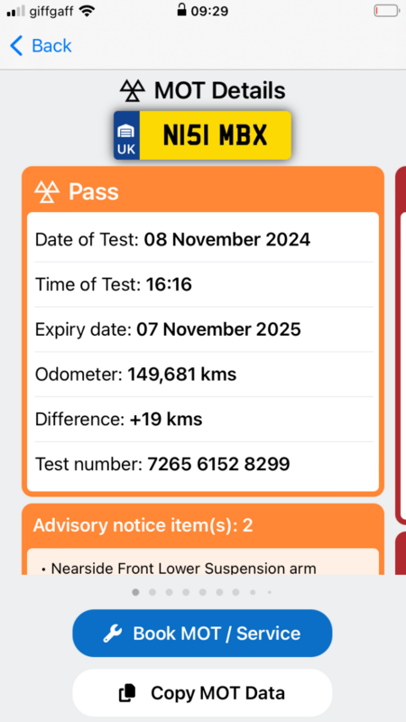

Seems we have a pass as of Friday! Haven’t chatted to garage yet to find out what the bill is or how they solved the oil leak but obviously I’m chuffed… hopefully pick up tomorrow.
This news means I might be looking for a new home for the Berlingo. I did 300 miles in it yesterday, great little van!

Picked it up Monday, been enjoying driving it, it's a great family bus. Mechanic reckoned very sound underneath but worth cleaning up and painting suspension arms.
What he initially thought was a rusty intercooler pipe turned out to be an ATF one, it had leaked loads which explains why the gearbox was slipping a bit on hill starts, and not changing as readily as might have been expected. The rusty bits have been cut out and replaced with a length of rubber hose, held in place with jubilee clips. Seems to be OK but I guess I'll keep an eye on it.
Bill came to £300, it also had a (fairly expensive) shock absorber and ARB dust cover to get it through, so pretty reasonable really. Did wonder whether it was worth changing the other shock absorber. Mechanic said not to bother. Maybe I'll get him to do it at some point soon ish.

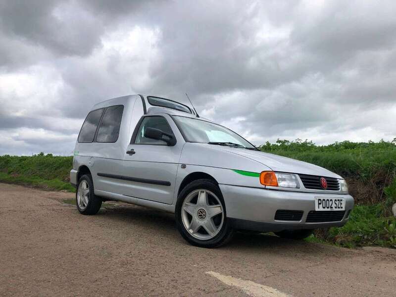

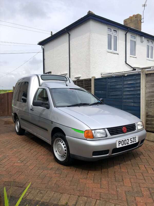

Caddy sorted with new ECU, filters, tinted glass, rounded corners cleaned up. Paint all one colour, VR6 seats, polished paint, SEAT alloys and new tyres fitted with spacers (drove worse than on standard wheels but looked nice) steels painted freshly, valeted, used 7 months with great pleasure after ECU replacement.
Impulsively sold for £1200 to first of 4 buyers inside an hour, plus a knob pushing me with a £1500 offer to gazump first buyer.
VW obsessive made it into a mini camper, so now living a great life with added scene tax in Essex.
On alloys
And as sold.

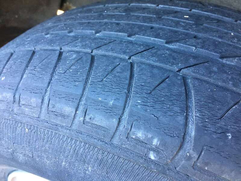

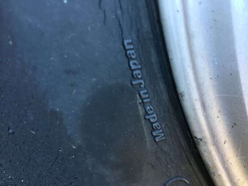

Today I got a new LEAO tyre on the rear O/S of the Lucida to replace the ancient Japanese Bridgestone. Also had the tracking done. It now has 4 mismatched budgets, but at least they're all in decent condition.
Even though it's an budget cheapie the tyre wasn't cheap at £68.76. It's an unusual size so everything is expensive. Luckily the guys at the tyre fitting place are all fans of classic JDM vehicles (one runs a 90s Land Cruiser, the other has a Honda Stepwagon). They liked the car and did the tracking for free even though they had a job freeing up a siezed nut.
Tyres are important. It felt much better on the way home. :)

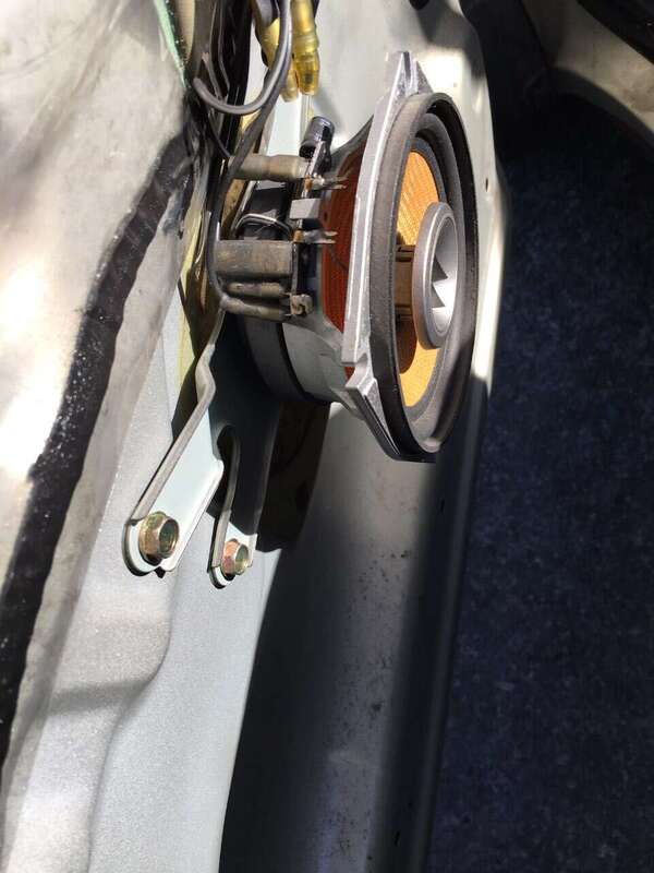

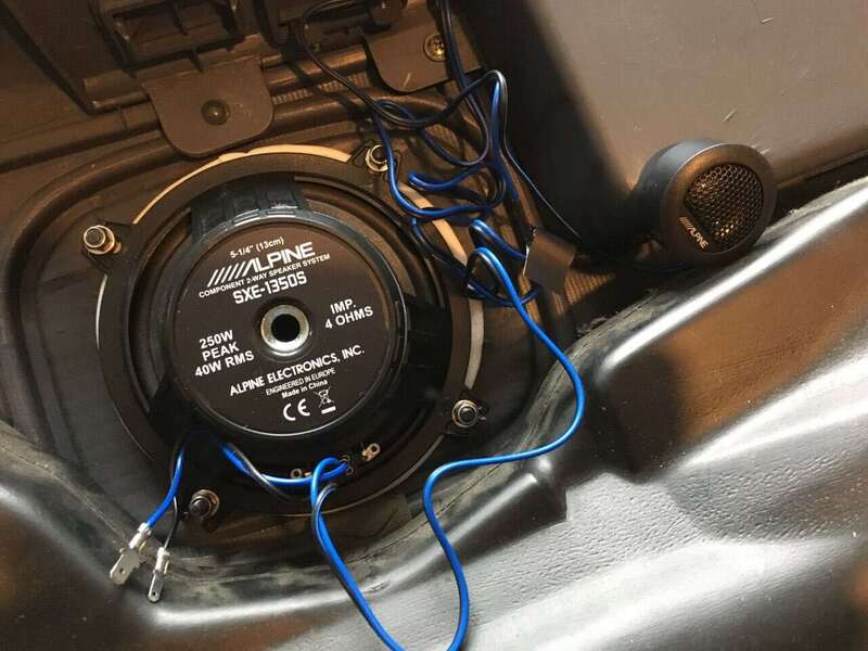

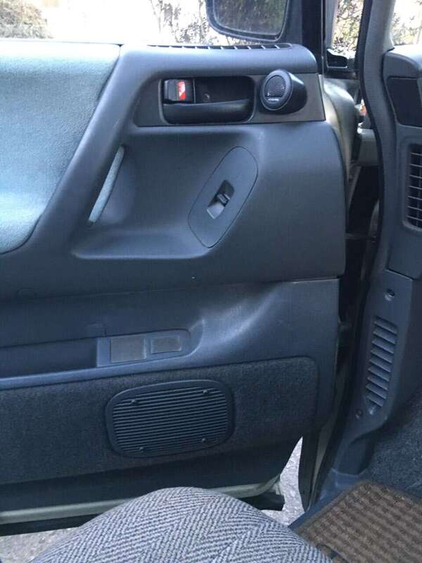

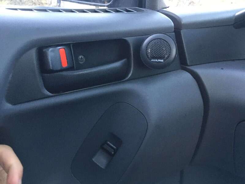

Audio improvements today with the help of Junior Toastsmith. As per above the original speakers were bolted to the door, and previous owner replacements weren't flush to the door panel so were flapping about with very little output.
Plan A was to cut bigger holes and fit 6x9s but after a better look I realised there wasn't quite space for them. Not sure whether to return them or try to fit them in the back now... Anyway I bought some Alpine components which are a perfect fit and allowed me to make use of the holes from some previously fitted but now defunct aftermarket tweeters.
To properly mount the replacement midbass drivers I had to drill some holes lin the door panels and use nuts and bolts but I'm quite pleased with how neat it looks.
Sounds great, a definite improvement even though I still need to do the other side. I'm also really happy with the garish pink and green colour combination that we selected for the already overly bling Pioneer head unit.

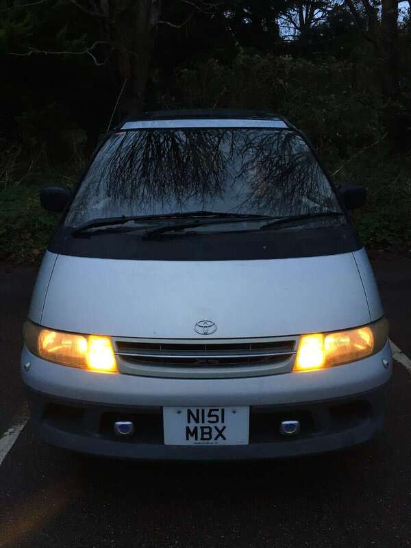

The integral fog lights are yellow IRL. Lower aftermarket ones don’t seem to be wired up. Will add to the to-do list.
Polished the headlights. See before and after. Used Brasso and a rag. Last time I used Brasso and a rag (on the CR-V) they had dulled within the year. This time I put a coat of wax on them after, we'll see if that helps protect them.
