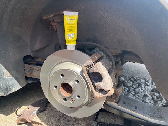

Even a cursory glance through the spokes of the Volvo’s rear wheels suggested the rear discs and pads were utterly fucked. Luckily there were new discs included, so that was this morning’s job:
The whole lot looked like it’d spent plenty of time being driven through the sea, but some serious wire wheel action had it all sorted. The lower caliper slide pin was seized solid, meaning the inner pad was almost on the metal as the caliper had been unable to slide as it should. Bit of heat freed it off, then a tickle with some emery cloth got it back to a serviceable state. Regreased and refitted, all good. Other side was a bit easier, though still quite crusty.
After:
Note the proper brake pad grease - this side was lagged in copper slip so plenty of brake cleaner got rid of it and only a sparing amount of copper slip applied to the lip of the hub where the centre ring of the wheel sits.
