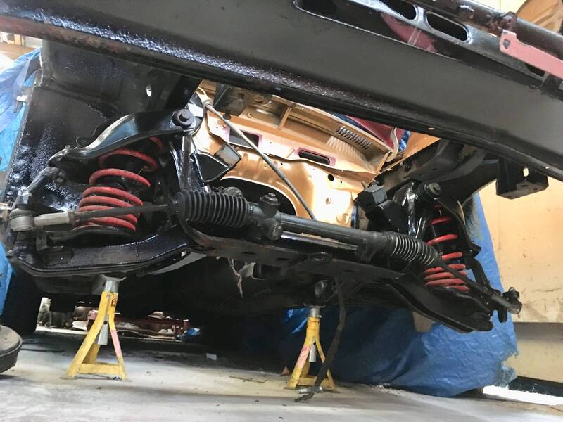

sutty2006 Posted July 20, 2020 Author Posted July 20, 2020 The original front axle on this car had its engine mounts swapped round. Luckily I saved a front axle off a 77 auto I broke a few years back. All the bushes and joints were fine so I cleaned it up and chucked two coats of chassis paint over it. Second hand springs off my other manta used. Reconditioned steering rack I bought about 10 years ago (had to change gaitors as they’d perished in my unit) new track rod ends. Angrydicky, Burnside, juular and 6 others 9
