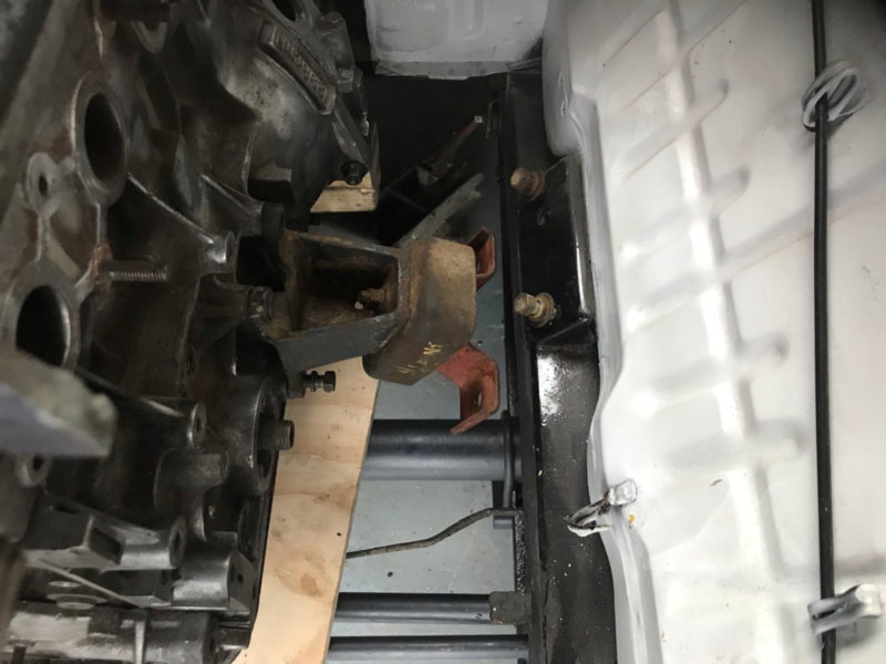

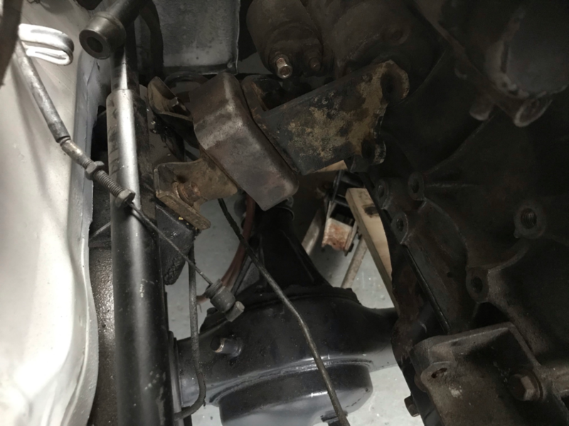

Still have a huge amount of things to do though. Engine and gearbox don’t use the existing mounts, so will have to make them. I’m going to start the inner arches and rear corners in the weekend.

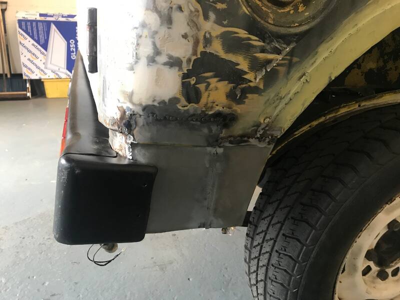

Last outer arch done! I shaped the whole thing with a hammer, some pliers, and a wooden pallet. Was going to start and finish the inner arches this weekend.

I spent my regulator-less time shaping some metal so I could weld it on. I bought this stuff which is a godsend, and also a vice.
E7719B74-F321-4DBA-B50C-863F5E085A4E.thumb.jpeg.f8f444cd93c1f41746d1e518e2c65541.jpeg475B1F29-F198-423B-A246-B32E883638F5.thumb.jpeg.902d962aaef20dd27d85e388fd0d4762.jpeg
Everything fits and I just have to cut a bit out and weld a few curves in and the body is done.

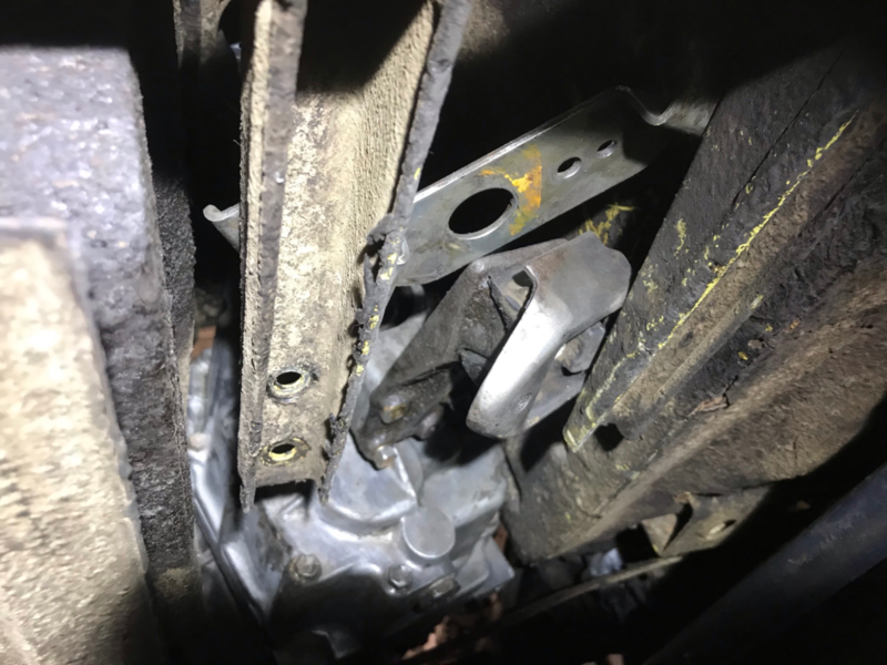

I can’t believe I’ve had this nine months. It sat in the garage for a month, the mot ran out and I decided to ‘prep’ the body, but it’s been tricky and been stressing a bit, so I took the body off. I think the next stage is getting it primered but not sure when that’s going to happen now.
Worst part was cleaning the underside. It was caked in mud and had wayoyl under that. I did it with a wire brush in an angle grinder and it was grim.
the front was raised and the body ‘slid off’ onto wheel castor things

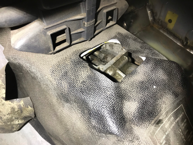

ive cleaned up the chassis and painted it in Upol Raptor paint, which is textured and sets really hard.
The underside, inside and engine bay has also been done with this stuff, it’s amazing.
It has that stipled effect that you see on new car undersides and in the cavitys. I thought four would be enough, but I bought 12 and reckon 8 will cover everything.
I'm not sure how this can ever rust again
