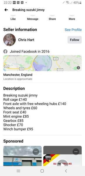

It’s only £40, sure I’ll haggle him down possibly. Anything is better than having the mechanical version of Buddy Rich under the car.
21 hours ago, Andyrew said:
It will fit into yours.

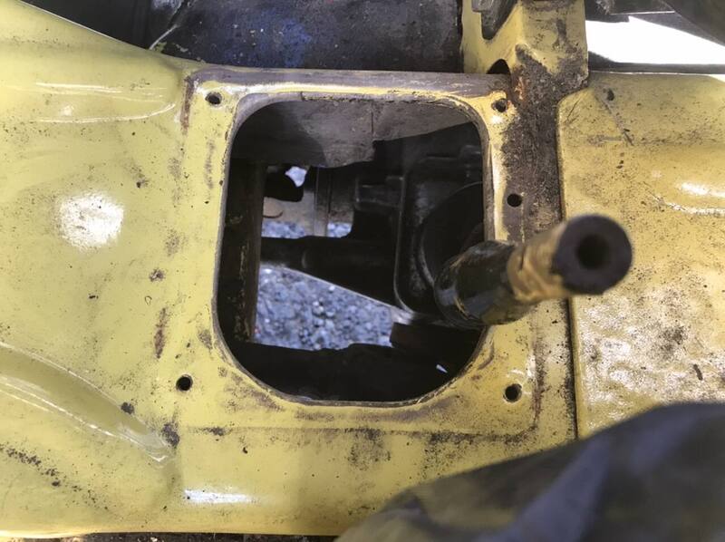

are the mounts different? It’s about 2 inches off and the shifter is already bent against the space in the floor.
Sorry dude.
I glanced  at the pic, noticed the lack of drum and assumed samurai.
That other photo tho. That's a tbox from a jimny
Finding a not shagged axle is pretty rare. If you can fit a tbox you can fix the axle. Cleaning up, regrease and reassemble about 2hours a side. The Swivel leak will be the half shaft oil seal failed, age or caused by up and down movement from worn kingpin bearings.
Swivels on these don't retain grease or oil like a land rover so the balls and the axle and dust seals can be pretty hanging and not cause problems unless wading in mud etc etc.
King pin bearings will probably be worn unless they have been changed. White box cheapo bearings are sub 5 quid each on ebay. Front halfshaft Oil seals are a few quid on eBay

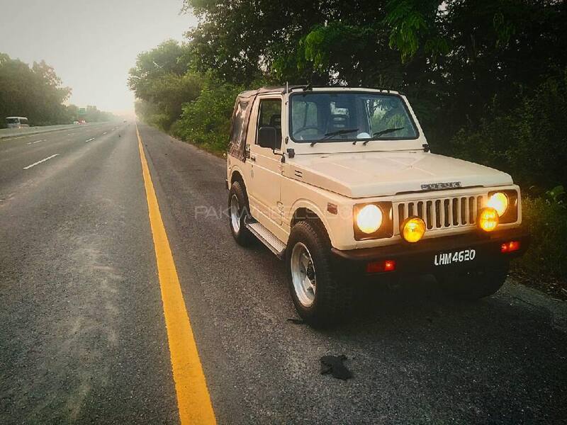

Loving this thread, wish I could find a photo but my very first car was an SJ410 soft top (A343FLX) a really early one that still had drums all round and a metal glove box lid, I still miss it occasionally.

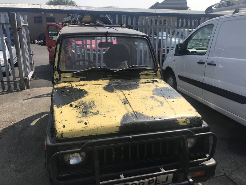

Look what I found under the black whatsit paint job:
Someone painted black spots. The top coat came straight off in minutes with b&q paint stripper. Spots not so much.

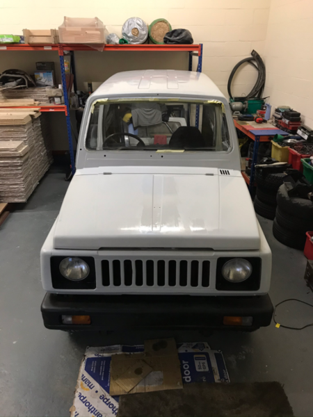

I’ve spent the past couple of weeks welding this up and painting it. Only two bolts snapped on the entire car and I’ve swapped every bolt with new Toyota ones.
Ive pulled the numerous dents out, but there’s a few I’ve missed as there was no access behind and they add character I reckon.
I’ve yet to weld the metal arch attachments on for the plastic arches to clip to, and the roof and the interior is getting painted next. Also bumpers etc. I’m not sure what I’m going to do with them or the bull bars.
Ive put the new engine together but I think I’ll wait a couple of months to put it in.

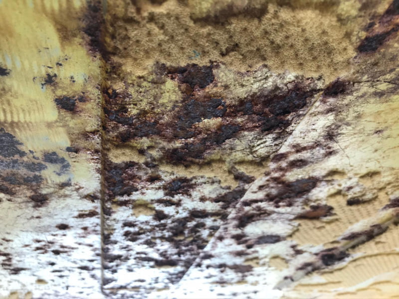

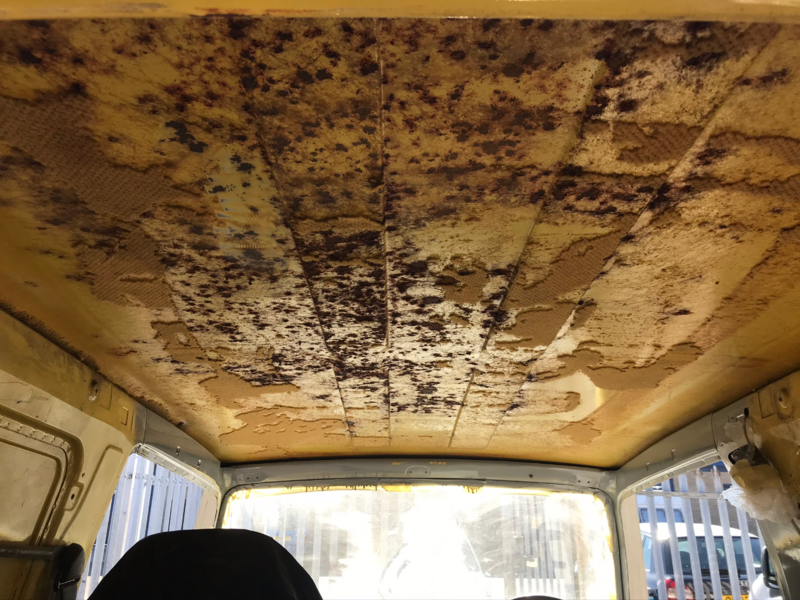

Also, what's behind headlining that's been stuck onto metal for 36 years?
Fortunately, surface rust came off with a flap disc.

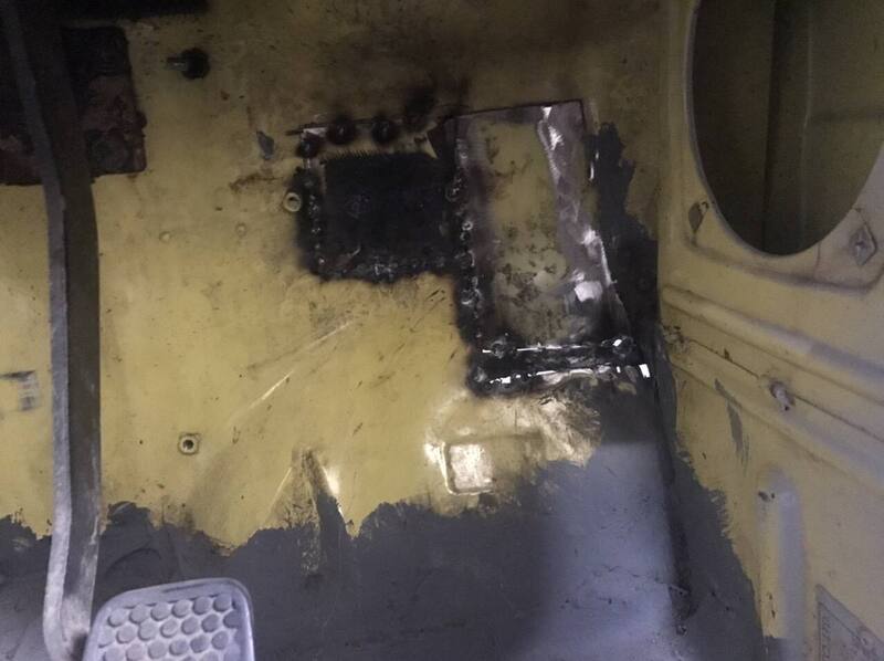

I found a small hole near the accelerator pedal - someone had put a piece of metal over a rust hole and then screwed the pedal base to that.
Look at them wood screws of random lengths.
I’m using the old door for my metal, the metal on this is quite thin, but it’s better than rust.

Been putting this off - with the engine out, I have to start welding the arches so I can spray the bay and then put te other engine in
i spent ages getting new stuff to fit perfectly
And welded some new mounts on
Back not so tidy, but you’ll never see these parts. Other side isn’t so bad so I’ll get cracking with that. Worst is the inner arches to do as there’s a lot of curves.
I put the original wheels on and got new tyres on. I think they had the originals, they were ancient.
